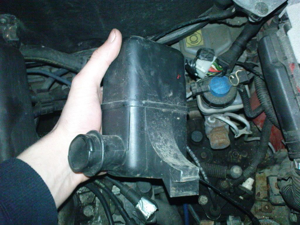

Right found th reason i think im haveing trouble getting first
i take it the 'u' shaped thing is up-side down? as when you put it into first it hit the brake servo or a part of the brake cylinder

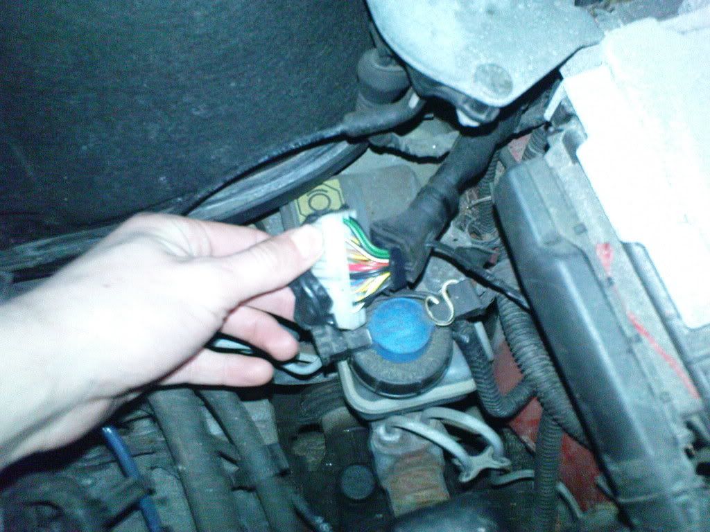

A few other questions
Is this supposed to be connected to anything?
And is this important as i kinda broke the braket holding it by accident the other day :doh:
charcoal canister doesnt look like that.
look down under the front bumper towards the passenger side for that.
IIRC that cinq did have a fiat alarm fitted but IIRC the sounder for that is in the wing
on the 2nd pic,where does that small wire lead to?
yes i no it doesnt but its closest thing to it i could think off ha :) not got anything like that on either of maine i dont think hhhmmm
