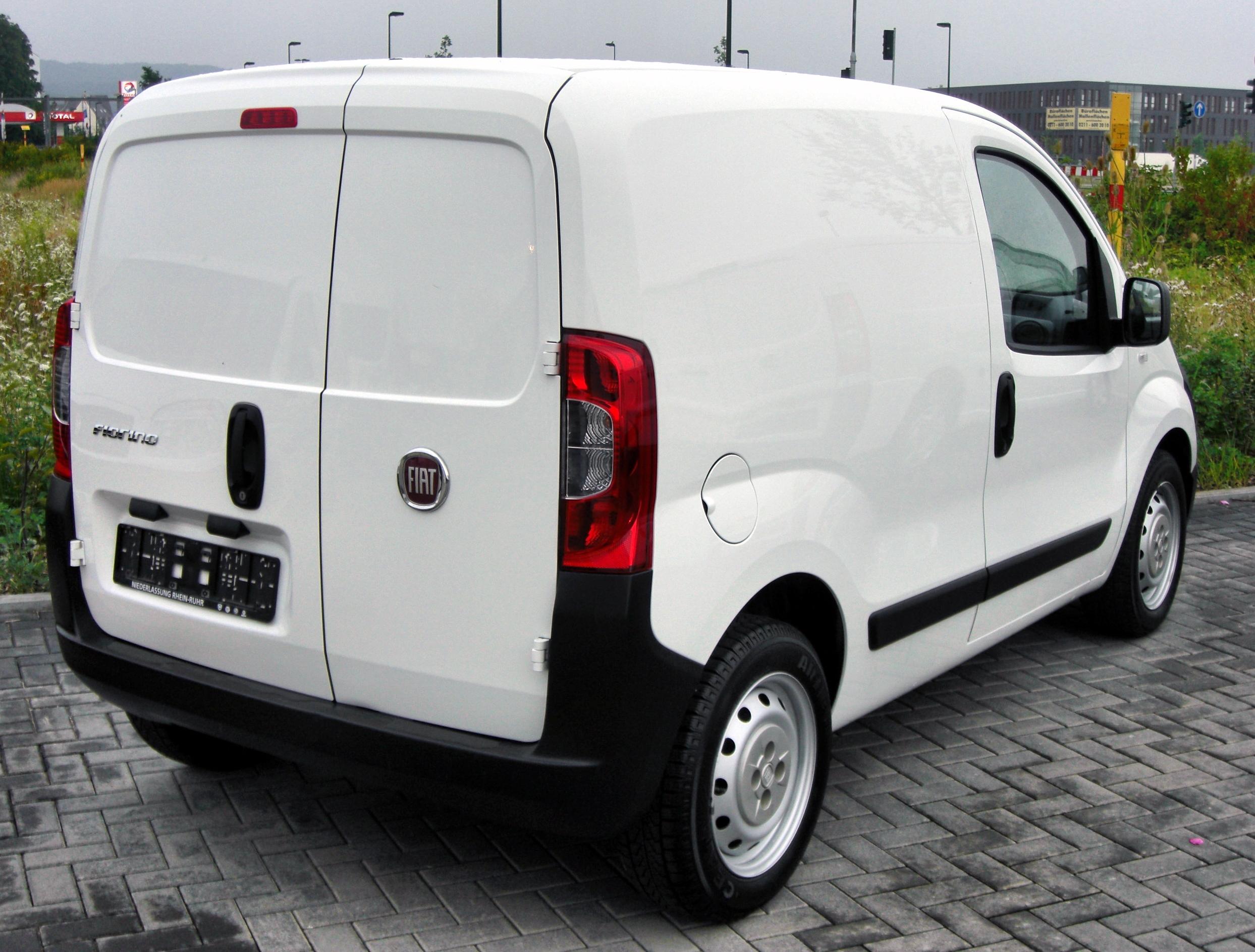

I have a 2013 Fiat Fiorino 1.4 and am hoping to get a bit more horsepower and fun out with some basic upgrades in mind.
1. Air Induction kit
2. Air Intake manifold & throttle body
3. Complete Exhaust system
4. ECU Remapping
I would really appreciate any advice with regards to this.
