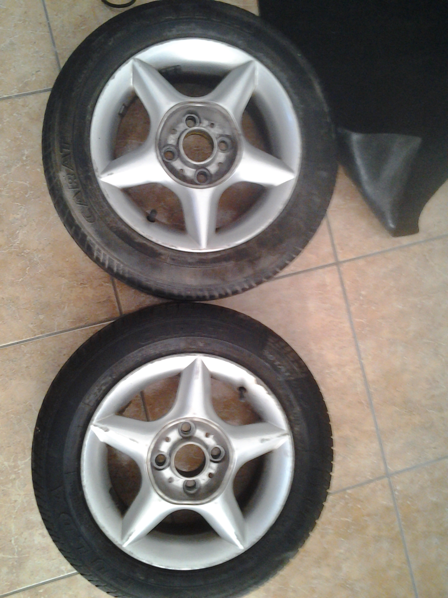

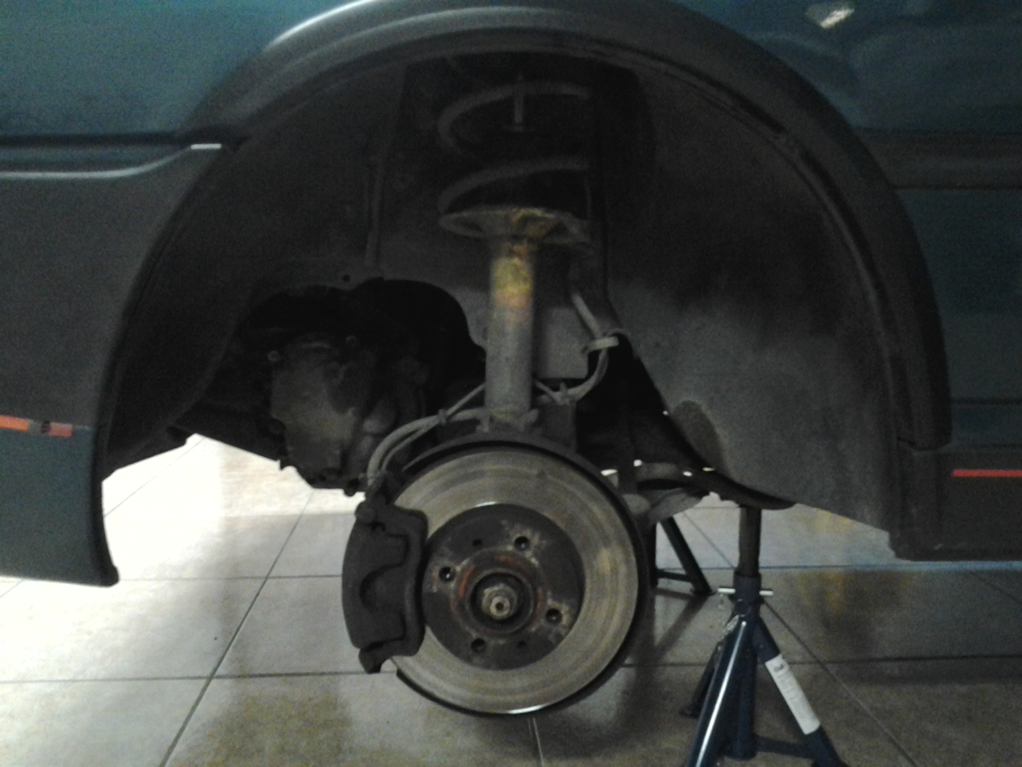

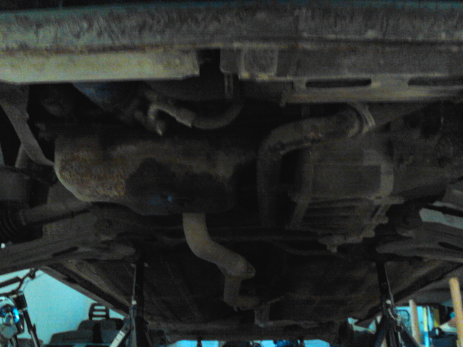

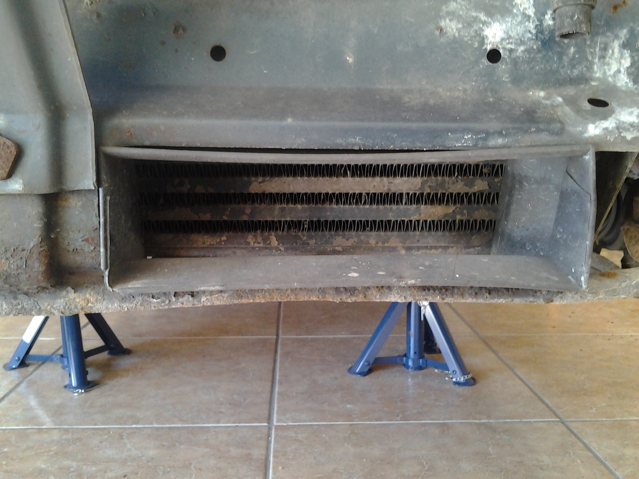

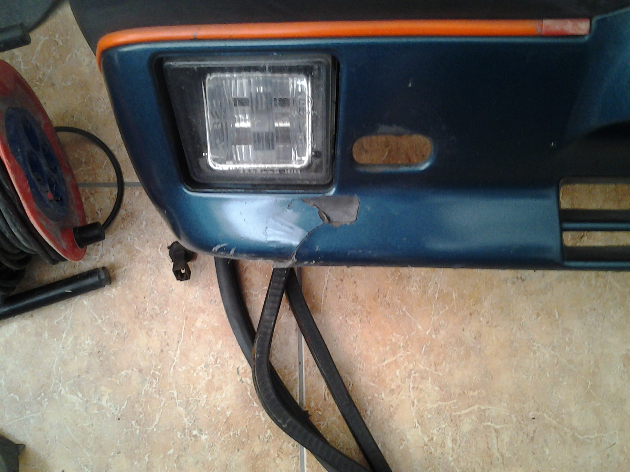

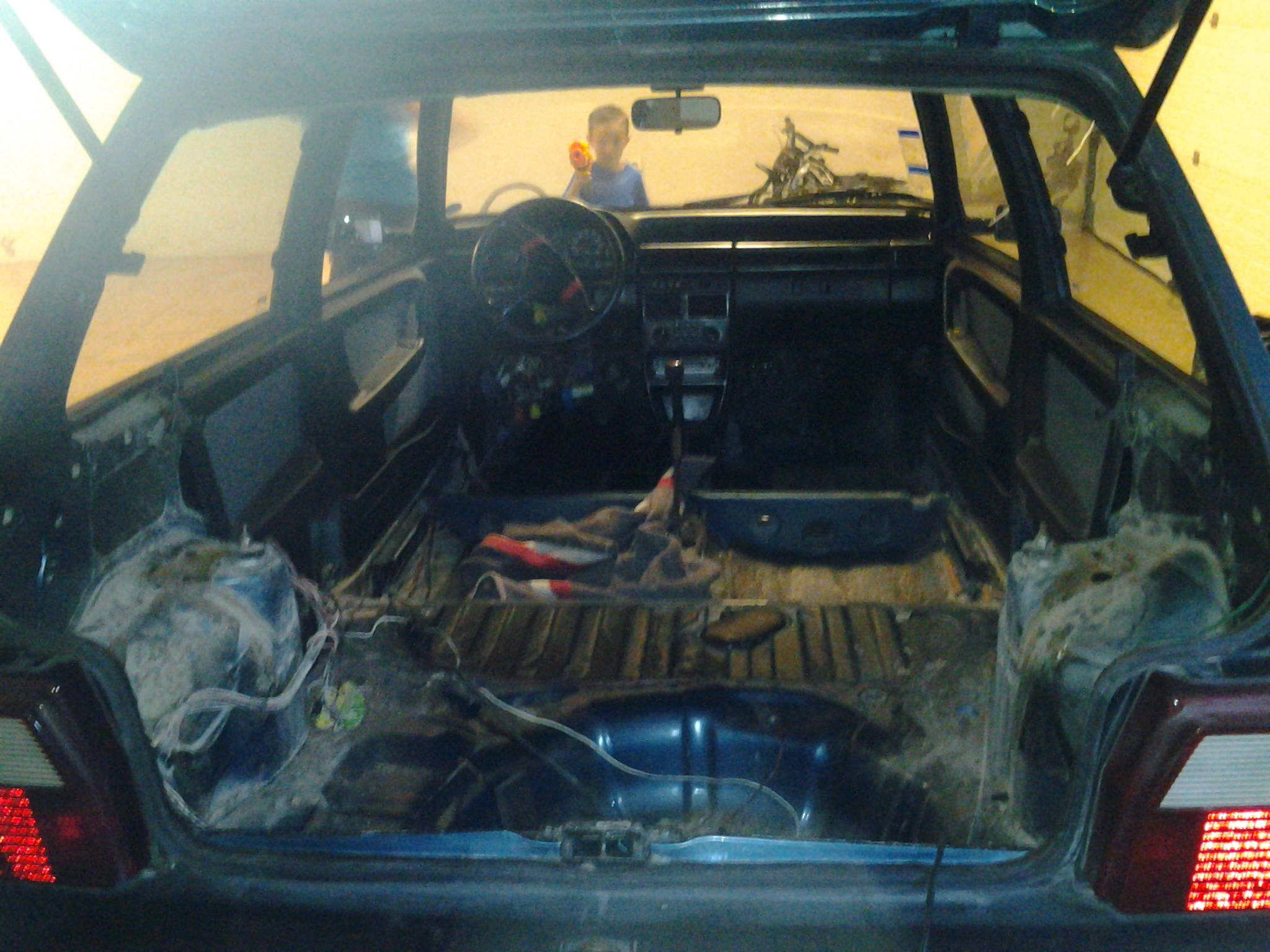

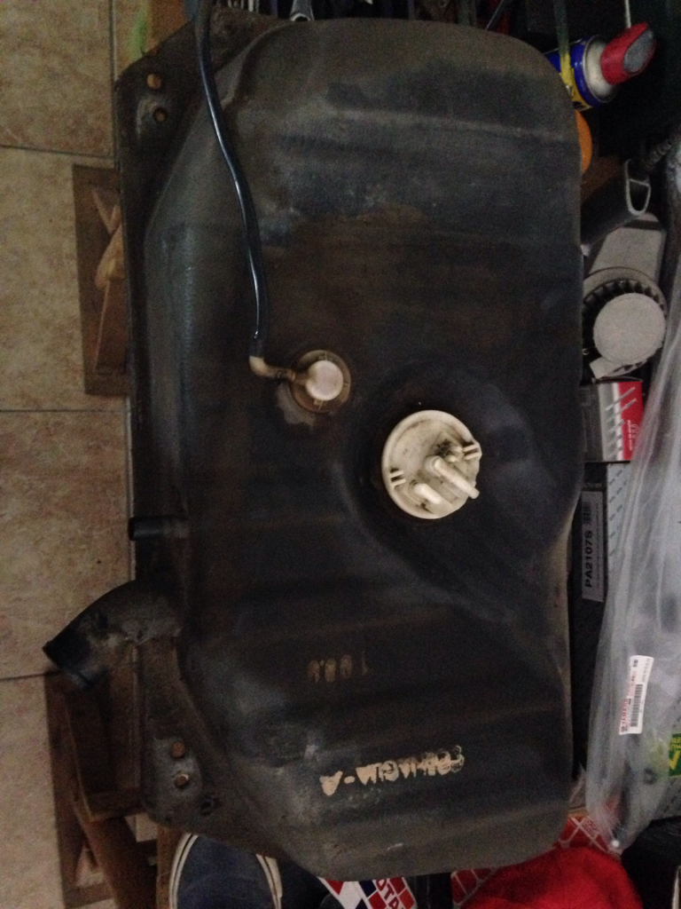

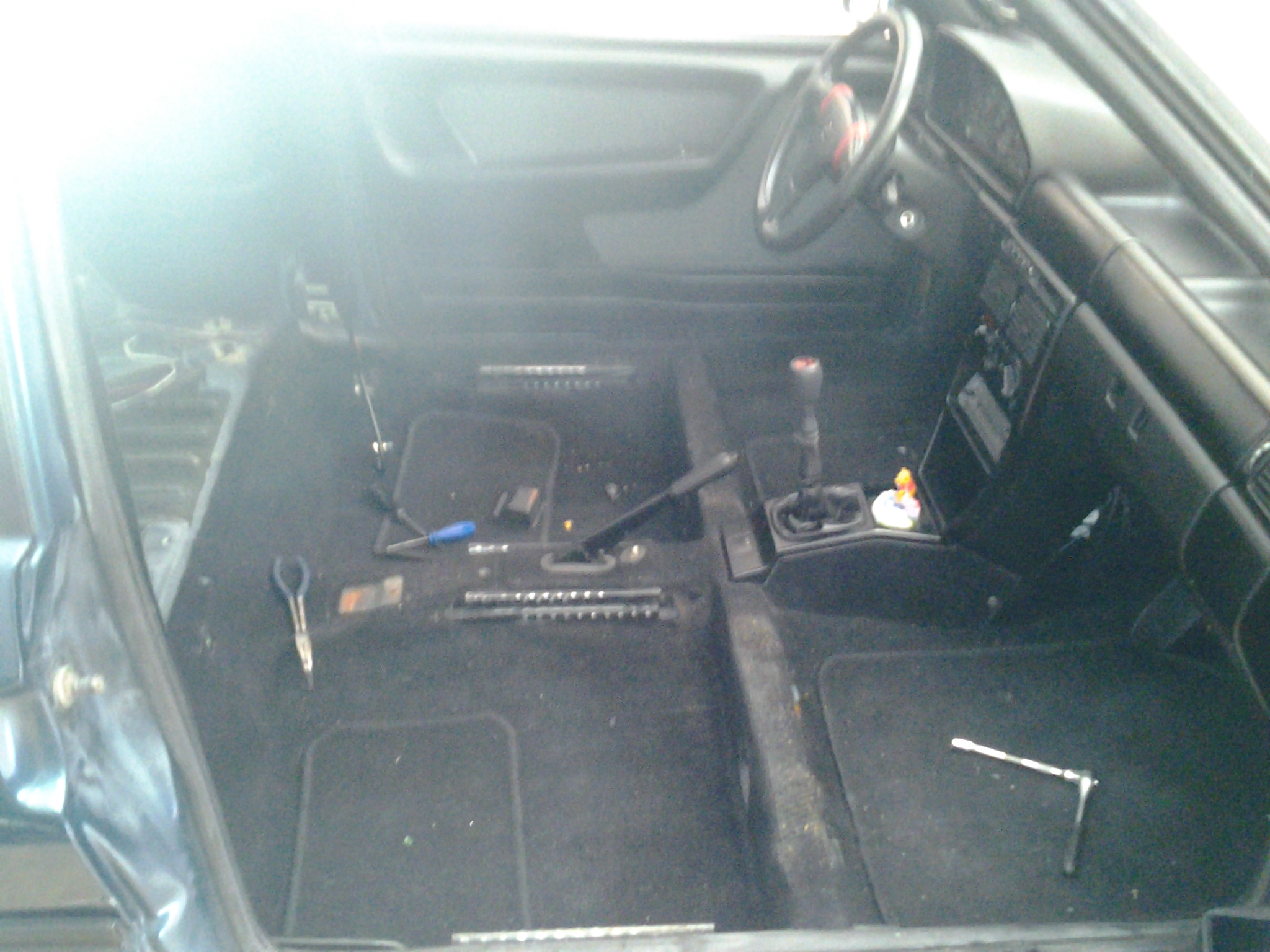

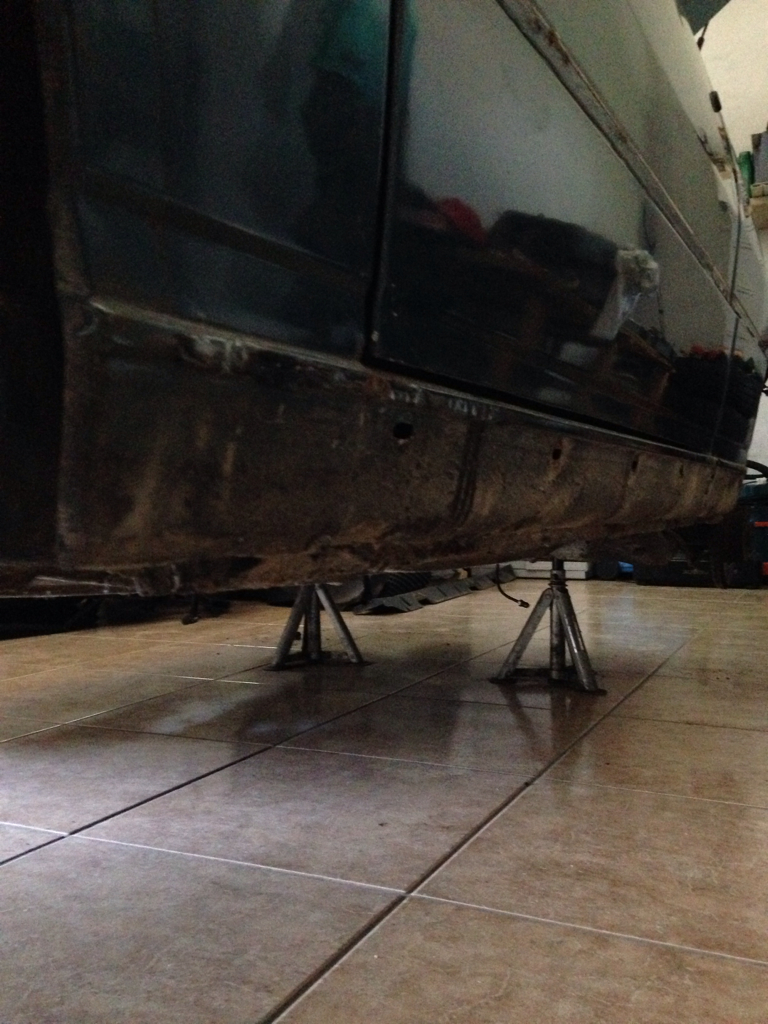

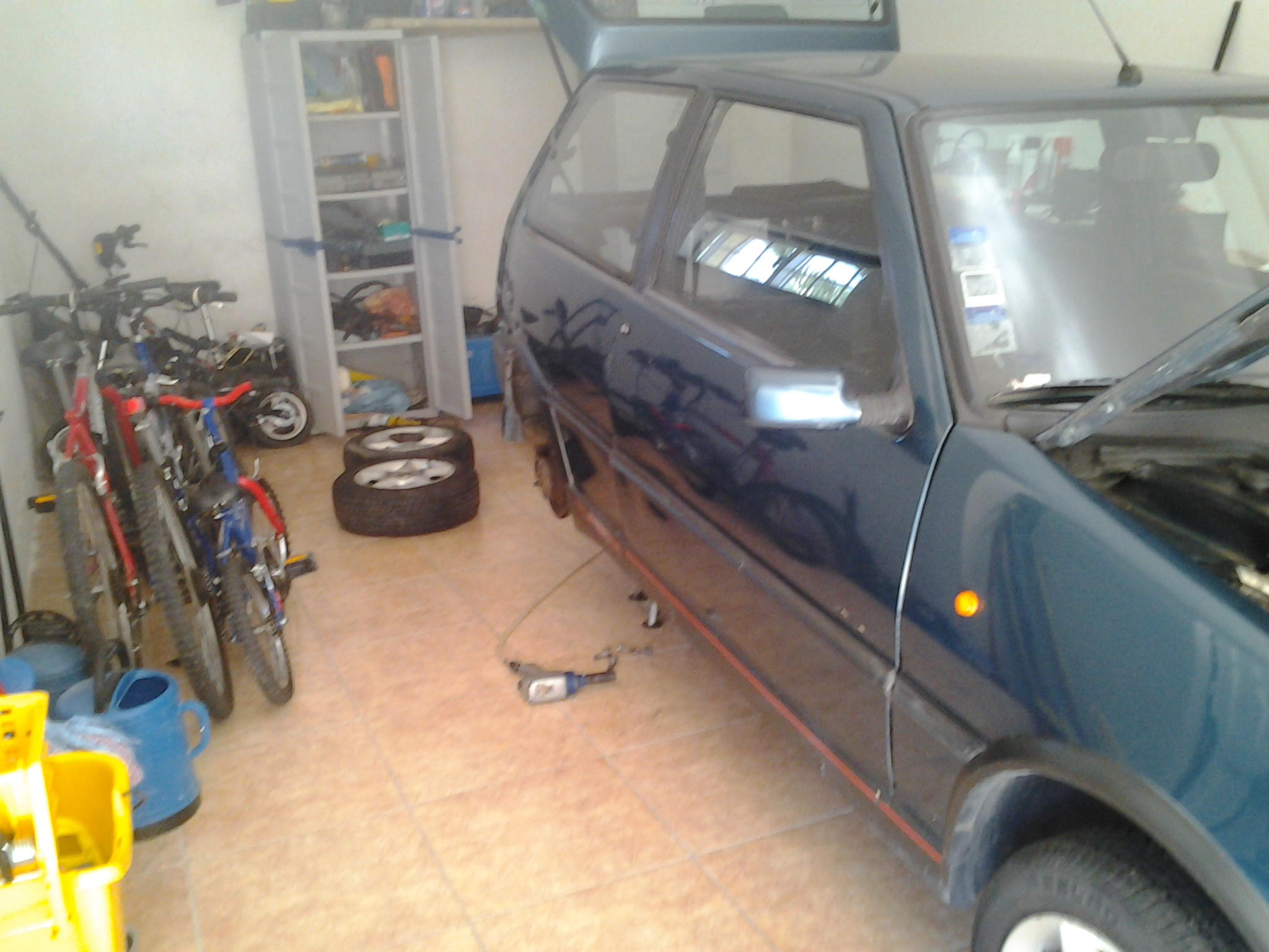

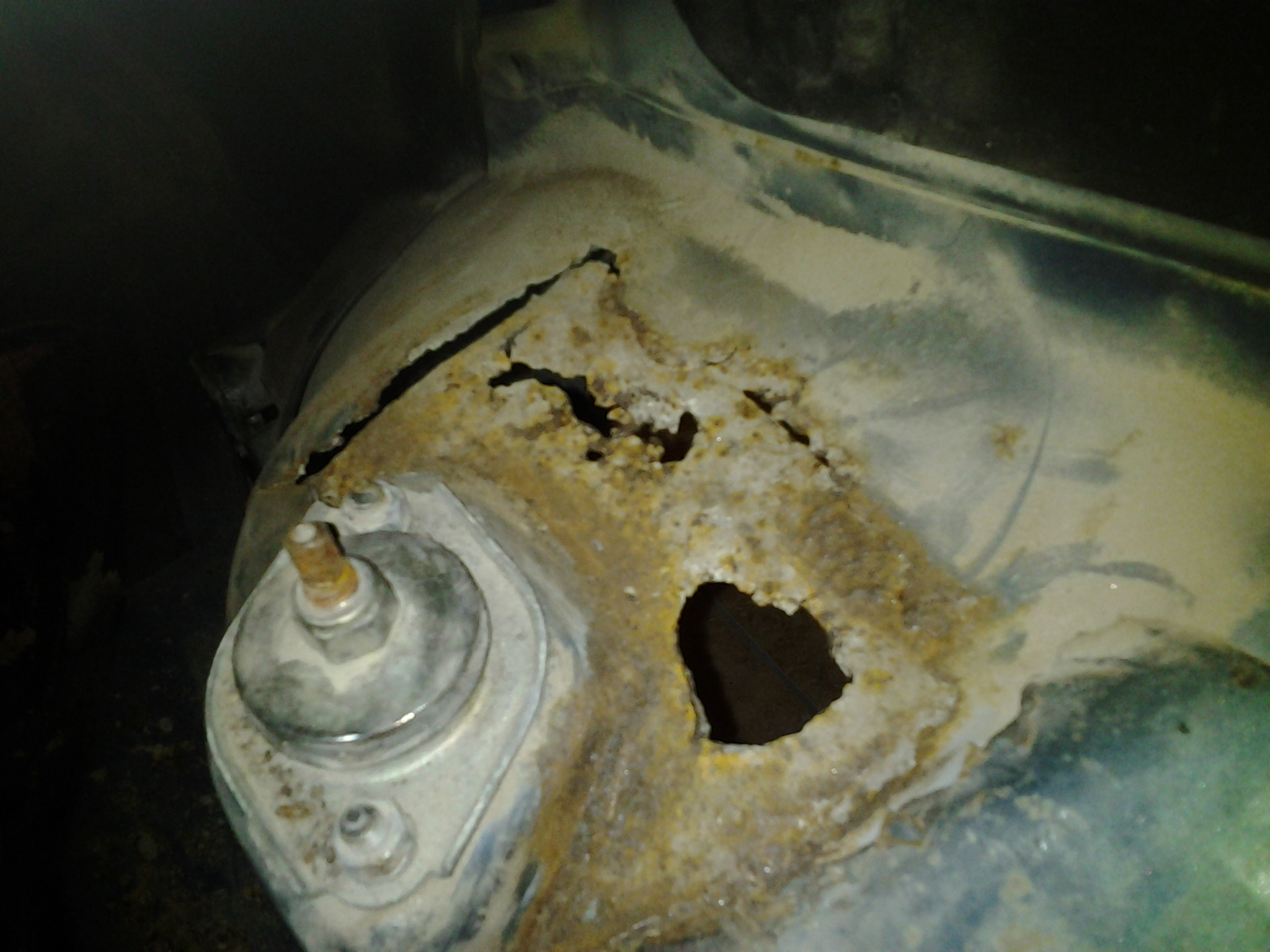

Hi all finally started my fiat uno turbo ie restoration. I started stripping the interior as i know that it rusts allot on the inside. It was a pain in the ass to take out the carpet but luckily i found no rust in the inside.took out my seats that are perfect. Here are some pictures.

Mine were just put on with seam sealer. A gentle process of cutting seam sealer with a stanley knife and putting a spreader blade between the plastic and metal. Took about 20 mins.
Since you have stripped yours, would you mind posting a close up pic of the seat runners, mine are mis shappen and i need to get them back in shape to get the seats to run smoothly.
Thanks
