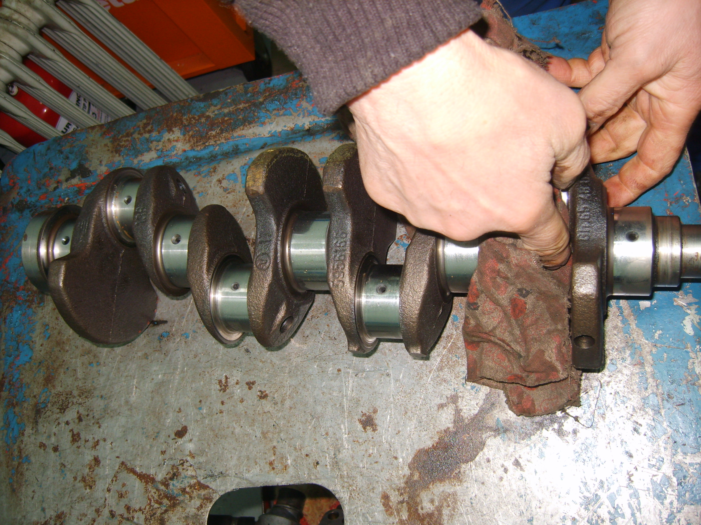

Hello, i am new to the forum, and i'm a fiat owner since december last year. i've searched the forum a bit but could not find enough data for me to fully undestant the potential of this car. what i want to know is how to get more power from my car. how others did...
I have just rebuildt the engine as it was a wreck..334.000 km..you can imagine..i spent a lot of money on this..anyway..
i already have:
- boost controler
- blow off valve
- clean exhaust
- big intercooler (not fitted yet)
- plans for reducing weight :)
i read something about, an x1/9 1500 engine cam ...
and i also read something about water injection..but it is very dangerous if you do it wrong ..soo i am stil reading :)
please point me in the right way...
i attached some pictures of the rebuild procedure..:)
if you have a problem with my english ..is because i'm from Romania..

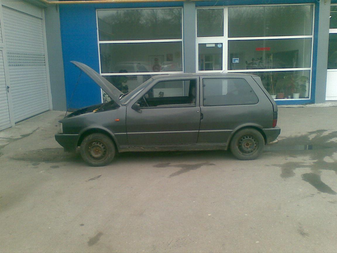

a couple of pictures with "the monster", interior, and engine..:)

you have to know that the engine is 100% perfect, i have replaced ( or rebuildt) everything moving in it: reovalized pistons, rebuildt the engine block, the con rods were polished and broubght to the same weight. oil and water pump replaced unfortunately not FIAT parts (couldnt find them animore).....and the list continues ..but unfortunately i don't know the technical terms in english..
the turbo was rebuilt too (standard one).
from my point of view it it as good as a brand new engine (at least it cost me like one :) ). it feels and runs like it should.
