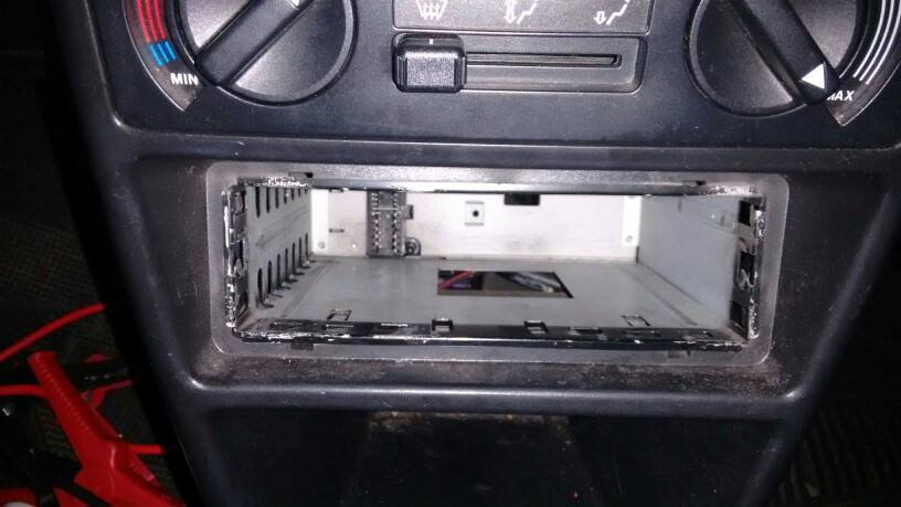

Can you tell me the maximum size of a car stereo to fit a Uno Fire ready-made slot?

You're looking at roughly 178mm x 50mm. This is the standard single din measurement. You might get a few extra mm if you cut the inner plastic.

Thanks for the replies but what about the depth? I have a feeling it can't take a stereo with CD reader.
Plenty space at the rear. Look at this pic I took of my car. The blue box is an old amp a previous owner had installed. Once that is removed there's even more space. Depth won't be a problem.
What I thought was that a long stereo would hit that plastic piece behind (the one you see above in the pic), does it pass below instead?
I don't see why a car stereo would be that long? I had another look and there is a lot of space before a radio would touch the plastic vent. If your radio was really long you could angle it downwards... this would allow for the radio to run under the vent.
Good luck and let us know how you gets on.
I have like 15cm of space before touching the plastic which is less than a stereo with CD reader I think. I'll try to insert a box to see if it fits.
I tried with a 15cm deep stereo and it fits pretty good, maybe a longer one could have some problem.
