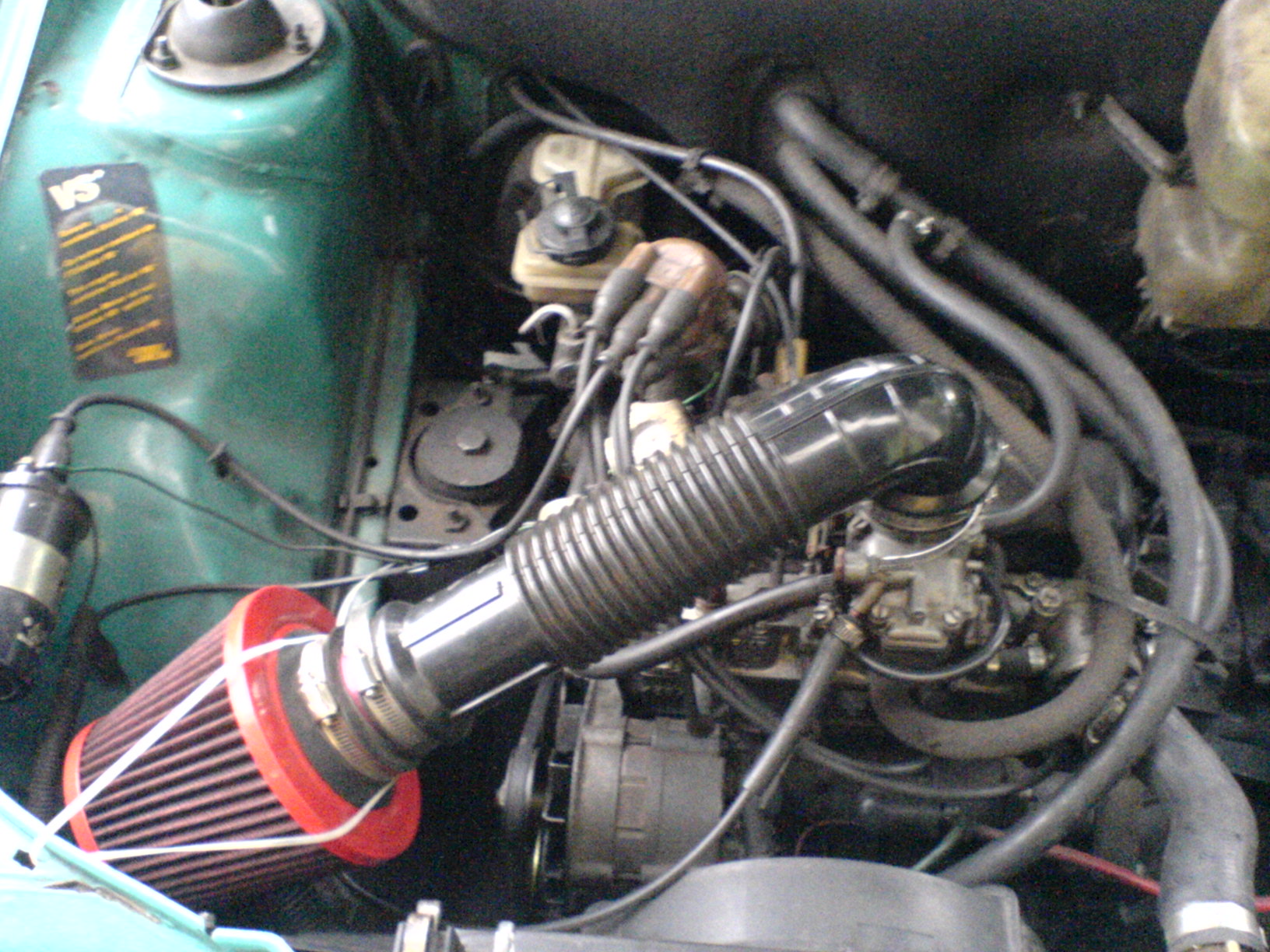

Hello dudes, i have a Fiat Uno 45 with the small 930cc engine, i wanted to put the Mk1 or Mk2 uno turbo engine on it, would you please tell me if this is possible?? and all the modifications that i have to do???

Yes it is possible. But you would need to transfer EVERYTHING from a turbo Uno into your shell. That includes the engine, gearbox, suspension, brakes, wiring looms, ECU's, cooling system, dashboard etc. etc. etc.
There's a lot more to a turbo conversion than just changing the engine. Your best bet is to find a rotten shell Uno Turbo with good running gear and swap the whole lot over into yours. Trying to buy the bits individually off places like Ebay would cost a fortune and is not advised - it would be cheaper to buy a decent Uno Turbo in the first place.

But i've done some tuning with my actual engine lol i've put a sport air filter and there's a turbonator " small turbine" in it :) . The response is better and the car does 145km/h flatout lol
