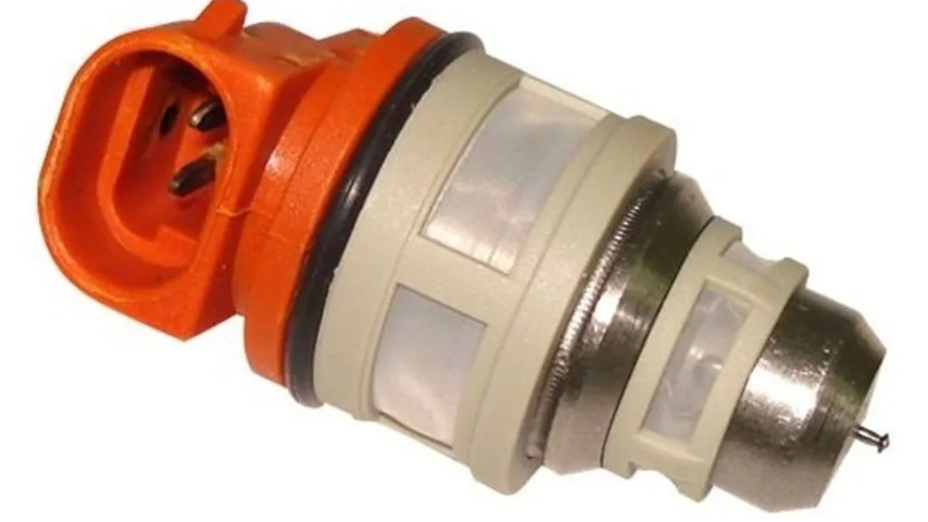

I'm doing a Punto 75 engine swap(with P75 ECU) on my Spi Seicento Sporting and I've 2 questions as regards the wiring. I was wondering if I can keep my standard seicento loom so long as I connect the 4 injectors to the Spi injection wire?(Will any wires be going to the wrong place in the ECU?) and if this is possible, can I source a female wire connection similar to the Spi injector(picture) and wire it to the 4 male plugs from the P75 injector? (Creating a sort of mini-harness)

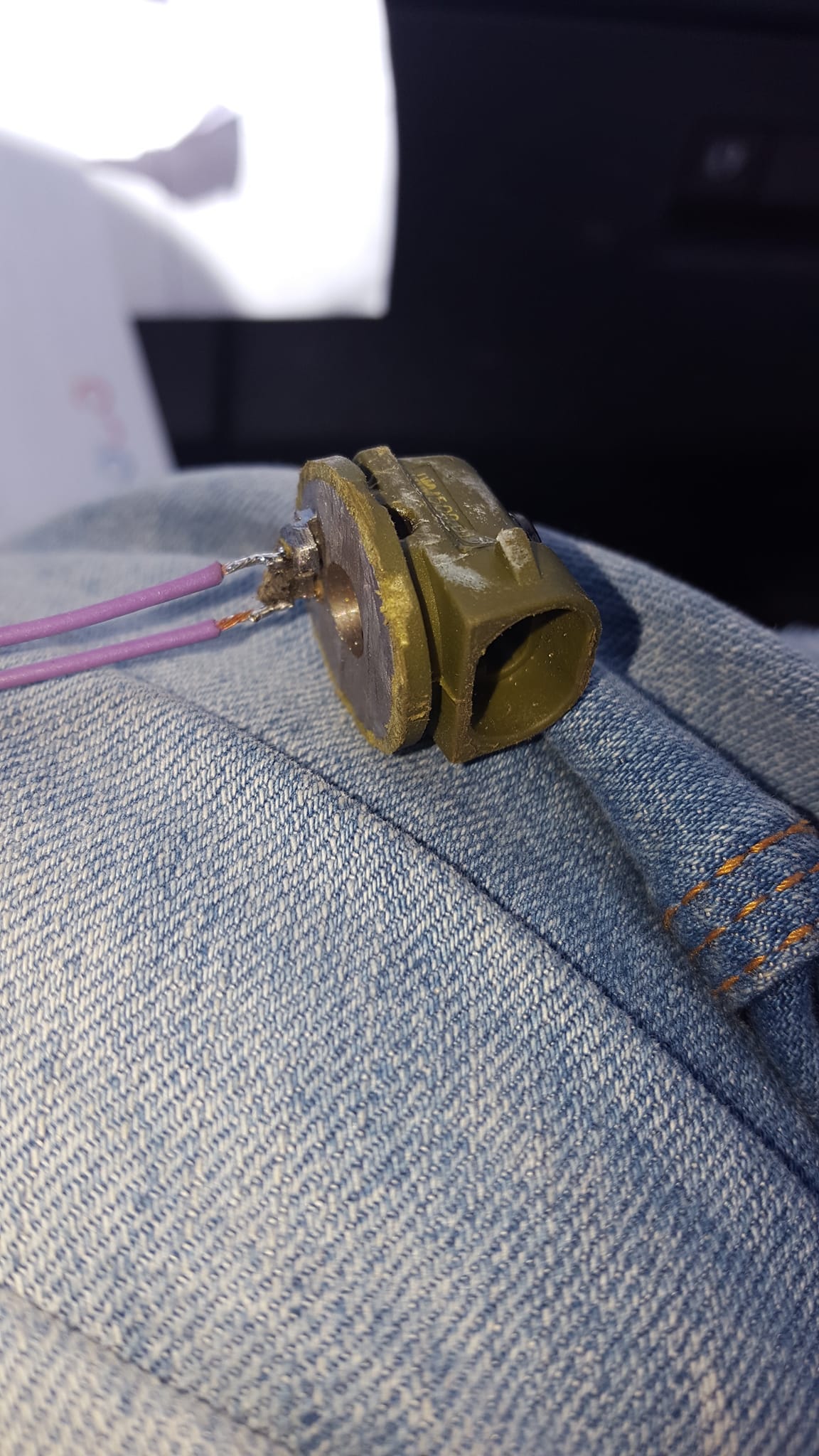

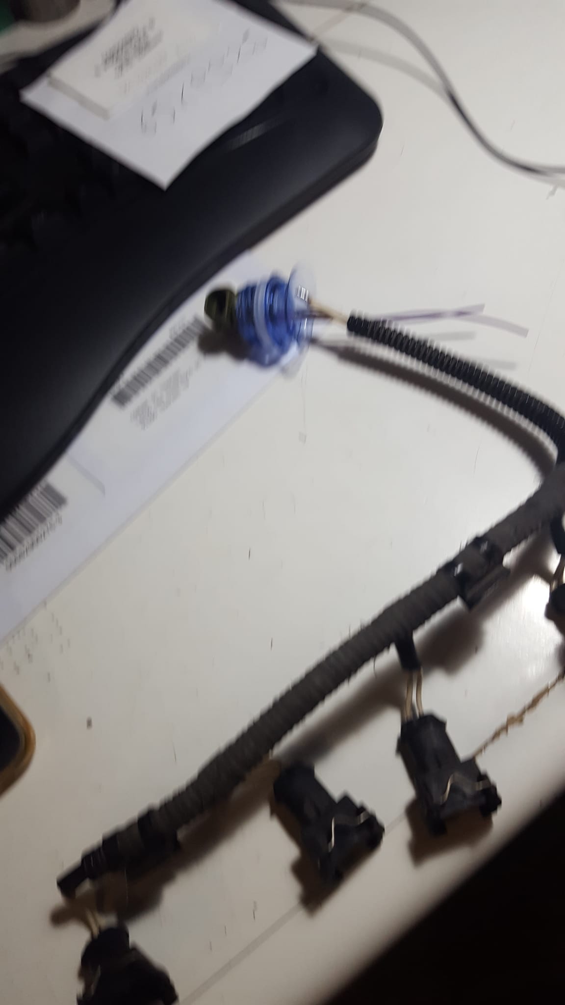

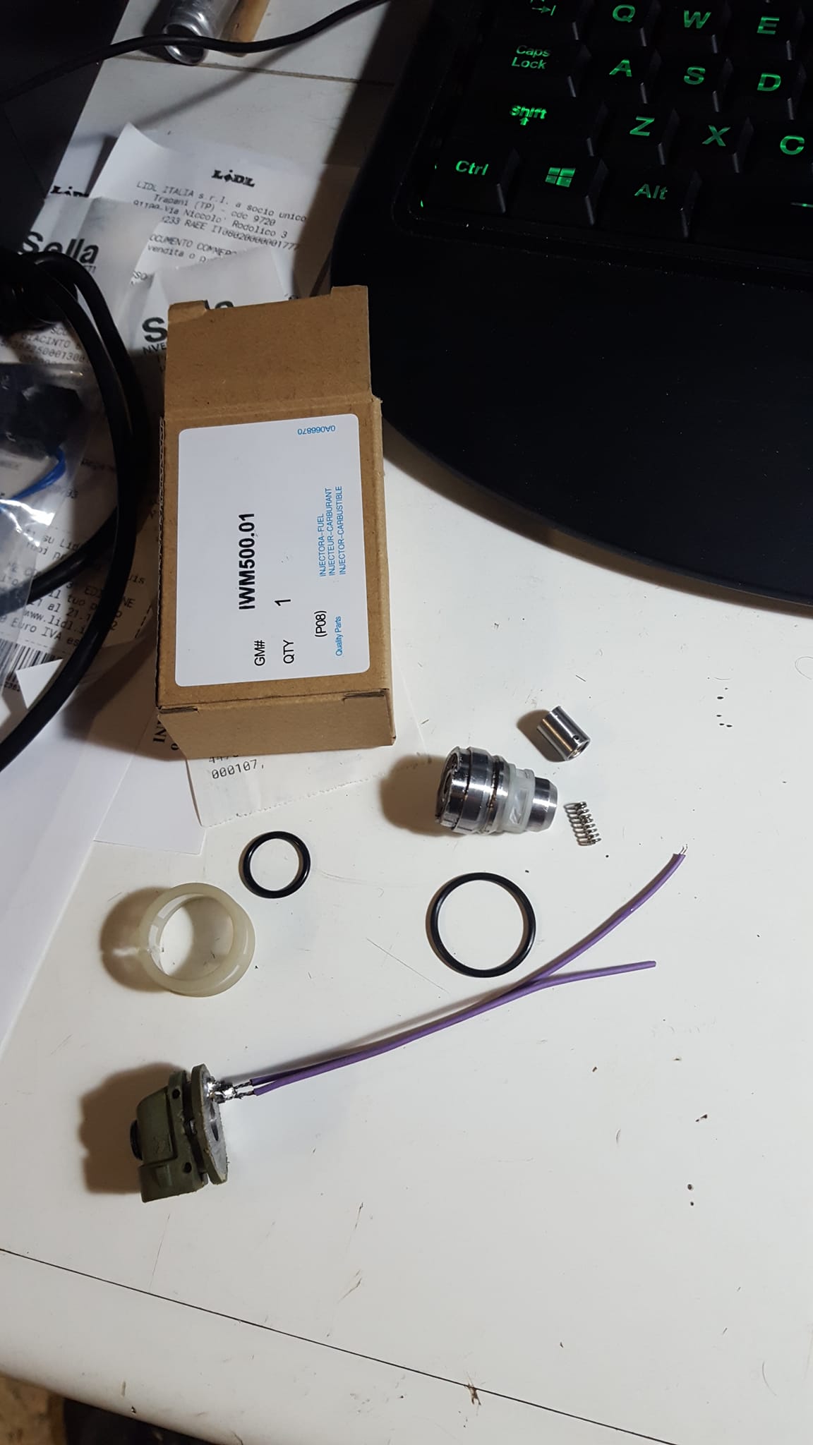

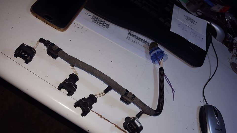

Io sto facendo cosi'
