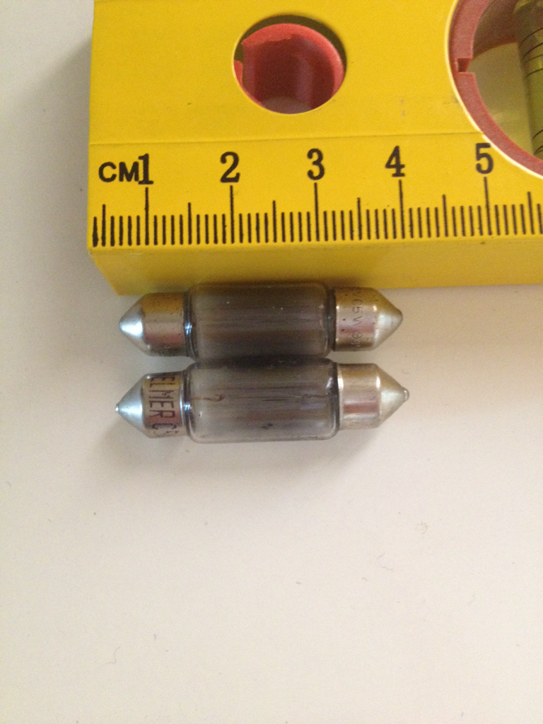

"40mm Festoon" bulb 7 Watts for the number plate lighting and the interior courtesy light.

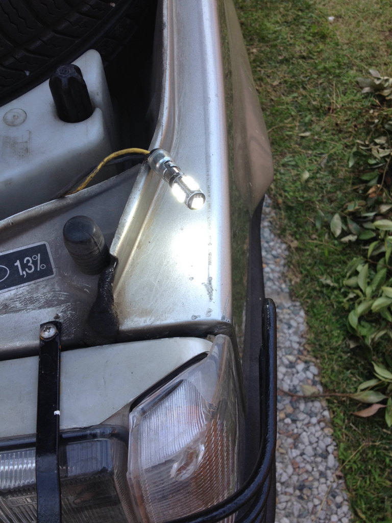

Most of these bulbs can be changed for LED types however please do read the following:
so LEDs.. they consume less power as they are lower wattage (which saves more fuel/better MPG), often brighter than the original filament bulb, and supposedly live longer if you buy good quality bulb replacements. oh and you can also get them in different colours.. and auto colour change!
All of the internal bulbs bar the "Battery warning lamp" in the instrument cluster can be changed to anything (colour, brightness.. anything!). legally. so long as there is no light coming out of your car that is distracting to other road users, you should be fine. however it would be at your own risk. the only reason why you can not change the battery light bulb is because the alternator needs it to excite (or kick start) it to start producing power. in short, replacing this with an LED will cause your alternator to stop working. you "Could" make an LED and solder a resistor across it to get the same resistance the original bulb has, then try it. that may work. you can also try a "Canbus error free" LED bulb in it as they have a little load resistor that fools modern cars into thinking the bulb has not blown (Due to LEDs consuming far less power, the modern car's computer detects them as "blown bulbs". something us classic Panda people don't have to worry about
Externally, changing bulbs to LED is at the vehicle keepers own risk. UK laws state that original vehicle lighting should never be altered from the original specification.. or so i have been told. i have also been told that so long as the bulb is "E" marked, it is fine to be used on your vehicle.
if you do plan to go all out and start playing with vehicle lighting colours be sure to check up with your local laws! As said, any modification you do is at your own risk.
