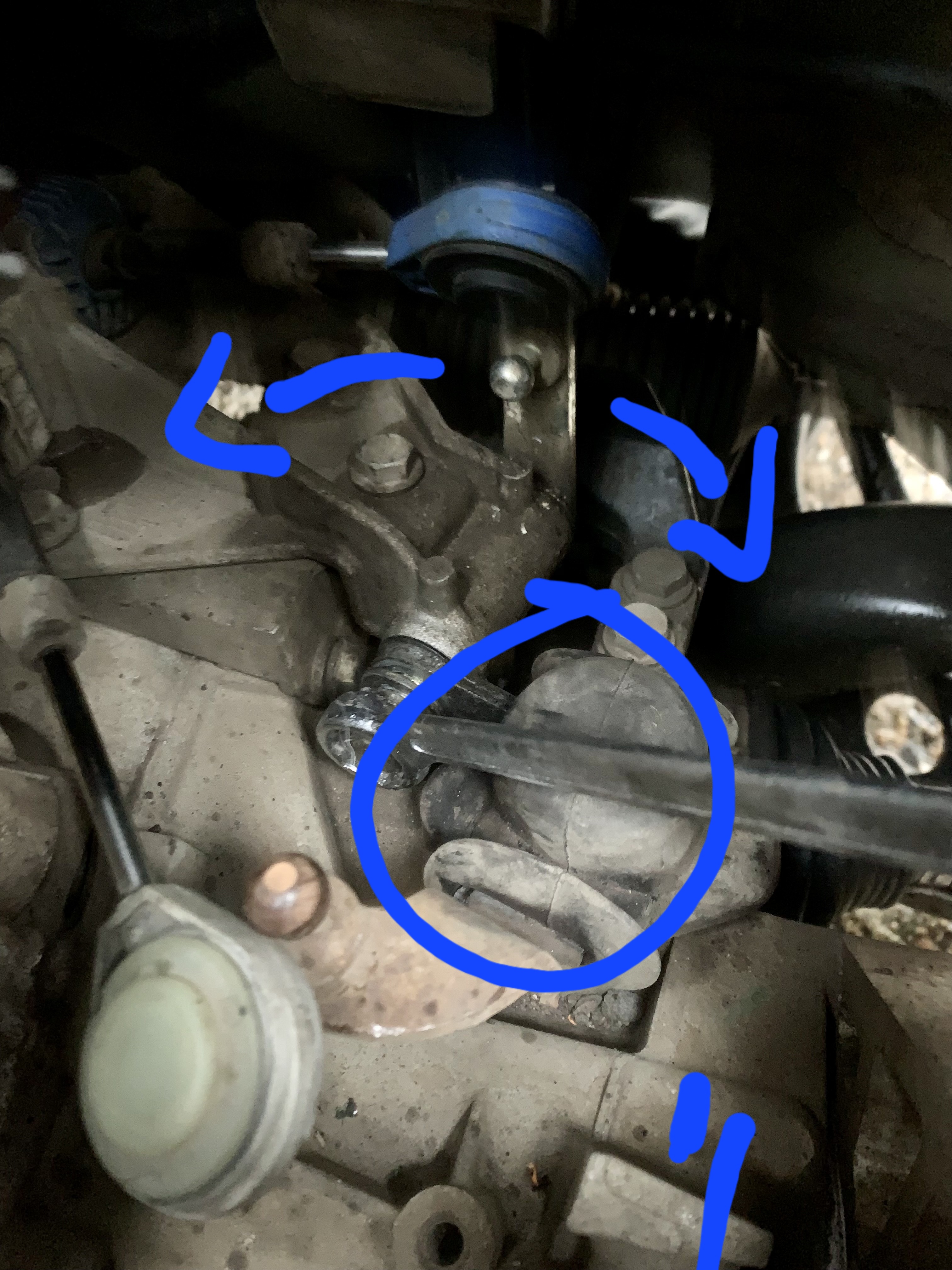

I did the stiff gear stick job.
I did not find the silicon grease I used the spray silicone . I bought the metal sponges and sanding paper from halfords. To remove the corroded layer, which was at the bottom.
I firt scrub it with the sponges and send it with 800 and 1200 sanding paper.
Only thing different from your model is that I had no plastic cover to protect the mechanism
Please see rhe picture.
Now the gear stick is more than free it is excellent.
A lot more free that the time I fixed in warranty.
I hope this will last at least 2 years like other people said.
Thanks a lot for the tips.

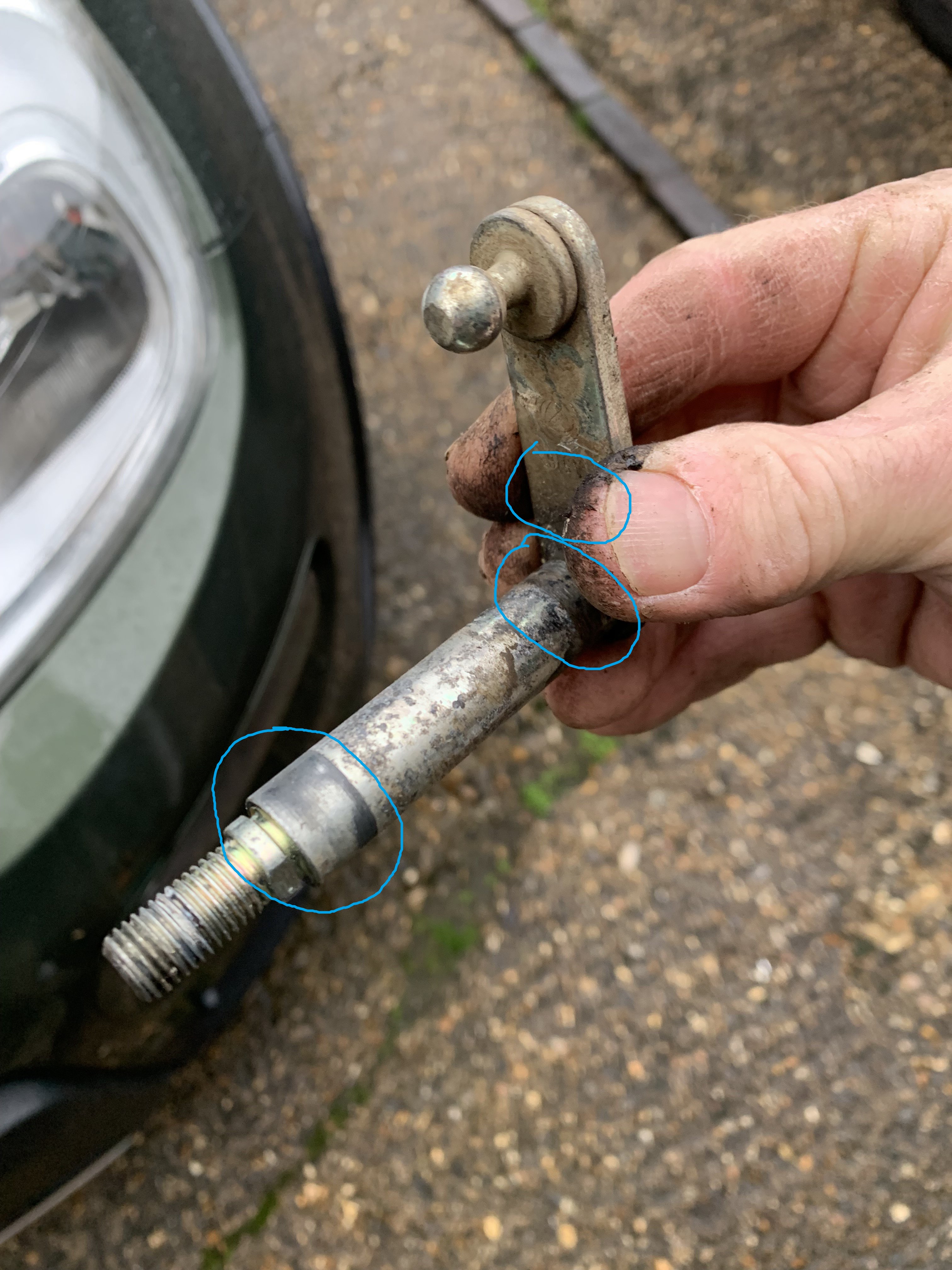

UPDATE :
I noticed one thing with my car, the gear stick is very free now when I start the car, when the heat spread and the rog get hot it dilate a bit so the gear stick became a little less free.
I did send the rod but I did not use a degreaser first, next time I will put a little more pressure on the areas that I SIGNED in the attached picture .
I cleaned and sand all, but put effort especilly at the end where the plastic washer goes, the 2 end are the most important since the center is not attached to the metal.
Please see the areas highlighted

UPDATE :

I think that it is very unlikely there is much big dirt there, the rod adhere completely to the inner side and there is a metal washer in the nut side. ]
the "hole" is just a pivot . much of corrosion is in the center because of it.
Next time I will clean the pivot completely and re place all the old grease with new silicon grease.
Trying to sand more where the plastic ring goes.
