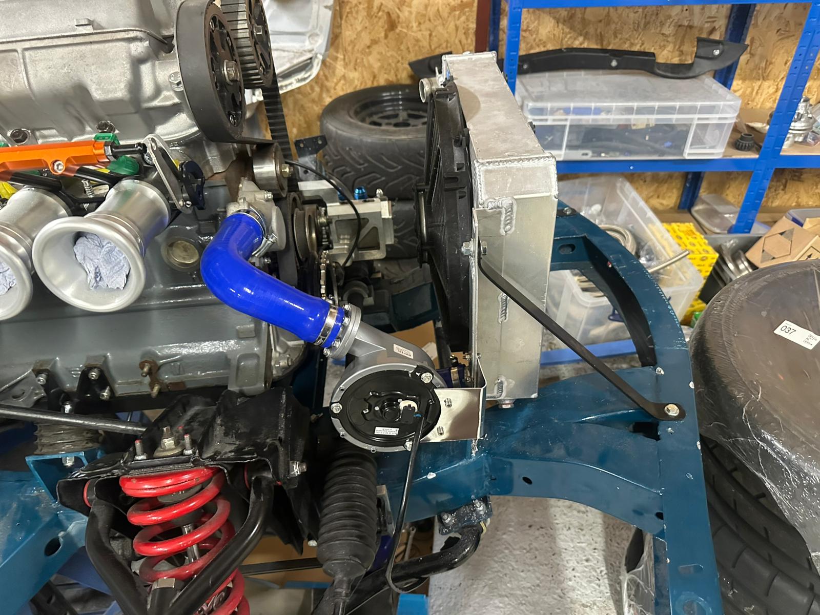

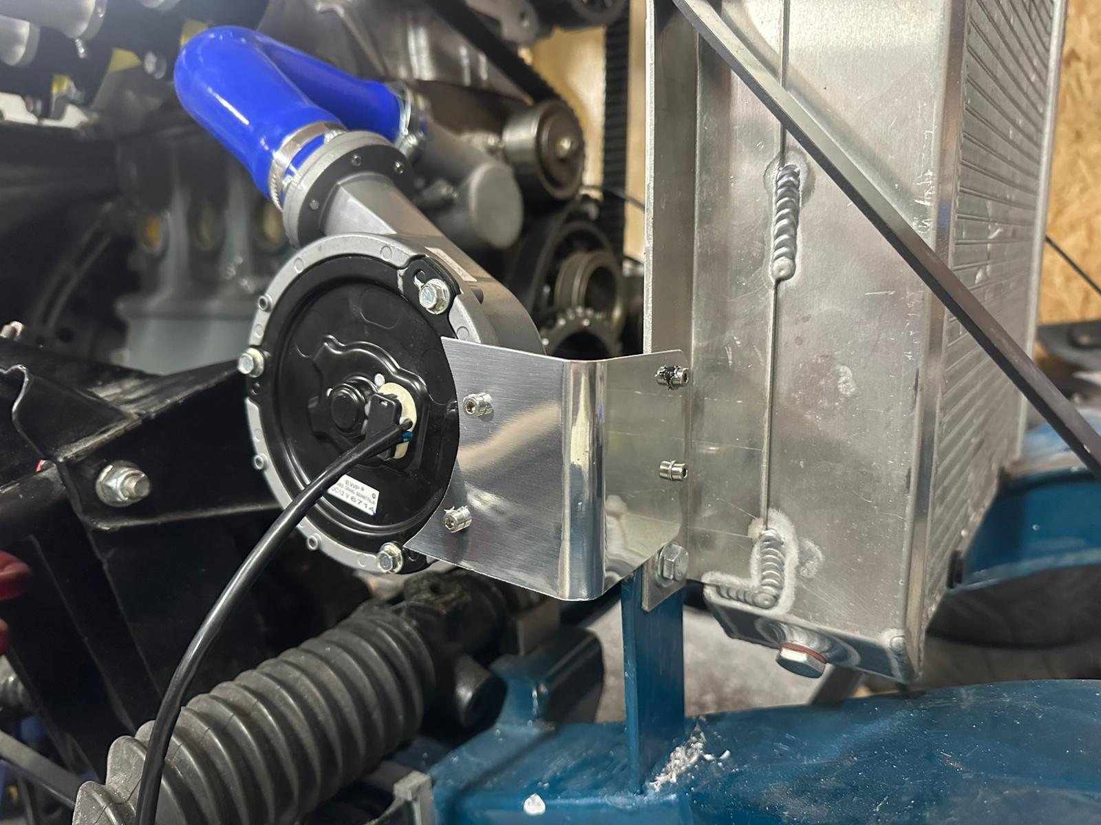

CATERHAM RACE RAD ,
DC ELECTRIC WATER PUMP AND CONTROLLER .

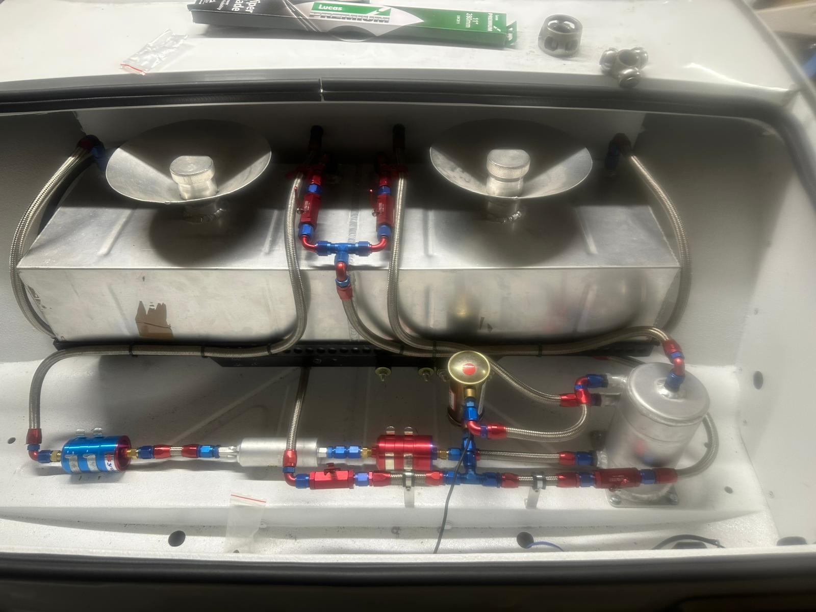

ALLY TANK .

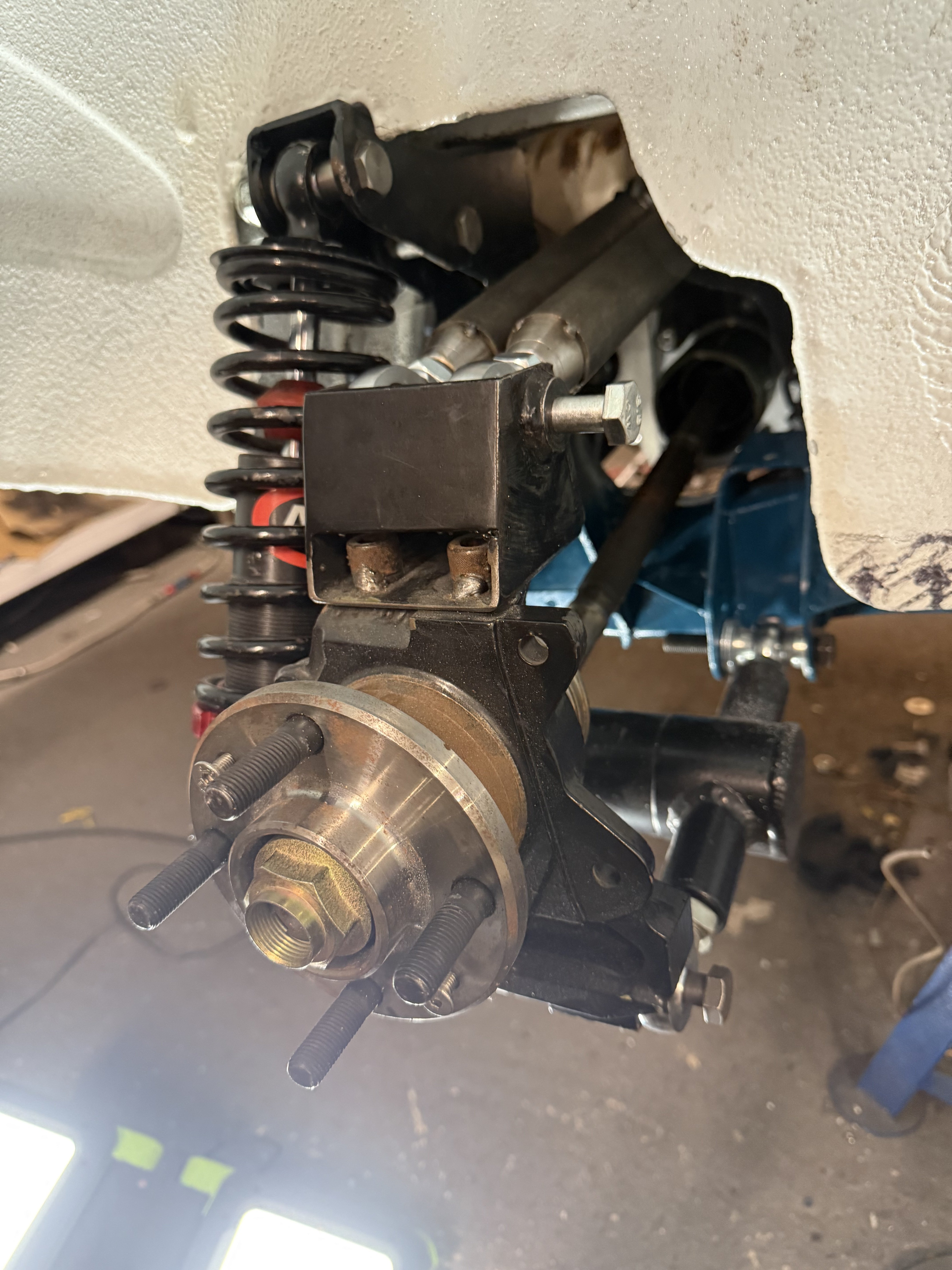

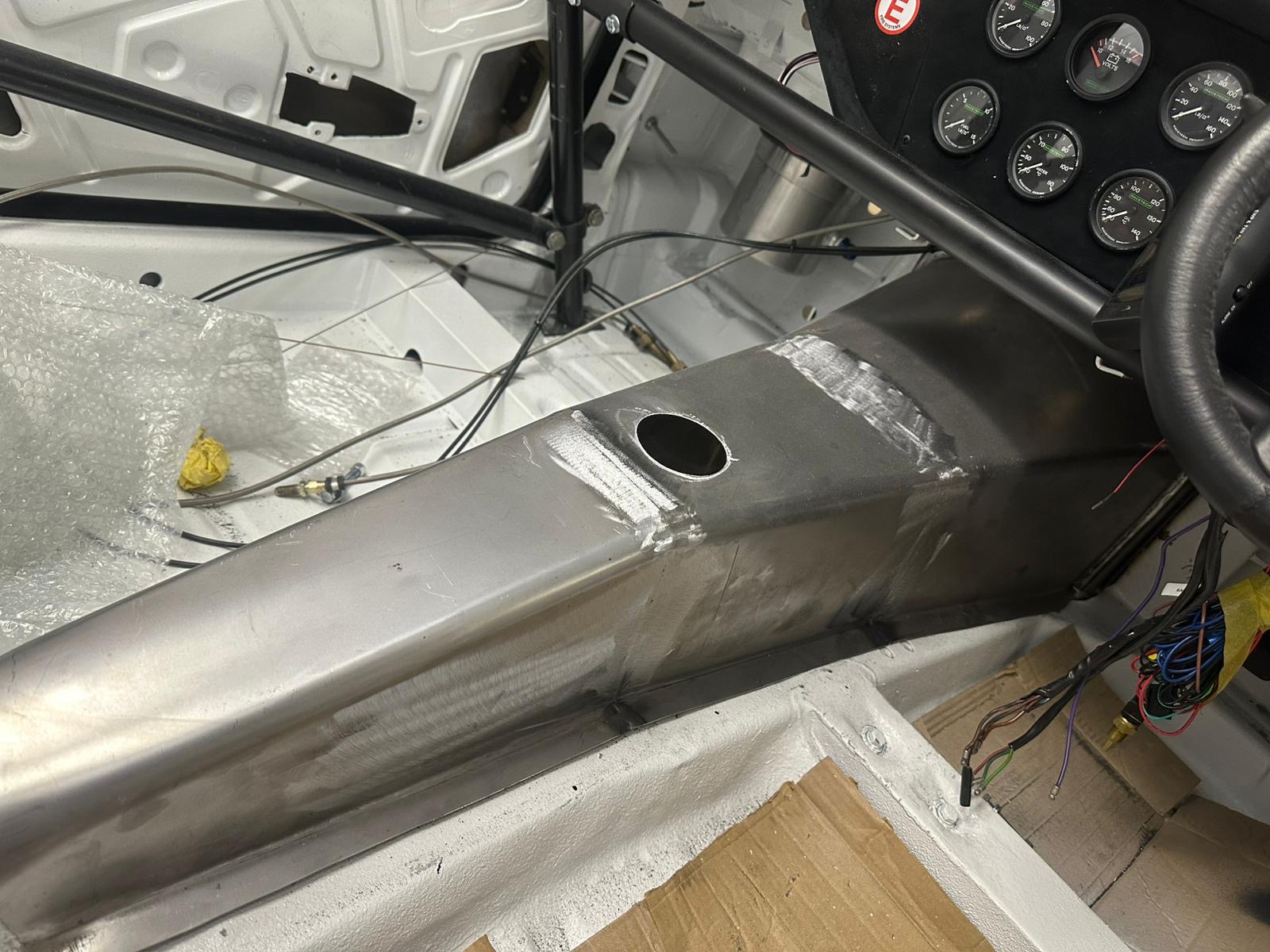

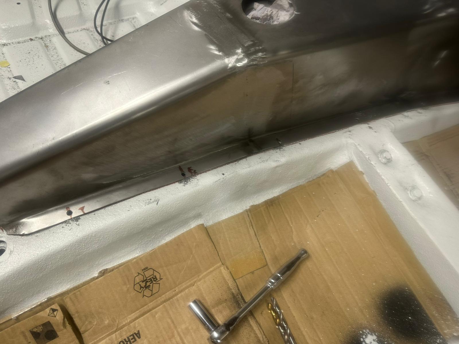

Hi Mike ,
We are fitting a lower A arm with a second pick up point at the rear of the chassis ( made from left over tubing from other projects ) . The rear spring is gone , replaced with a top arm linked to a wide mount on top of the Subaru R160 diff . This is not ideal but shorter than the original spring . Avo coil overs hung from Canley frame extenders . New half shafts are being currently fabricated to link the Subaru inner lobros and MGF outer CVs .
