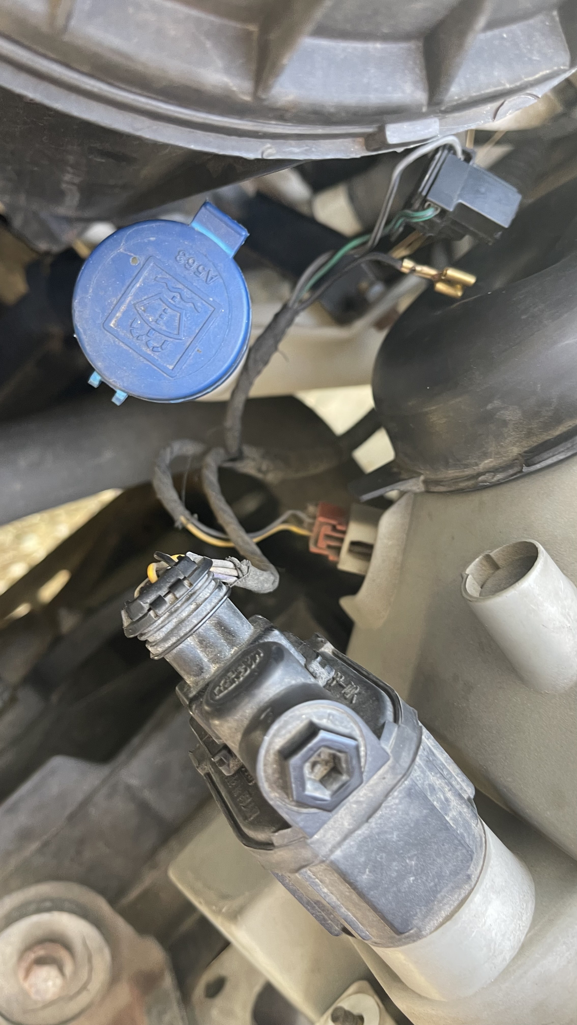

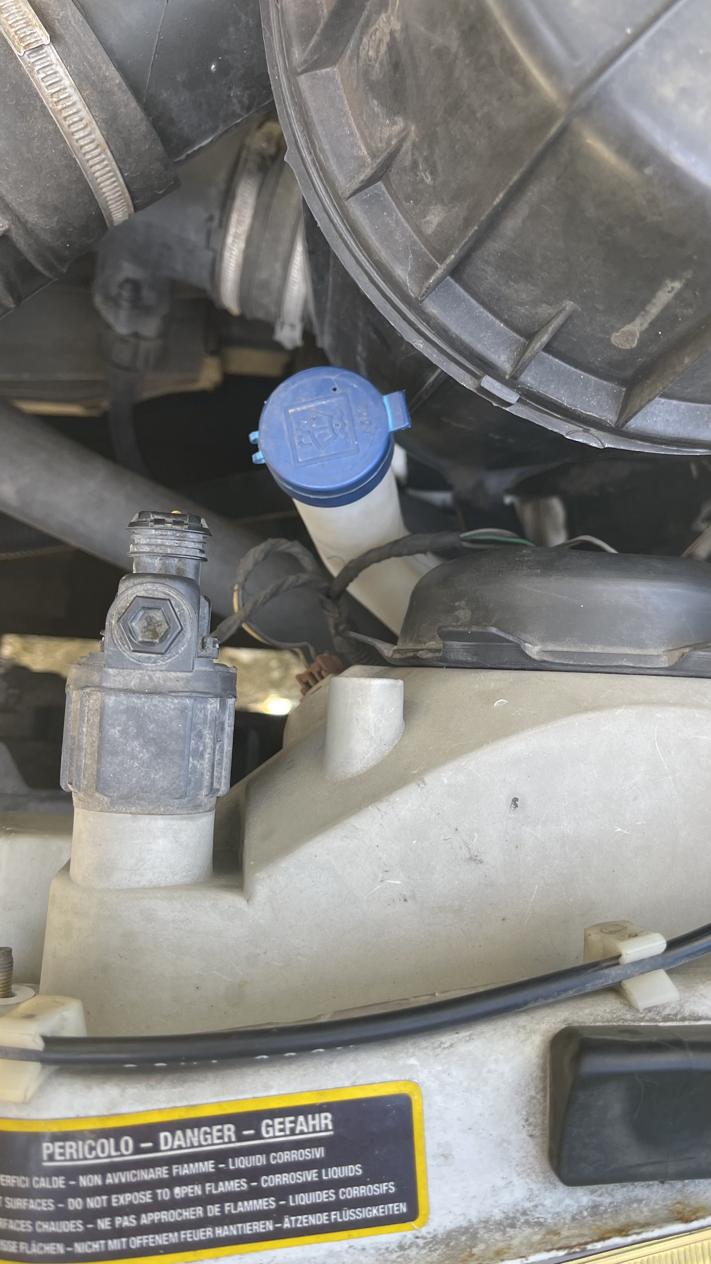

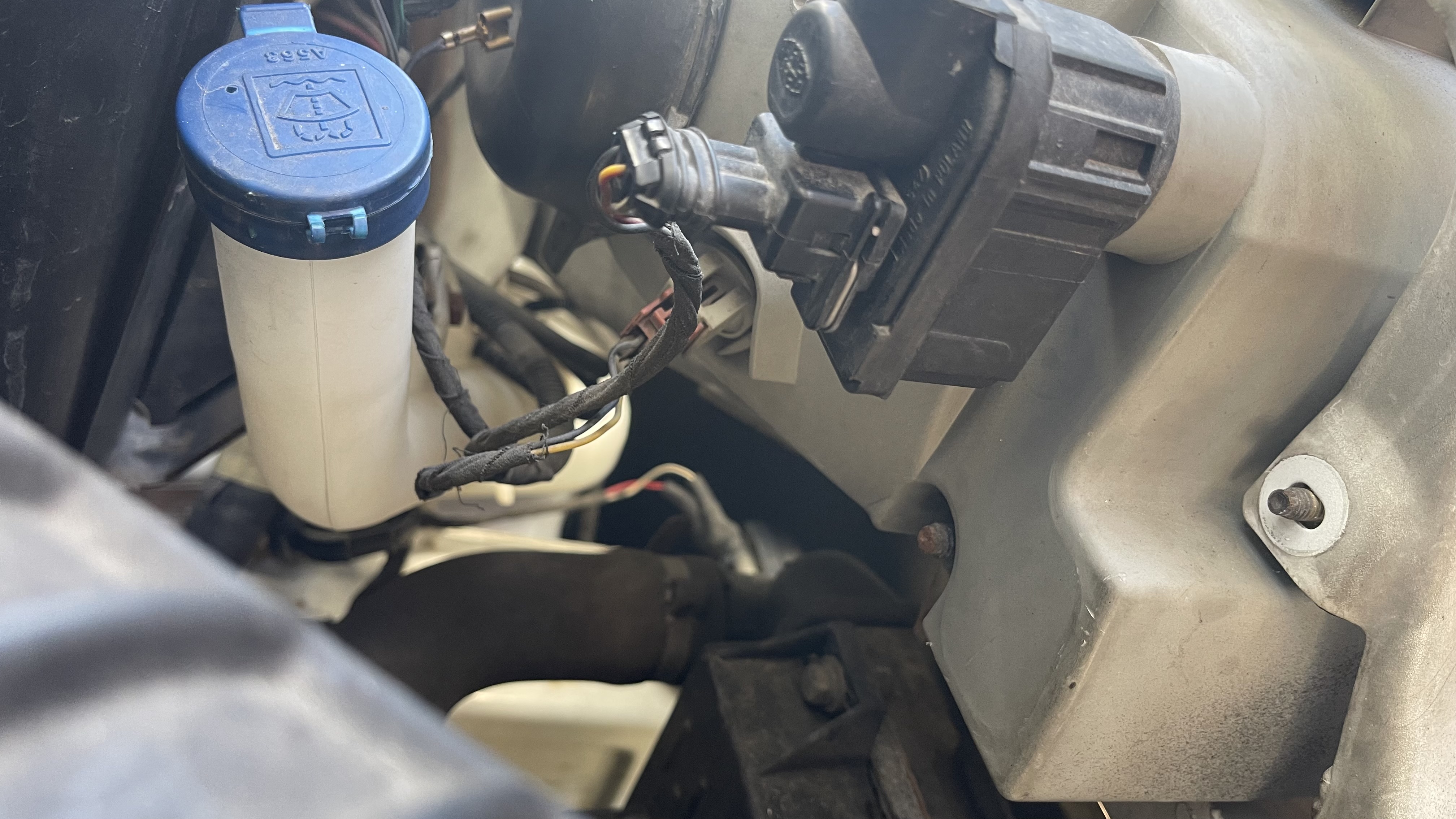

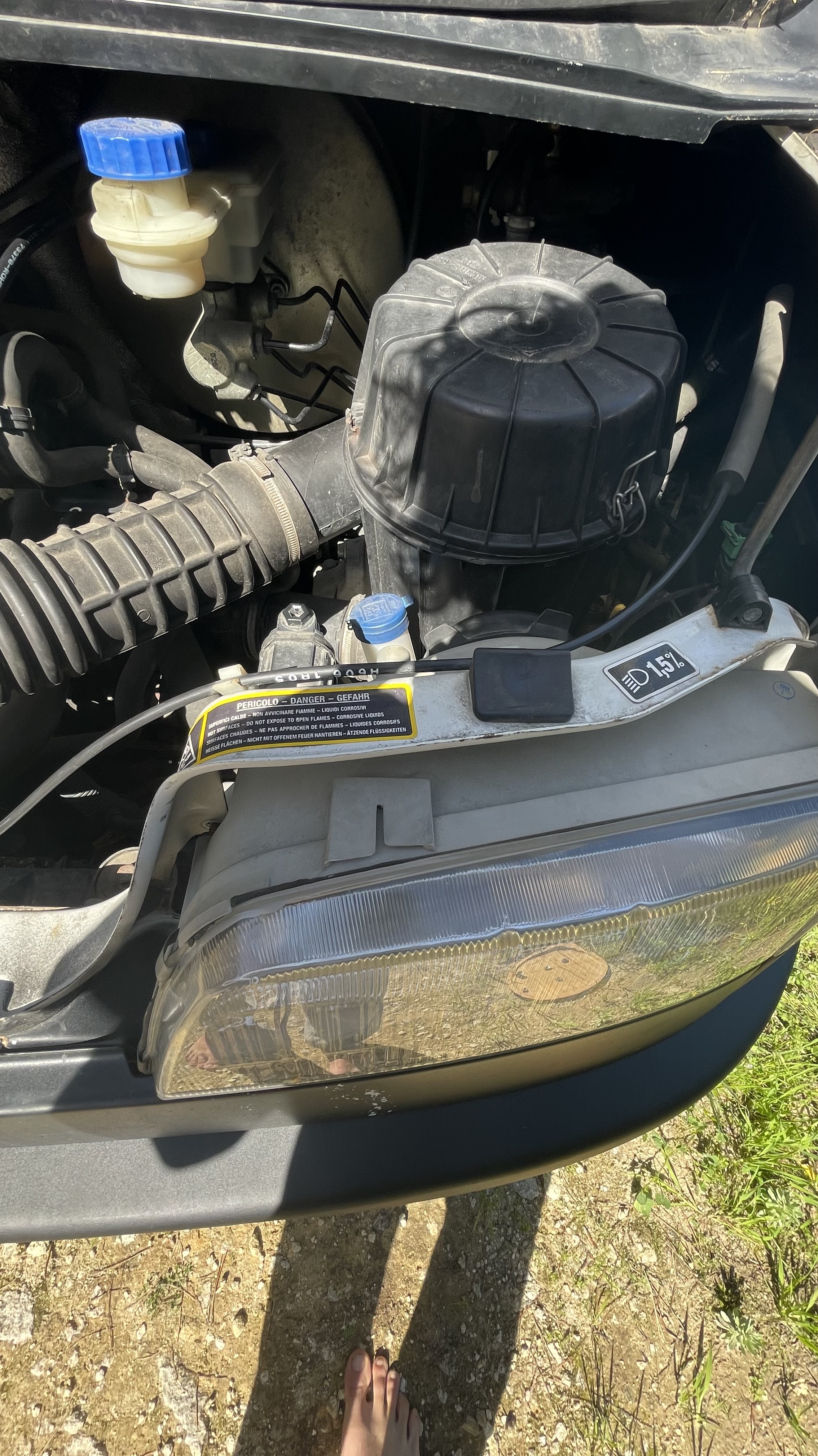

Hola! Can anyone recommend a good tutorial on how to change the light bulbs in a Fiat Ducato JTD 230 from year 2001 please? Not sure how to pull out the plugs. They seem a bit stuck … don’t want to tear too hard : |

If you look closely at the connectors shown in the photographs, they have a stainless steel wire retaining clip. This clip must be levered or pulled outwards before trying to part the connector.

Thanks for this piece of advice, it was exactly what I needed - Many Blessings***
