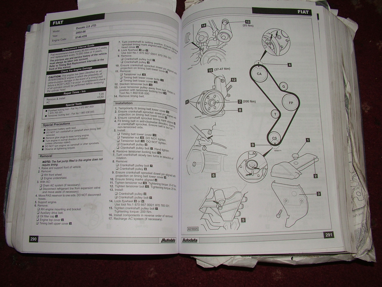

Hi All I have a fiat ducato 2.8 jtd 2005 does anybody know where the washers go on the bottom tensioner pully i know you have to put the lipped spacer washer on before the pully but does the cover go on before the outer spacer or does the outer spacer go on before the cover, then the cover, then the flat spring washer and 17mm nut, just a bit confused as at the moment there is a washer then the flat spring washer then the nut it appears that the alternator belt has been rubbing on the cover and the cover is distorted any help would be appreciated.

I have done several on Ivecos with same engine, but not recently. Does this help.

Hi Bugsymike Thank you for your help the diagram and fitting instructions do not mention the spacers looking at the diagram it does not show any spacer so maybe the spacer goes on the inside of the cover the Iveco engine is the same as the fiat as i am sure you would know, i do not know why they do not mention the spacers as they are important they also do not mention that the rollers are different sizes and what one goes where if somebody fits these in the wrong place then the next person will do the same once again thank you for your reply.

Sounds right to me , stepped spacer on inside of cover to prevent crushing plastic, but also to discourage moving the inner part where securing the tensioner when tightening cover outside nut.

That sound right from memory on my Iveco Dailys, the stepped washer, then the cover then the penny washer, locking washer and nut.

Thanks people this has been very helpfull looking at the way my cover has been fitted it is the same, cover, penny washer, flat spring washer then nut i was wandering if this was right as the cover was distorted and the alternator belt had been rubbing on the cover.

Hi All well i have replaced the cam belt and it would appear that the problem with the cover being distorted is the position of the large washer, in the workshop manual posted by Bugsymike it shows the cover and then the flat spring washer you cannot see then the nut, the washer with a lip goes under the cover with the lip that engages in the hole in the cover, so the sequence is the large washer with the lip facing outward then the cover then the flat spring washer that makes contact with the lip then the nut, all appears to line up perfectly and the cover is straight but please check this out to make sure the sequence is correct for yourself

Hi Bugsymike. I'm quite interested to find out where you got a printed workshop manual like the one you photographed?
The Cambelt timing manual was by a company called AutoData and before retiring I used to buy their Diesel and Petrol Technical Service Data Manuals as well as this Cambelt manual every year for roughly £100 a time. Nowadays they supply a more detailed version online by registering, last time I checked it was around £1000 per year and time expired unlike having a hard copy book. They were designed for the experienced motor engineer so didn't go into basic stuff like a Haynes manual, but they and their predecessors I have used since 1969 and found very reliable.
You may be able to find copies on eBay etc. Generally I bought new each year and disposed of the old ones, my last ones are from 2012 shortly before they went digital. They went from Alfa to Volvo so great for independent workshops and also had commercial versions.:)
