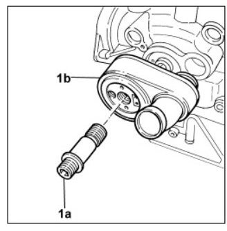

I wondered if they haven’t done the water pipes up correctly if it’s water cooled? I’ve attached a photo that I think is a heat exchanger on the oil filter?
Hi
Your picture doesn't show up (you may not be able to post pics yet as a new member). I think you are referring to the oil to water heat exchanger block which sandwiches between the canister oil filter and the engine block, see attached drawing. I presume this warms the engine oil to begin with, then when the engine is working hard the heat flow is the other way i.e. from the oil to the water. Nothing which would affect the gearbox. Manual gearboxes are very efficient, and do not generate much heat. The little they do produce is carried away by airflow over the large area of the casing. True automatic gearboxes are sometimes provided with a radiator to cool their fluid, but that's not the case here.
The main return rubber hose (lower hose) from the radiator joins to a rigid metal pipe across the front of the engine, then to another curved rubber pipe that joins to the heat exchanger. It wouldn't normally be necessary to remove this end to carry out a radiator change, just the connector at the radiator end.
