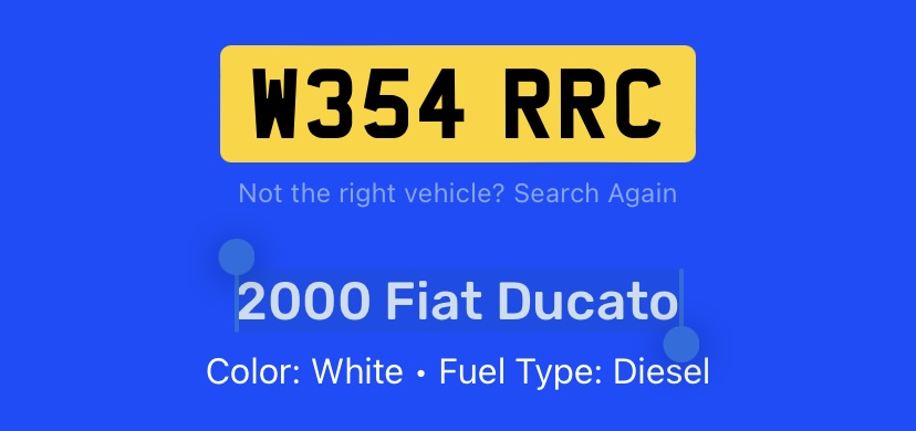

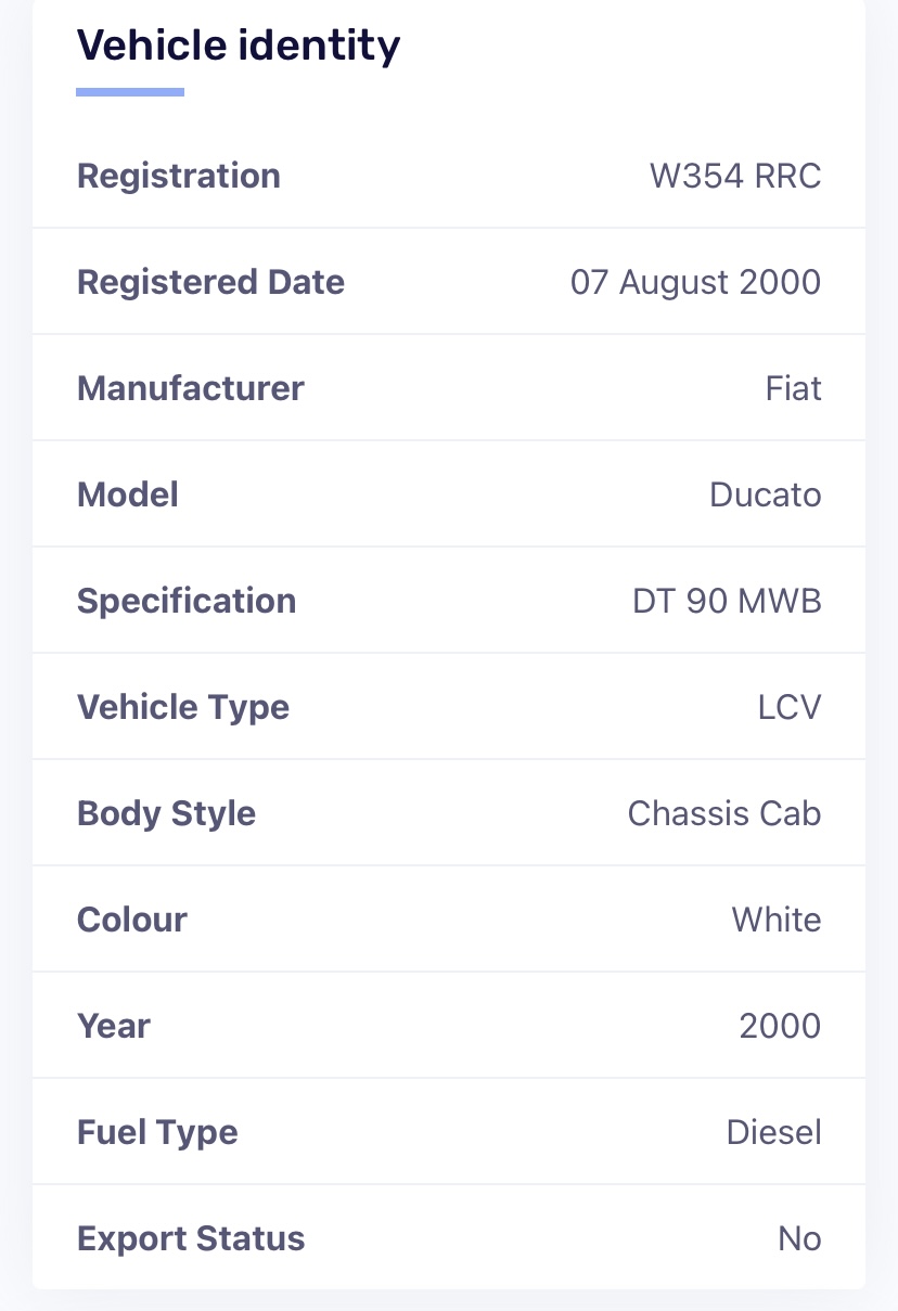

Hi guys , trying to find a full haynes manual for my dad this post seemed the closest thing , dies amyone have a pdf link or document i can download please , these photos are his model .

What details do you need ? If it is normal servicing spec., timing belt details etc. if you post engine Series number and exact cc I may be able to help.
Not if general instructions on how to work on a vehicle as my details are for the motortrade so would know the basics already, hopefully;)

He just wants a full copy to be honest , is there anything legit made ?
Type in Fiat then Ducato and variant , it seems to list the Mk 2 to 2006
They do online versions but best to go for the hard copy book.

doesn’t seem to be a option for the 1.9 engine
