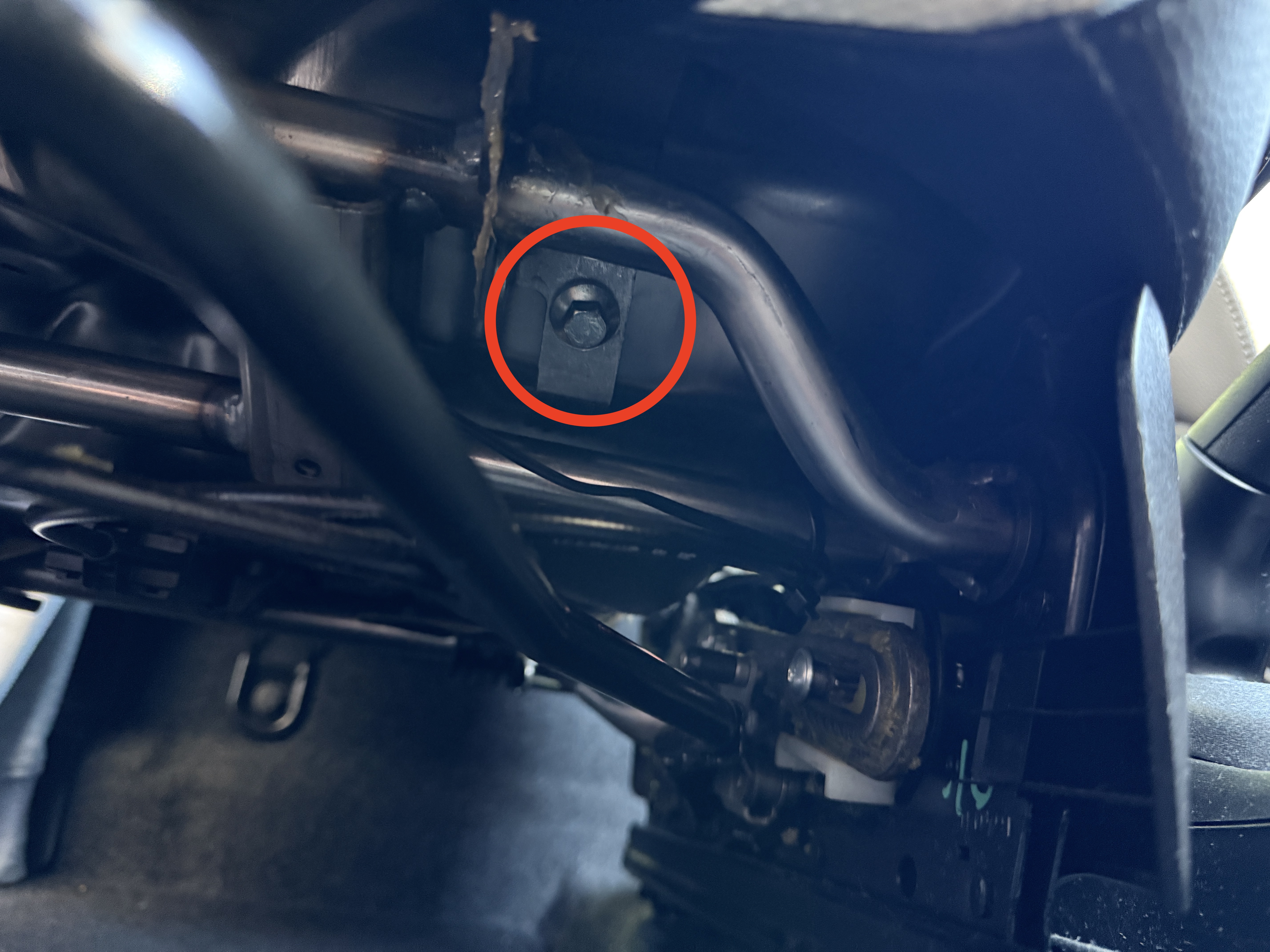

Yet another weird issue on my 2017 fiat 500 sport. Last week, the driver's seat started to crunch and click every time I pushed the clutch or moved in my seat. This steadily got worse until I couldn't stand it & had a look under the seat. One of the brackets still had its bolt in, but was sitting away from the seat base underneath. I’ve circled the bolt below.
Upon closer inspection, the captive nut which is welded into the seat base, had broken free, and it was this clicking in and out of the seat base that was causing the issue. I’ve removed the bolt & the captive nut fell to the floor. So for now, I've added a bit of fabric around the bracket to stop it clicking, and the seat itself still feels pretty solid with one bracket missing.

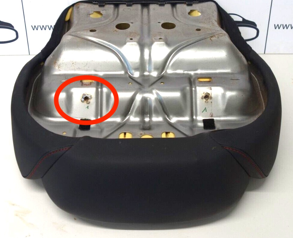

I’ve been looking around for a replacement seat or seat base, and they seem impossible for my trim level. I had found replacement seat bases, like the one below, which I've circled the point of failure on my own, but the trim is different.

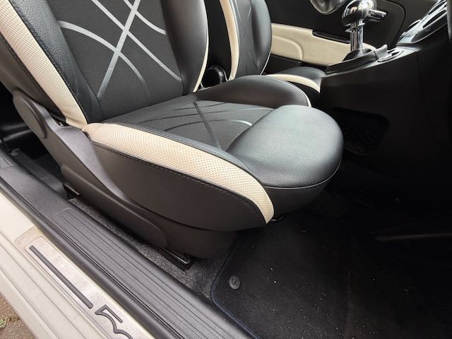

And this is my trim/fabric style
