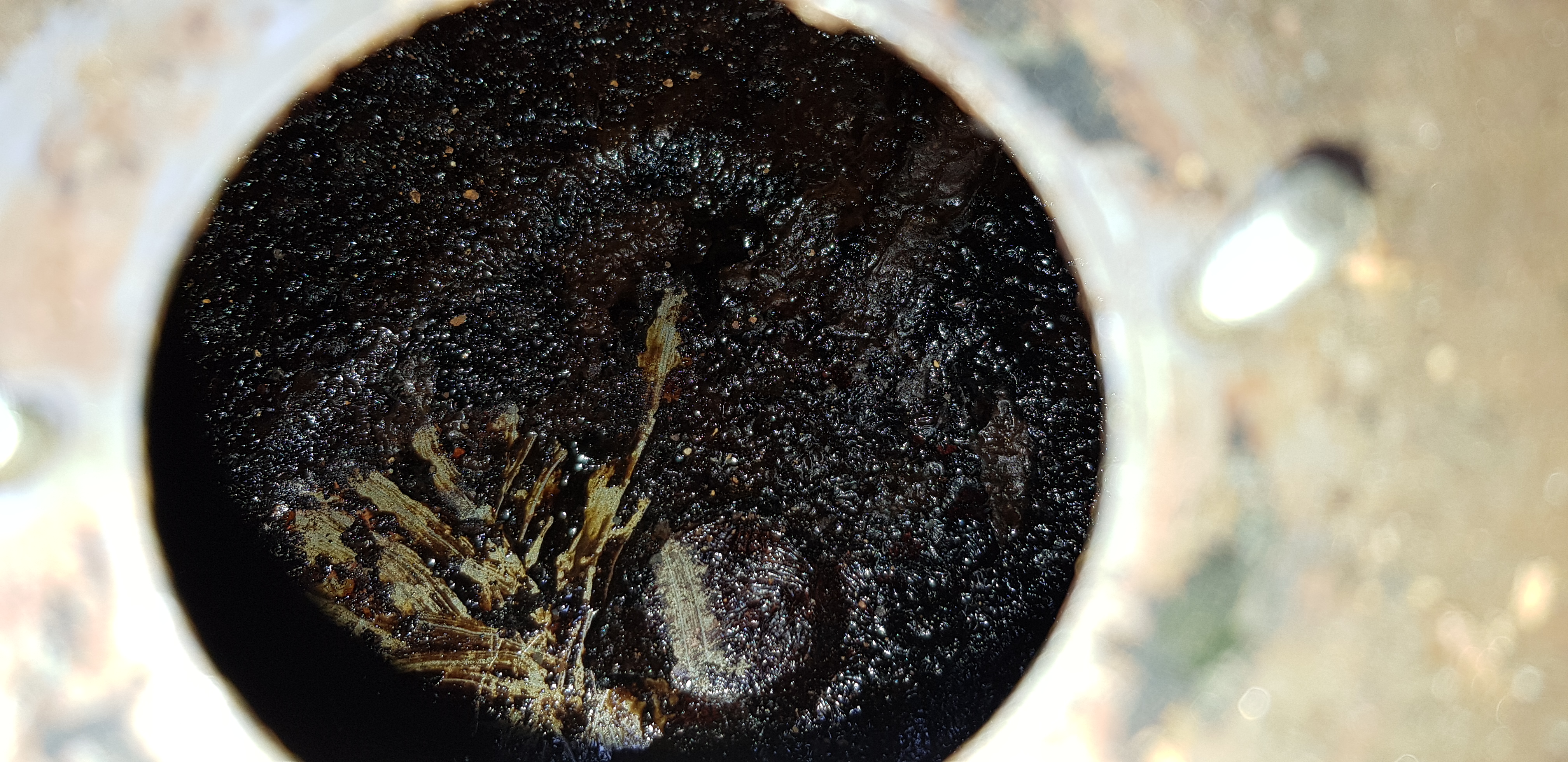

Really appreciate the views and advice, but I think I might have to go down the new fuel tank road. Removed the fuel level sensor and there is a thick tar like substance covering the whole inside of the tank. I can only assume it is stale fuel and working out the costs of cleaners and coatings it would be more cost effective to get a new tank. 20180502_083959.jpg

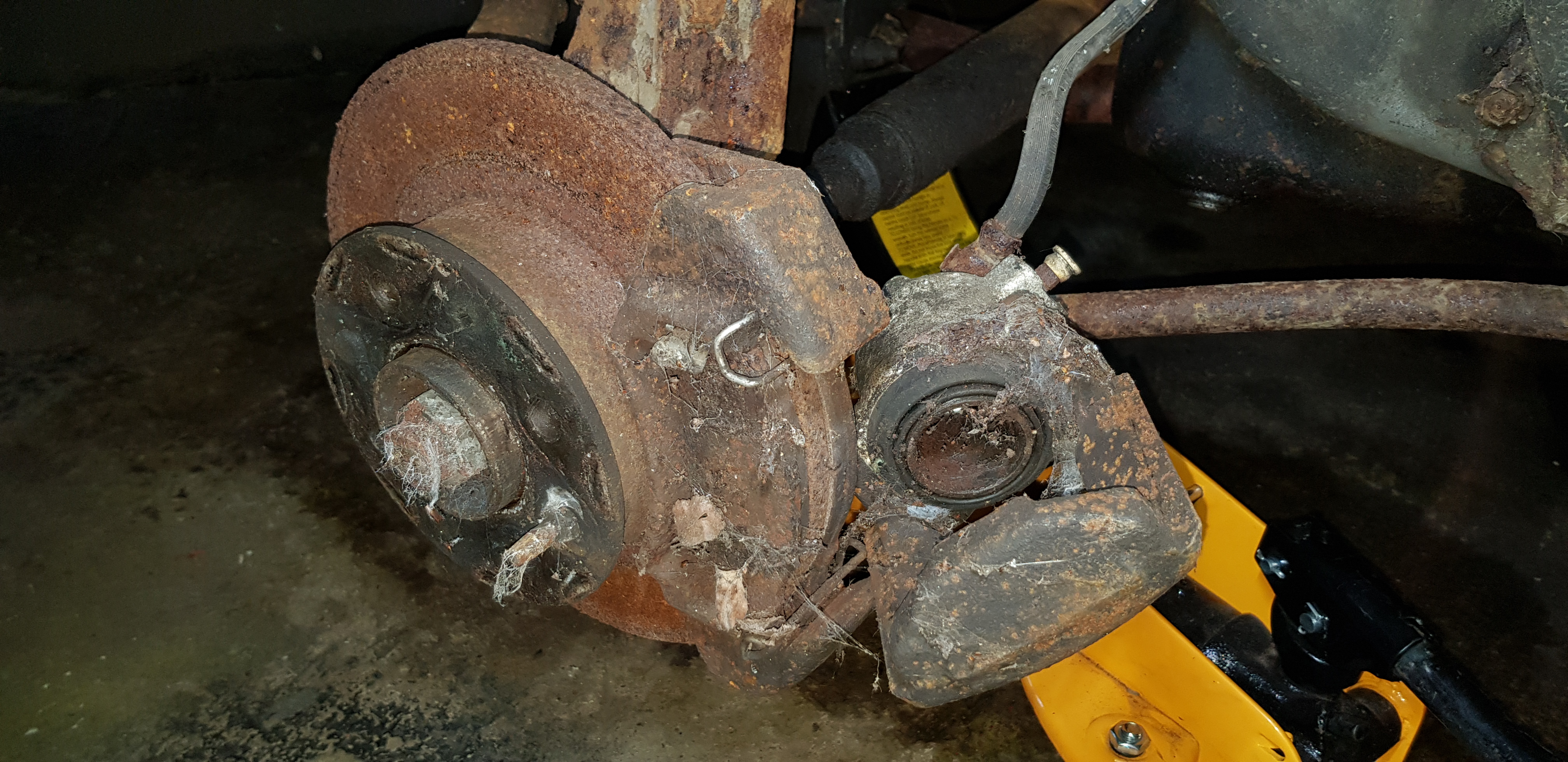

When you say the caliper piston is well and truly seized, what do you mean?
and what attempts have you made to free it off? Have you tried heating the caliper body?
The caliper piston usually becomes corroded outboard of the seal under the dust boot. This mean that the piston can't be pushed back e.g. to fit new brake pads. The best chance of freeing the piston is to use hydraulic pressure (i.e. when still connected to the car's brake system) to push the piston out. There is a special pliers available to twist the piston and try to get it to move. (it has jaws with teeth on the outside and as you squeeze the handles the jaws expand to grip the inside diameter of the caliper piston i.e. it operates in the opposite way to a normal pliers.
If using the cars brake pressure, please be careful, mind your fingers and eyes, it's a good idea to place a block of wood or similar between the caliper piston and the body - a stuck piston suddenly freeing off can cause serious injury - if, alternatively, using an airline, the piston can be ejected with considerable force.
AL.
Thanks for the heads up on bleeding the brakes, forgot all about that! My brother has had the calipers at his garage and used pretty much every method mentioned. He managed to free one of them but the n/s isn't budging. Found a new one on eBay for twenty quid new which was a result. Just need new discs now.

Even if you had managed to free off the ns caliper, chances are that piston would have been too badly corroded to re-use.
Might be worth checking that the piston diameter on the new caliper matches the other one on the car, just in case. (but afaik they're all the same size from that era).
