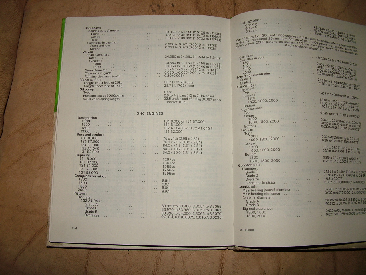

I don't have much detail on 2.0 litre Fiat 124.
Found this in old DIY manual that lists the 1995cc engine as well as the smaller engines. Do the bore and stroke sizes match?

Hi thanks for the info, as mentioned the bottom block is coded 132 0b 2a and this is currently on a carburettor fed head, my head is injection fed and it’s bottom block code is 132 AC 40/9 … I cannot locate enough info on the various parts co’s websites to suggest I can swap the bottom blocks over in a direct swap …anyone know if they will be able to be switched?
Irrespective of the engine code all 2000 blocks are the same. they are all interchangeable as are the heads. Are you reading the codes from the block casting or the engine number stamping ? I cannot seem to find a reference for 132 0B 2A but there was a 132 DB but that was for the Volumex supercharged cars. I believe the 132 AC Block is an 1800. These share the same bore as the 2000 but will not be as tall. you can fit an 1800 head to a 2 litre and vice versa. The casting code on the top of the head will tell you what valve sizes you have.
Hi thanks for the update, the codes were taken from the bottom blocks, I think it could be a 132 db rather than 132 ob but thanks for confirming they should be ok to swap over.
Yes… as mentioned the 132 block can be used with your existing Injection head to retain the existing L-Jetronic system. I have a Strada 130 (138AR) engine running the L-Jetronic system fitted in my Spider. Hope that helps.
