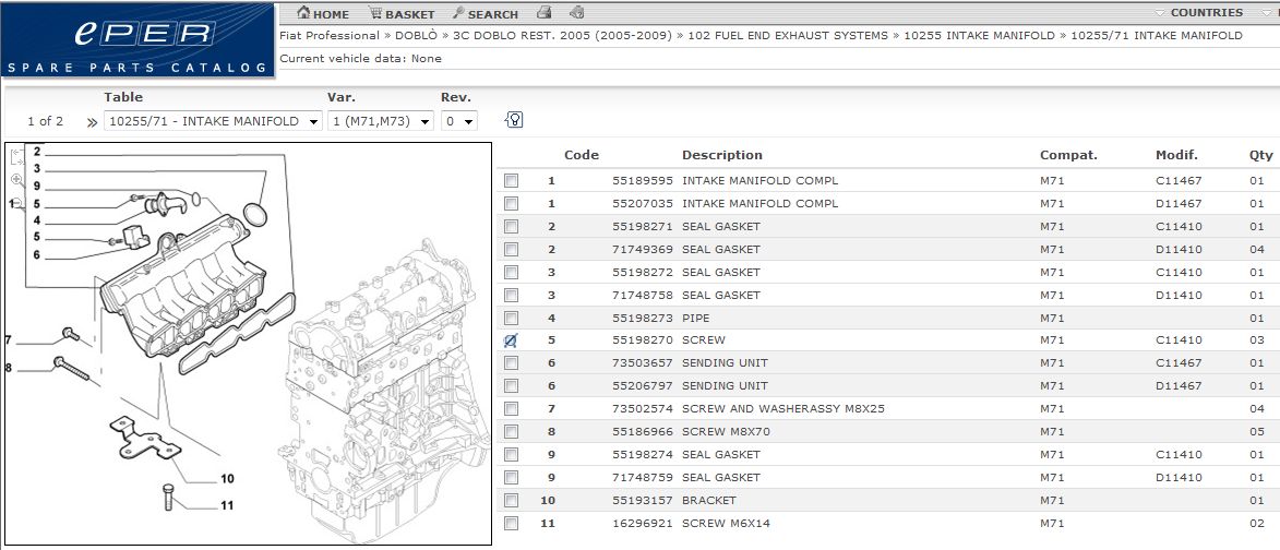

I've never seen a 1.3MJTD but I suspect the MAP sensor is item #6 on this diagram.
