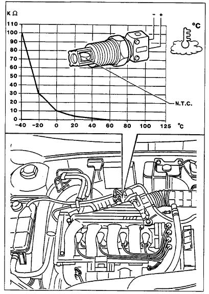

you can test the air temp sensor, the attached pic shows a graph so you know what resistance to expect at any given temp. i would test the resistance at a couple of temperatures. for example, i'd expect 10kohms at 0C and 4.5kohms at 20C (approx). a faulty sensor will usually show very little resistance, or an open circuit. if the resistance seems correct, it means the idle speed control valve actuator is not moving as it should. this is basically just a small rod on a motor, so its easy to clean or replace.

Thanks, i have a access to a temp test fixture for clima testing electronics at work, i will check it soon, and let you know how it turns out.
It's a simpel NTC, so it can't be very expensive to replace.

I have tested the air temp sensor today, all measures were slightly below the
specified values.
At -20C the value is 24K instead of 30K.
At 0C the value is 8K instead of 10K.
At 20C the value is 3K1 instead of 4K5.
I don't know the tolerence of this NTC, it follows the graph but some Kohms below.
This leads the ECU to think the air temp is approx 8C warmer than it really is.
Do you think that this causes the problem? :confused:
A sollution could be coupling a 2K2 resistor in series with the sensor.:idea:
