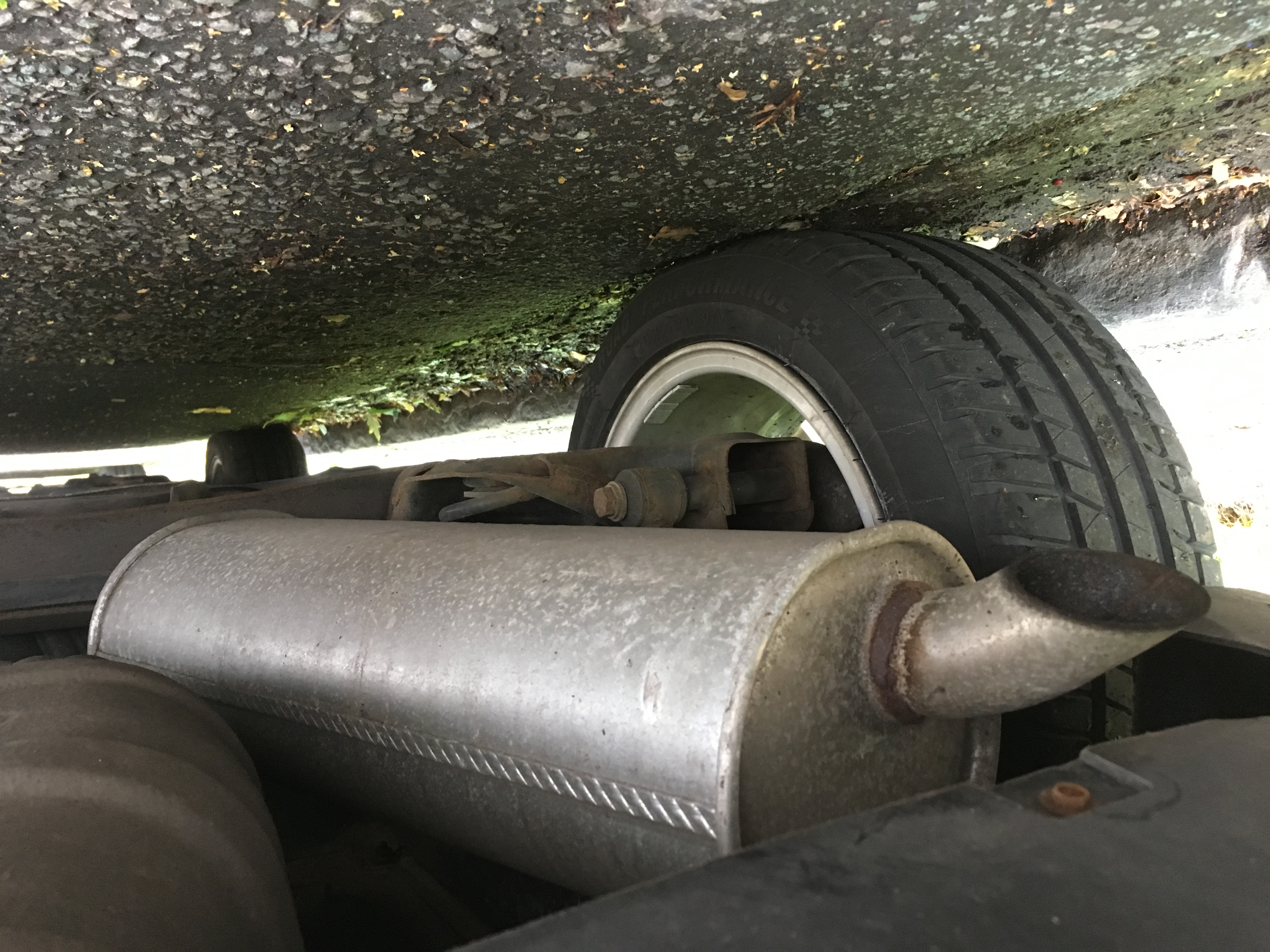

Can you post some pics of the rear of the car (exhaust) - take a pic from under neath the back if you can.
Someone will be able to tell you if its a different exhaust.
Other than that - more importantly, it could have tiny holes in it and it might be blowing, does it sound very raspy?

It actually sounds ok maybe I'm not used to noisy cars had a focus previously.

Anyway - your backbox looks like a genuine OEM one so its not an upgraded one.
Only other thing it could be if its louder than normal is a hole somewhere in the system - the top of the backboxes tend get holes in as easy as the bottom side does.
Run your hands round the hole area of the backbox with the engine running and you might feel hot air coming out of any holes - that would be the first thing to check... then check gaskets around flanges etc where the middle connects to the downpipe / cat etc.

Try looking at the aluminium heat shieldsbaffles on the exhaust. These tend to split at the boltheads and it then becomes loose and rasps . There are other aluminium shields , one at the middle and one at the rear of the car , these can sometimes rattle against the exhust itself. They are very flexible and can easily be distorted if driving over long grass or through water. Easily bent back if you can get underneath.
