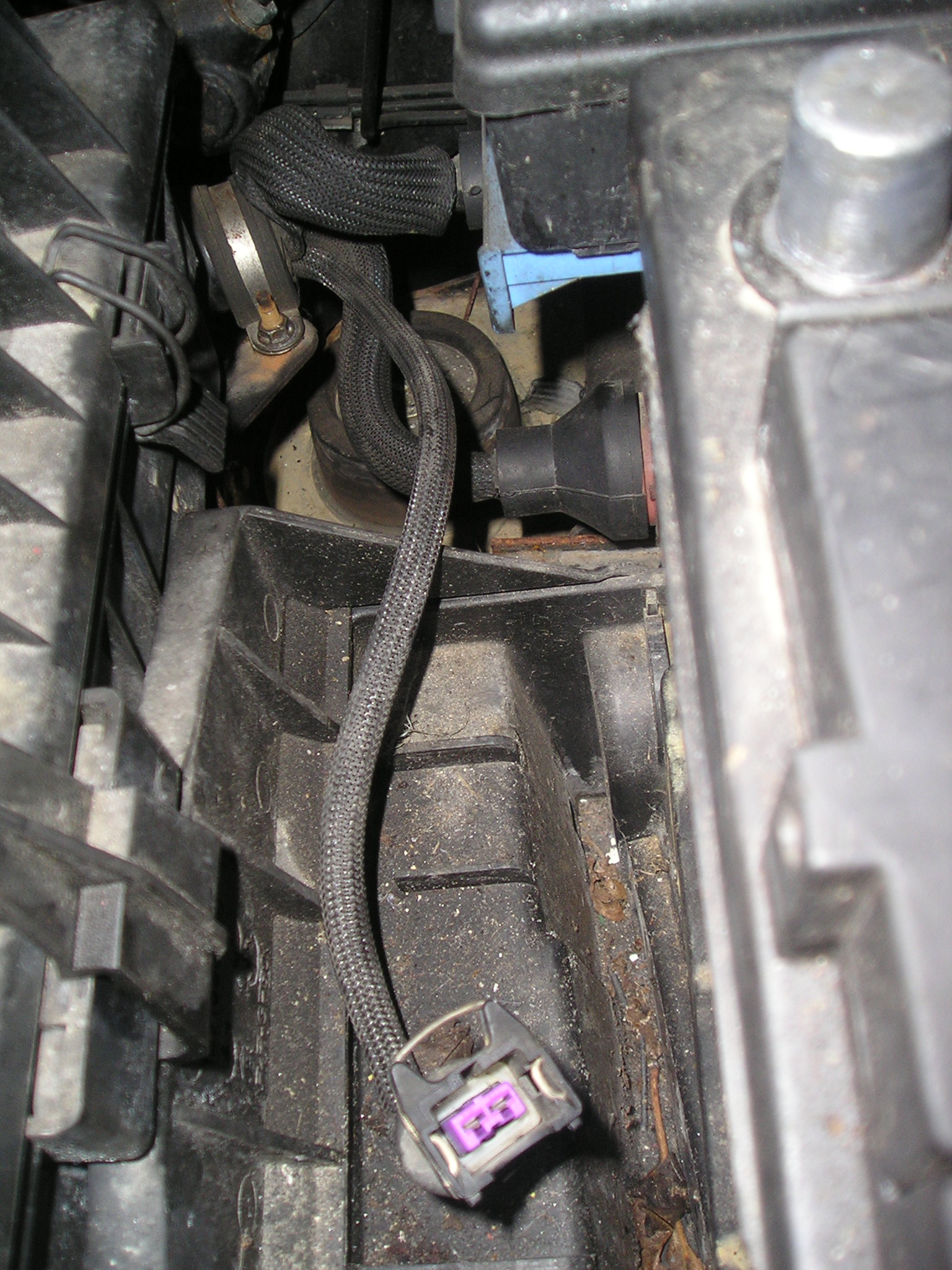

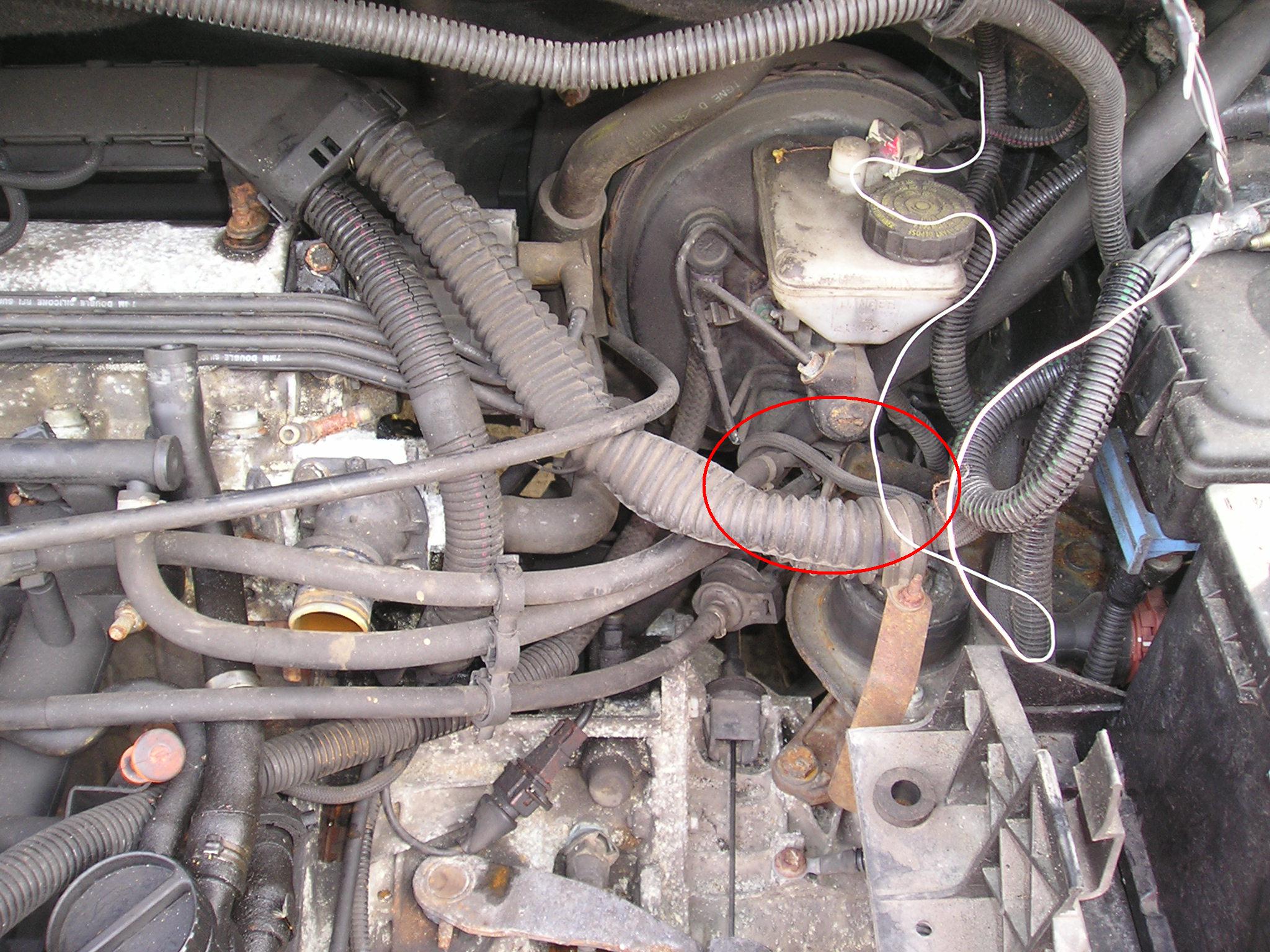

... Hello Guys,
I have just had the engine changed over from my old 'P' reg Ulysse to my recently purchased 'N' reg Ulysse.
Both are 2.0L Petrol (Manual).
There is one connector that we cannot find where to connect to (Even though I took photos of the en
gine wiring from before removing the harness in the engine compartment).
The connector that I am referring to is a black plug and Purple/lilac inside (Please see attachments). It come from the same harness as one of the two round, screw on plugs that attach to the side, by the fusebox in the engine compartment.
The engine turns but does not fire. I can't even here the "Pump" noise when I turn the ignition on (If you know what I mean?). It is either that my current Ulysse ('V' Reg) is a noisy thing? lol.
As always, Your help is apprectiated.
Many Thanks,
Welshy.
PS. It wouldn't be because we disconnected the ECU, would it?! - I don't think so, but you never know.

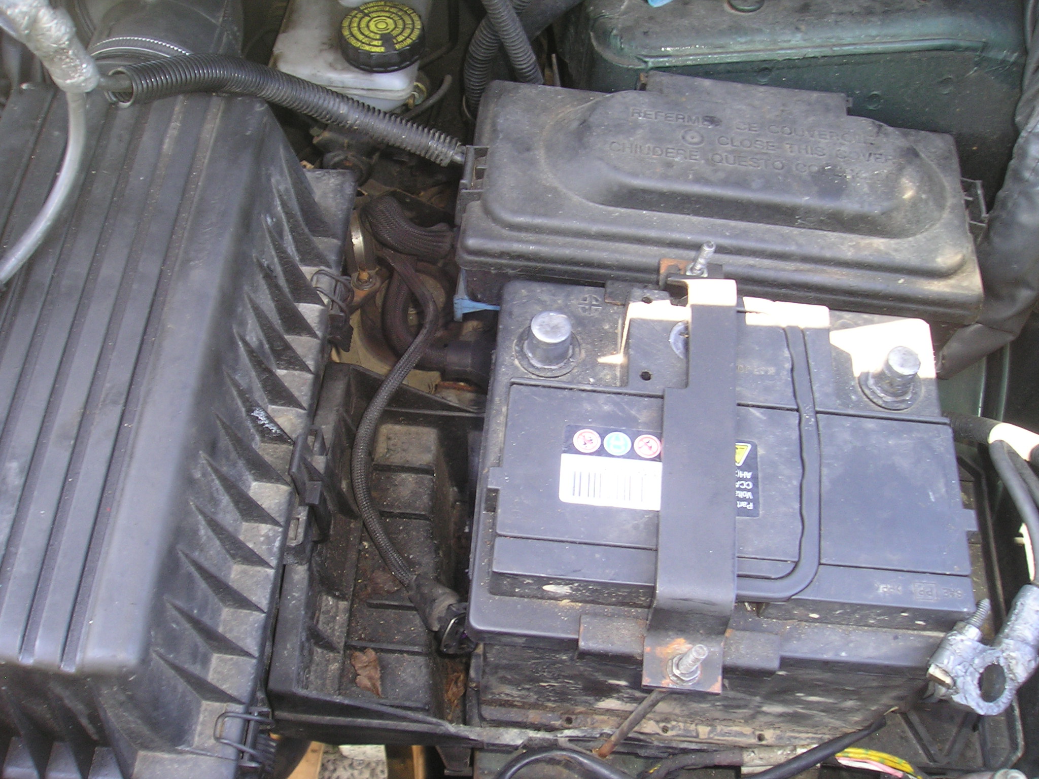

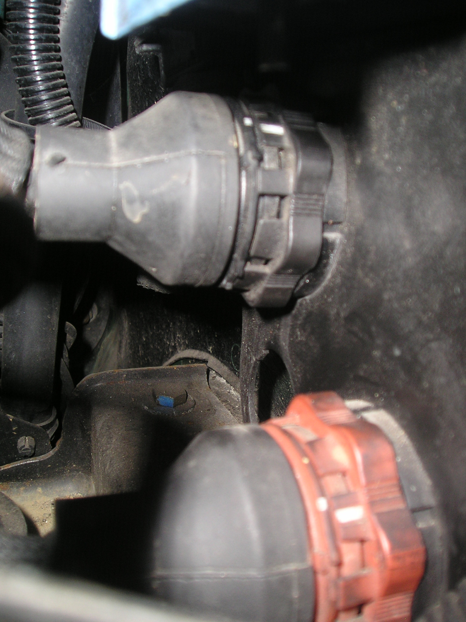

These are the pics that I meant to add to the first OP.
The ones in the OP and the same cable(s) that were connected in the car before I stripped it. :( It shows the direction, but show the connection.
My Brother-In-Law and I, can't find anywhere where it goes.

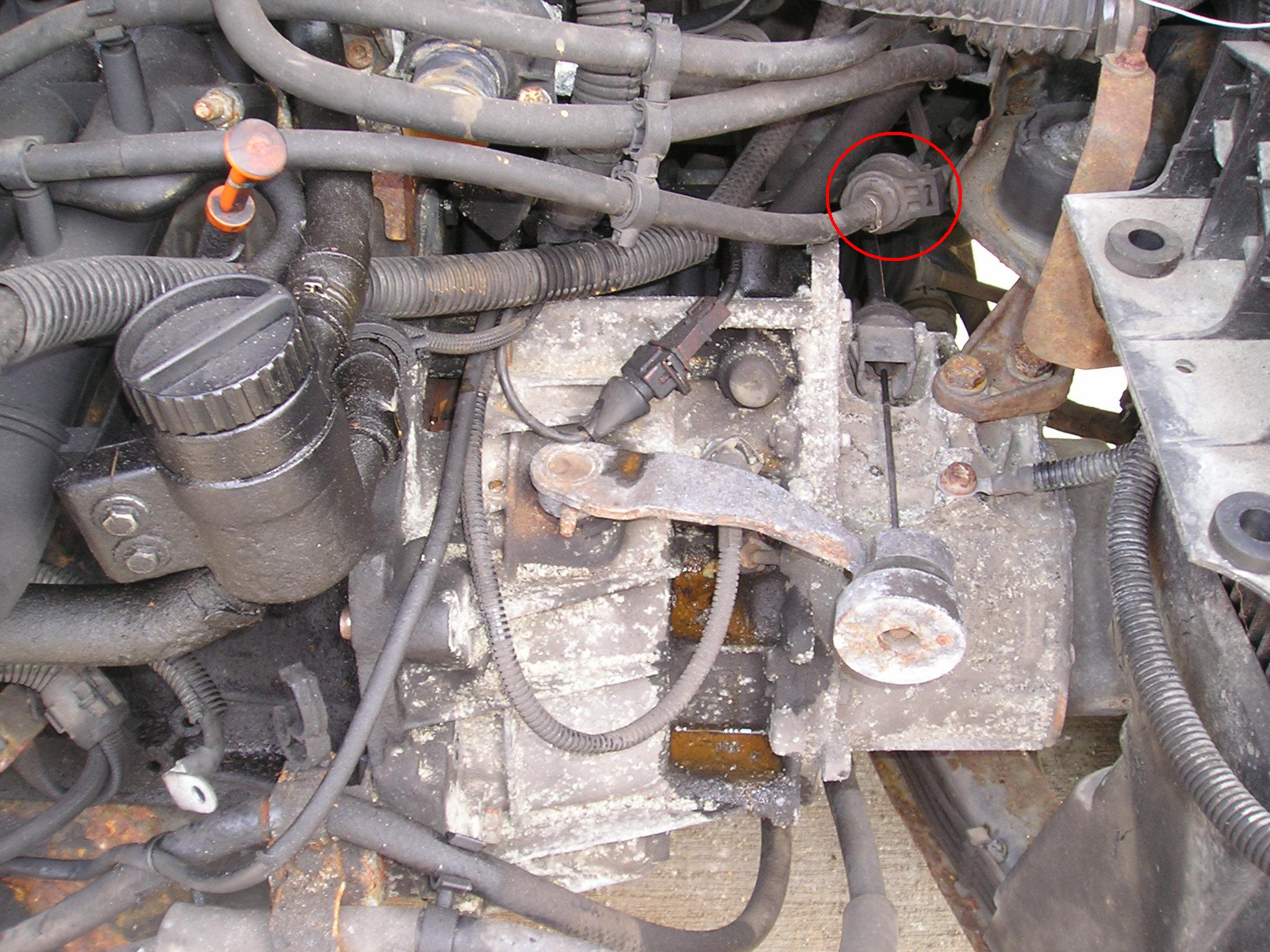

I have found the place where that connector goes. It goes to the fuel pump? that is circled in the attachment, below.
It is fair to say that we have made an error in the connection of some of the wires.
** UPDATE **
I forgot to mention that there was no "Oil Light" and "Engine Management Light" on, when ignition was on...
Anyway, I swapped the connector, mentioned in the above post and the other connector (White with purple insert) went on the oil switch on the engine - Job done, It starts.
