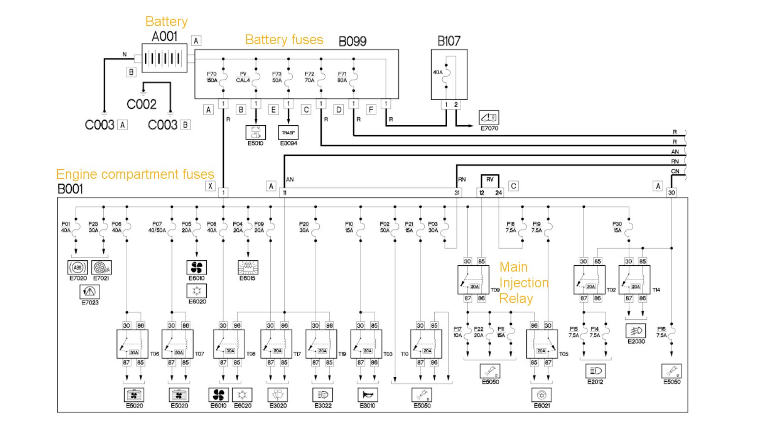

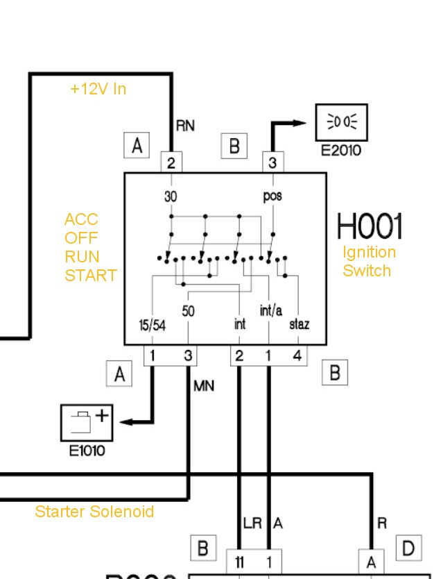

To add to the above, see attached diagram of ECU power supply etc.
Hi Sionnaigh
Sorry to hear of your frustrations
I know that as a retired electronic engineer I am biased, but your problem could be electrical in nature. Problems with the air or fuel supply normally show up as rough running albeit briefly, but a sudden and complete failure of engine power suggests to me that for whatever reason the injectors are suddenly and temporarily not getting the command to function. There is also the suggestion that movement of the engine on its mounts on winding roads and with torque changes during gear changing may be triggering the issue.
If the fuel pressure drops below a threshold the engine will be cut off to protect it, but this will normally throw a fault code.
I suggest as a first step that you remove and replace the three fuses ( F17, F22 and F11 ) that supply the ECU, in case there is corrosion and tarnish in the fuseholders giving high resistance and voltage drop. A squirt of switch cleaner and pulling them in and out a few times may clean them up if there is no obvious sign of corrosion. The ECU can tolerate some voltage drop (it has to work during severe cold starts) but if the voltage dips too low it won't function. The ECU supplies the injectors which take a fair old current spike each time they actuate, so connections must be good.
Secondly, unless the gearbox to chassis ground strap has been replaced within the last few years I'd recommend fitting a brand new one, cleaning up the mounting points to bright metal when the old strap is off. These straps are notorious for corroding internally and going high resistance. By high I mean more than about one thousandth of an ohm, so forget about trying to test with ordinary multimeters etc, they will show good when in fact the strap is bad.
Since things come good after restarting, it would seem unlikely that a cable is shorting to ground as that would blow a fuse. However it's possible that a very brief short would allow any fuse to "ride through" and not have time to blow. A connection that is going high resistance or open circuit seems more likely. I guess you will have to do a detailed wiring inspection and bend and tug the looms with the engine running to see if you can provoke the fault, as already suggested.
I hope you get this sorted, it might turn out to be not electrical but that's the peril of armchair diagnosis !
