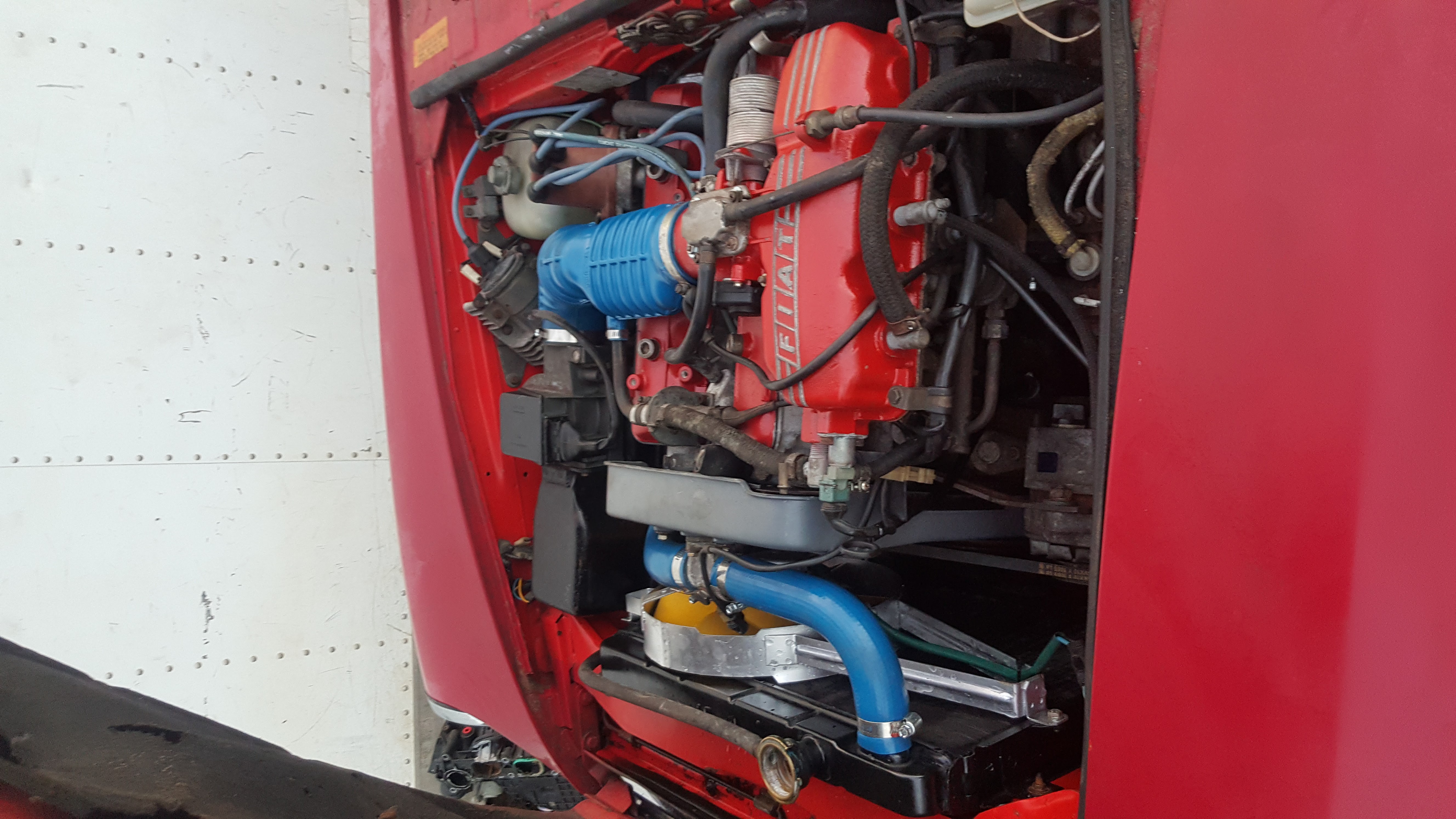

Ref: My 1984 Fiat 124 Spider manual 5 speed trans fuel injected 4 cylinder DOHC. 51K original miles.
Early morning start is perfect. Driving up the street engine runs perfect. Driving up the highway for a test drive, car runs very smoothly. Upon my return from a short trip of about 10 miles back and reach traffic in town, engine starts missing especially when idling or coming to a stop at the speed bumps. I would have to keep the pedal pressed at a higher RPM for it not to shut down.
However, my timing with my foot on the pedal in heavy traffic may cause the engine to shut down. Once it shuts down, it would not start. Engine would just crank and crank and turn but never starts. It would only start if I leave the engine off to cool off after about 15 minutes. It would start perfectly fine after that and the cycle starts over by driving good for a short while and starts with the same problem after the engine warms up in traffic.

Okay I finally found the problem along with my mechanic. The Mass air flow sensor switch was causing the problem. There was some slight adjustment made to it. It has part of the surface worn out where the copper needle passes over at the bottom end where pointed in the attached picture. In the interim, the needle was adjusted a bit for it not to reach all the way down. Since then the engine runs a lot smoother, and when it's hot it does not shut down. It still misses a bit when hot but does not shut down. I will need to get this replaced.
Regards,
Mike
See attachment.
https://www.dropbox.com/s/ukc10nmh7reqtpy/84_Fiat_spider_Mass_Air_Flow.png?dl=0
