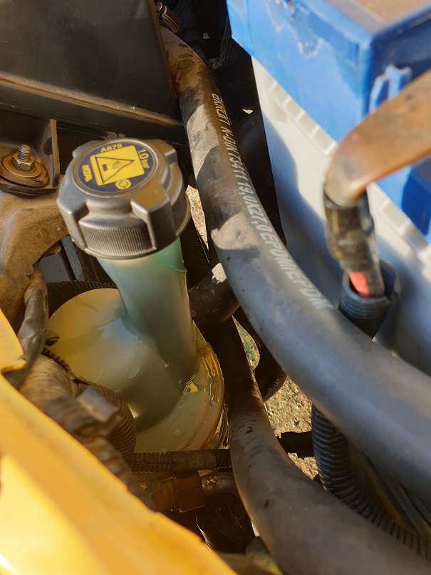

Symptom is when the car is at half temp, coolant begins to rise up the tank and get pressurized like this:
attachment.php

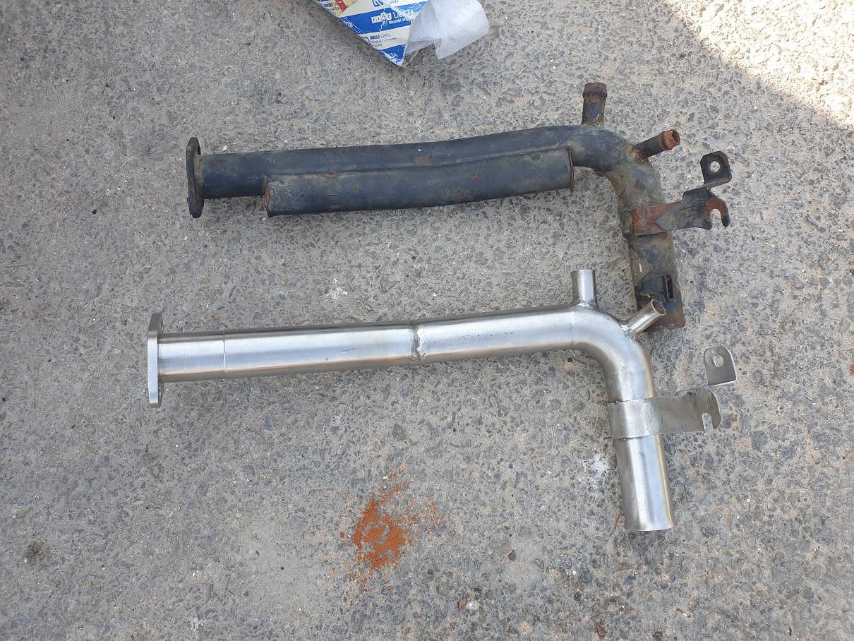

I already changed the metal pipe from the water pump to the radiator
the old one didn't leak but still overheating.

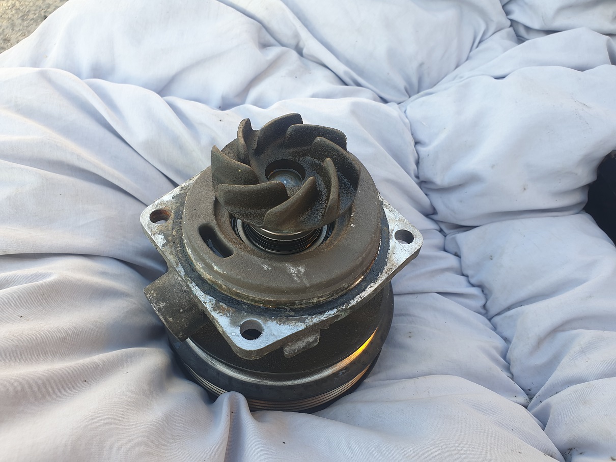

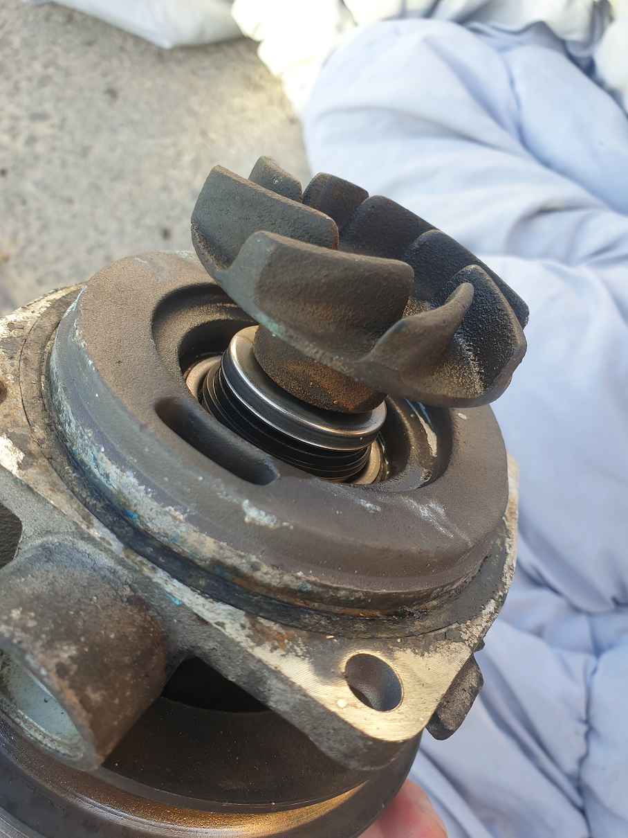

I have removed the water pump today.
it is 7 years old BUT, it look fairly new. and it has iron blades and not plastic.
I will put a new pump but I think it can last many years.

Yes, the water pump do last years and yours looks in good gondition and considering you do have pressure in the system, I'd say it works just fine, does not need a replacement.

Yes, that is true about lifting the front end of the car. And after topping the system while cold, you should start the engine (front end higher) keep the radiator cap open and let it run about 5 mins. Then stop the engine and open again the valves for bleeding (or the one valve in your case, if you say the heater matrix is disconnected), carefully because is hot. That steam you get is the air in the system, open the valve and wait until water comes out, then close the valve. If no water comes out, top it up, it will come, and after that, if the level is above max, take out what is above max.
Also, one other thing: make sure that the valve on the radiator's cap is functional and can open up, even if the cap is new (it can be stuck). It should open on pressure higher than 1 bar (it is clearly written on it so). So if you blow on the valve, you should feel the air coming through the gaps between thread.

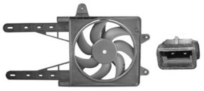

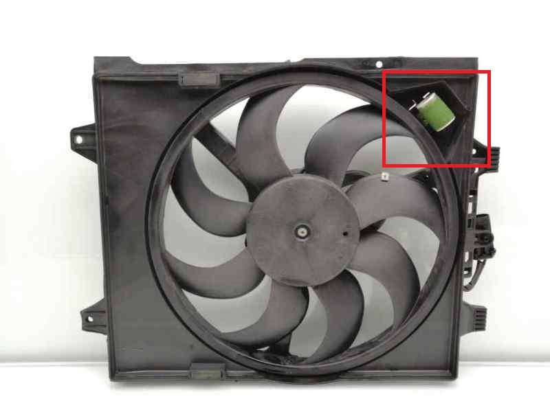

And a question about the radiator's fan: is it really 1 speed fan, or is it's thermic fuse (on nr 1 sped) blown and the fan only works on the 2nd speed therefore the pressure is higher than normal? Check under the fans's connectors if there are 2 lines and that thermic fuse.
Yes it's 1 speed only fan.
attachment.php
I assume you mean this:
attachment.php
Mine doesn't have this piece.

Yes, that one I ment.
Then, you should do the proper bleeding.

One more question about the radiator cap: does it have the gasket inside, the one ment to stop the coolant getting out, like in your first picture above? And also, is it properly tide?
yes it is.
I have tried with 2 new caps and the same.

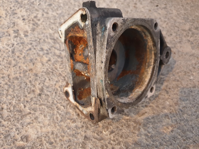

Also removed the water pump base to the block today.
It is a bit rusty, probably never changed. I don't think it's the reason.
Will replace that as well.
attachment.php

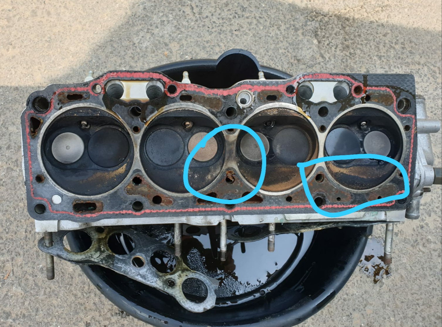

I removed the head today
I will get it to the workshop to skim it.
How does the block look?
What should I clean it with?
Sand paper? Scotch brite?
Search the forum, here or in the Mk2 area, people have done that and posted about it. If you use sand paper, it must be very very fine granulated. And it looks like you' put silicone before, to the gasket (or your mechanic did), usually to th HG you don't put silicone. As I've mentioned, check some other topics, you must find it nicely described, on this forum, with every step, what to pay attention to and all.
