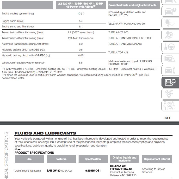

Can anyone tell me what type of engine oil is required for 2023 fiat ducato 2.2 140 .As I do very low miles I am thinking of changing the engine oil and filter every 12 months instead of waiting for the 2yr service time. Thanks Steve
Fiat's handbook for the Series 8 Jeep-derived 2.2 says the same Selenia WR Forward 0w30 to Fiat 9.55535-DS1 as the earlier Euro6 2.3 engine.
