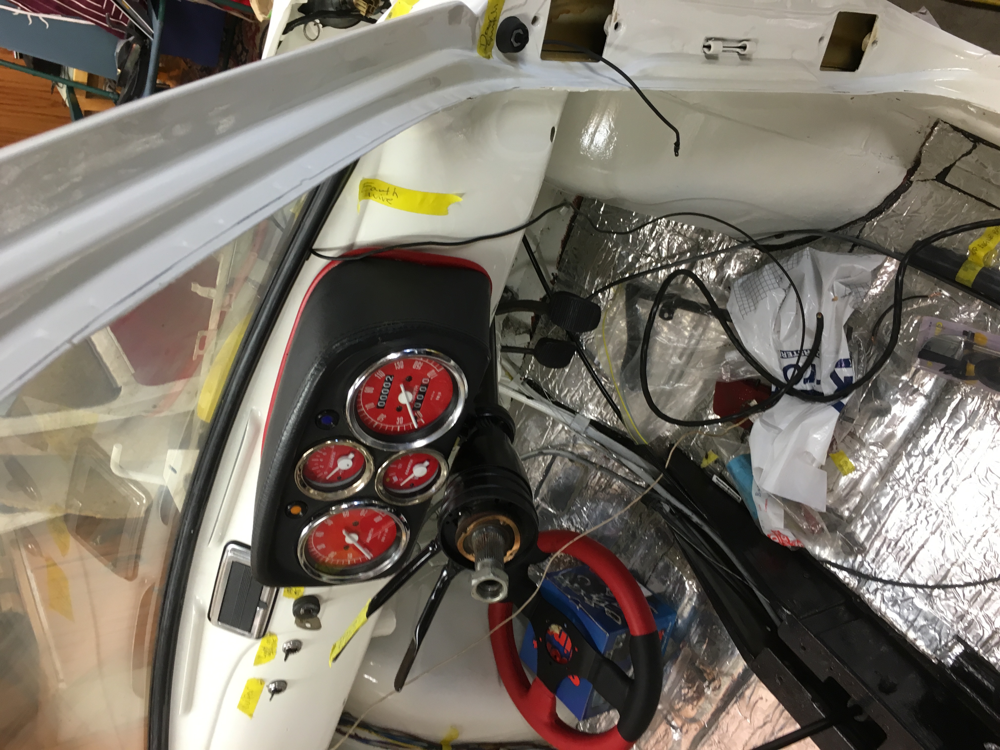

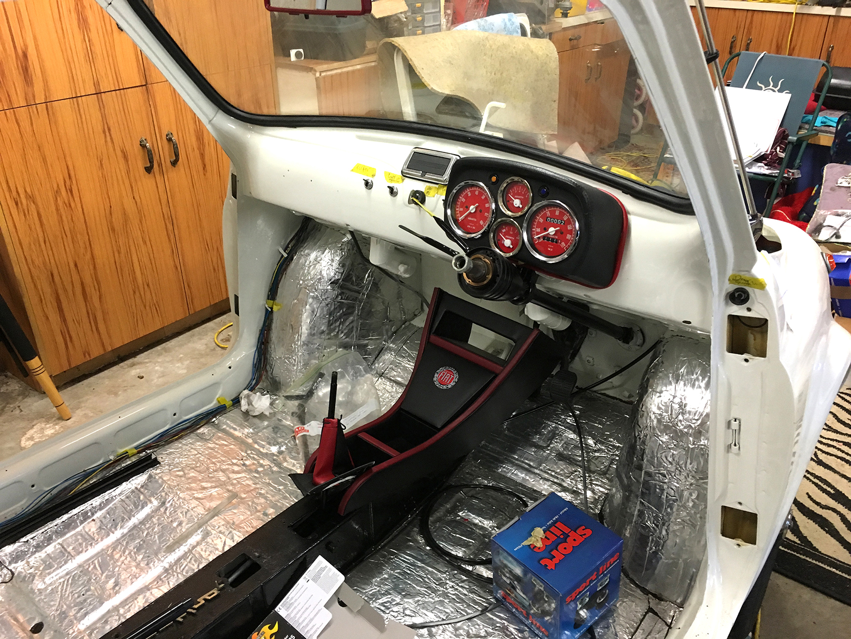

I put sound deadening just about everywhere I could think of. Even a bit in the doors – just the bits left over there.
A couple of pics suppled, but it was certainly behind the back seat and on the parcel shelf too. A Dynamat type product (but cheaper).

Hi.I drove my 500 l for the first time to the MOT station with no interior apart from front
seats and OH what a racket.I thought I had better get on top of tis by putting
in all the insulation I could think of.I used the stick on antivibration mats
everywhere. Then I stuffed rockwoll into the seat base ,the sides of the back seat
and extra behind the seat back.I then went to town on the floor in a similar fashion and OH what a difference Just finishing off my mini the the fiat back in the garage to put on a steering rack instead of the box.I will post progress on here with photos when I get around to it.
