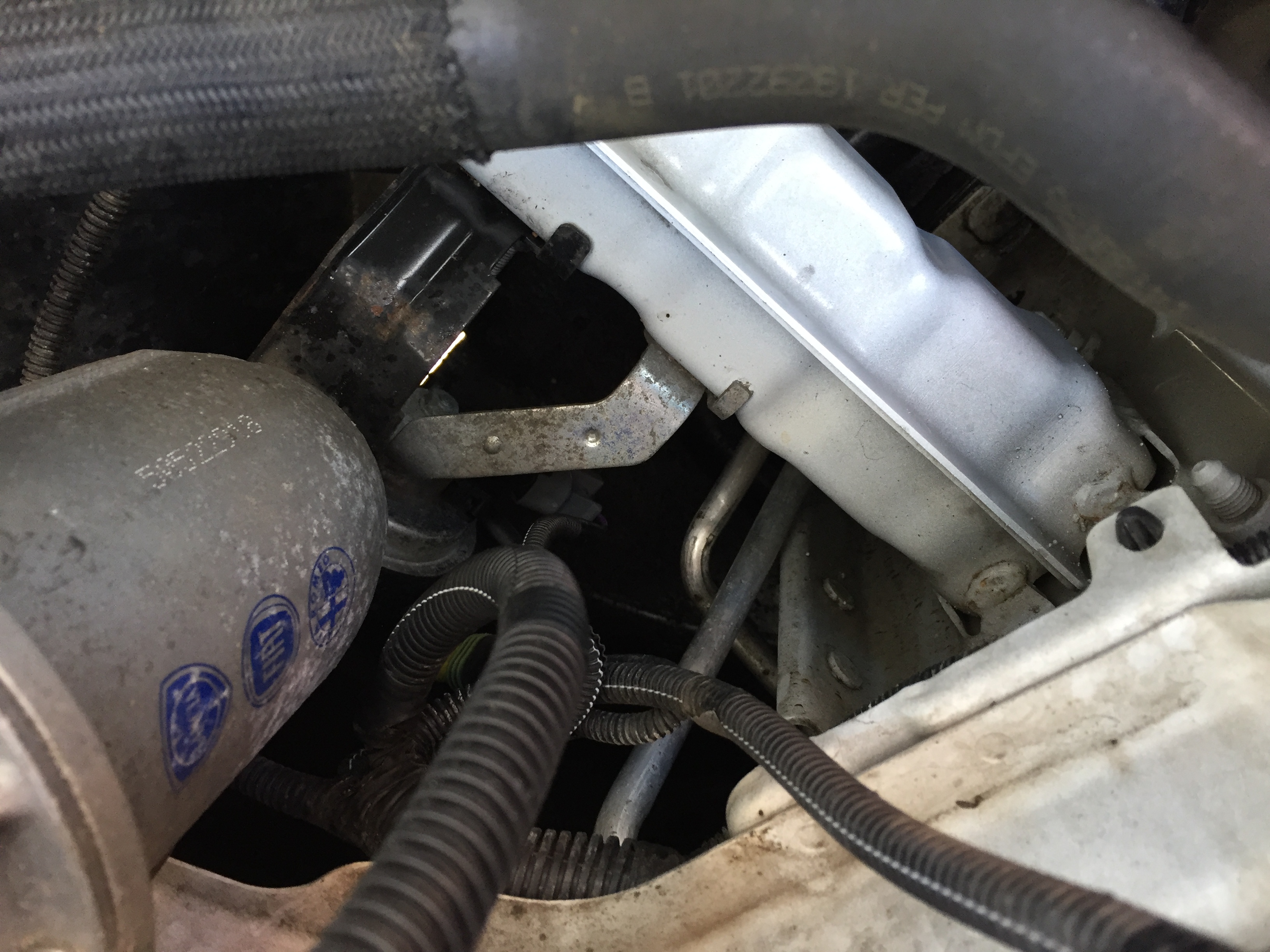

I have attached a photo and it looks like the leak is from the silver curved pipe in the centre of the pic as it’s dripping directly below the grey rectangular box,
Thanks Dean

The problem with a close-up, is that without a similar vehicle to look at, there is no context.
Leak 'from' the pipe. Is it dripping off, or is there definitely a hole in the pipe. It could just be a conduit for the fluid to run along.
Follow the pipe upwards to find what it is attached to, and where the fluid is coming from. That'd be more useful.
Brake fluid is a possibility. Might just be overflow, if the pads have been replaced, caliper pistons pushed back, and fluid expelled into reservoir and overflowed.
