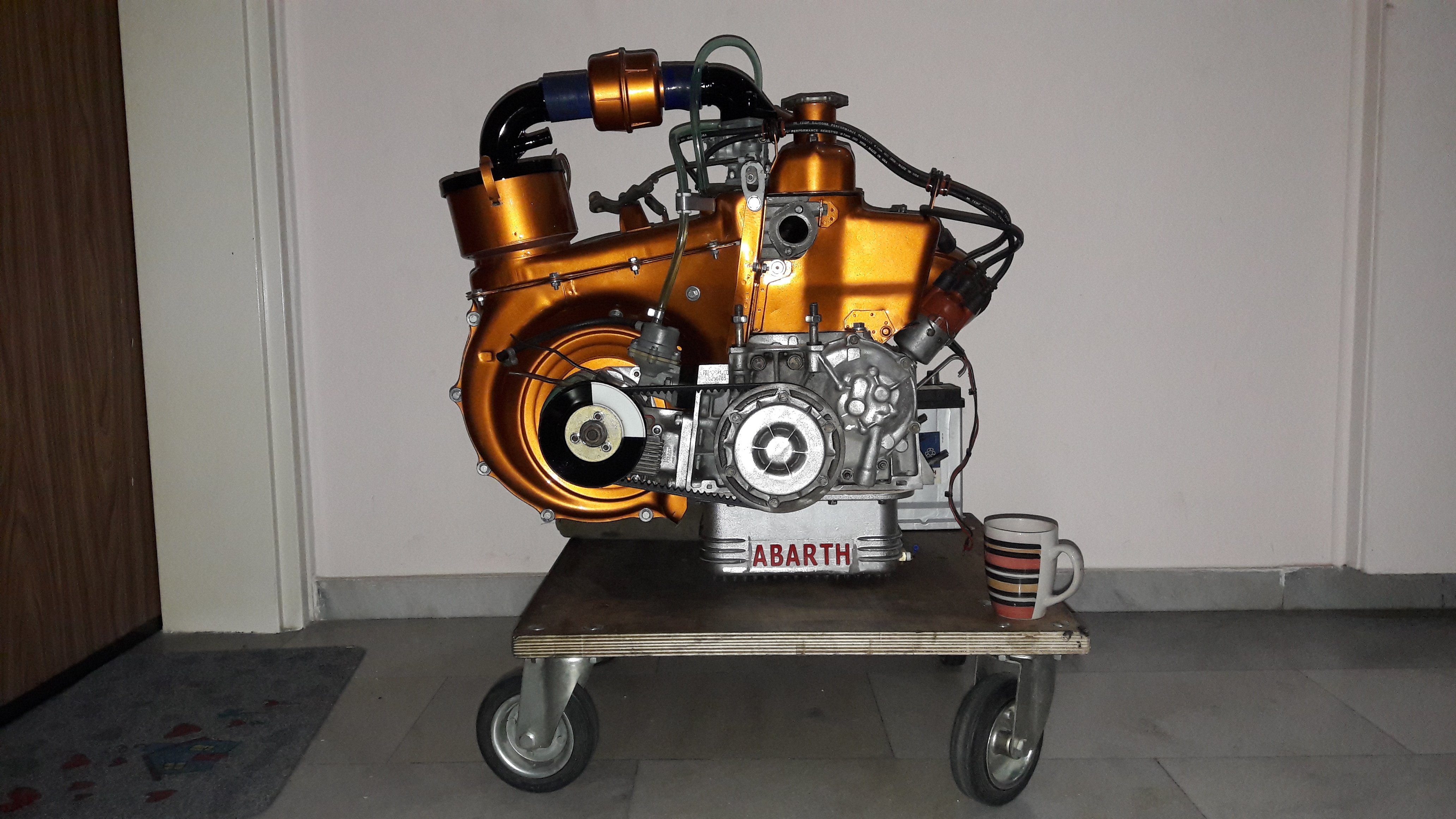

I had this wood platform build and put it under the engine, then lift it with my hydraulic jack just to take the weight, disconnect the engine and then lower the platform, drive it to the elevator, second floor and inside our living room:D

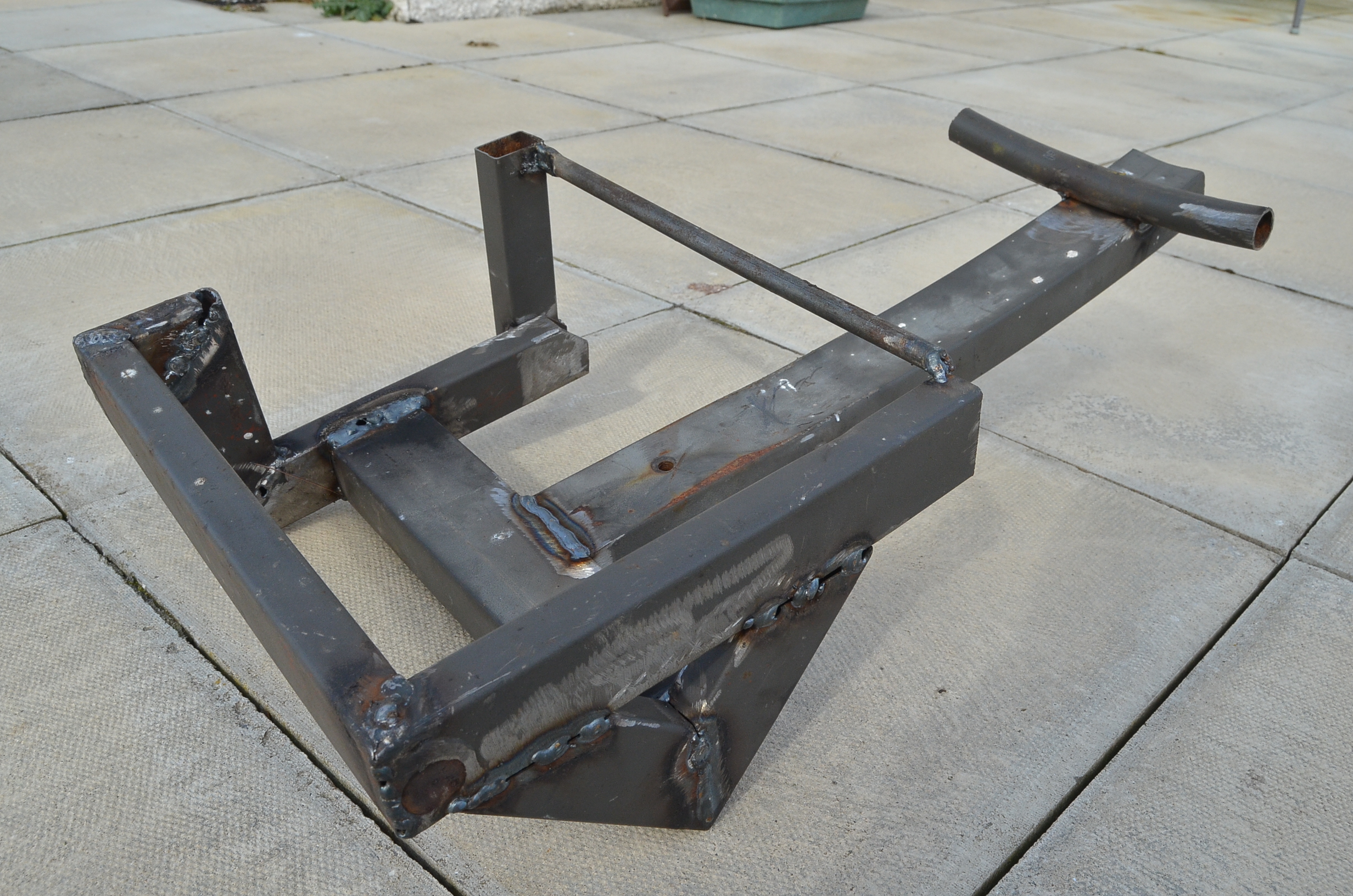

I liked everyones' ideas preceding this and was always envious of the devices for engine removal. Now that I have a traditional, old man's buggered-back, some method to lighten the load is essential. We had an ancient garden hanging-seat which I had stripped for its metal tubes and it was this that gave me inspiration for a contraption. A couple of years ago I bought a heavy-duty trolley-jack with a removable cup; I call it Theresa because it's strong and very stable. :D The frame I have made has a spigot which is welded underneath (not visible in the image). This is at the centre of gravity of the combined engine and gearbox and which fits into the swivel-hole on the trolley-jack.
Basically it is tailored to fit over the engine-sump, with an outrigger to support the gearbox. I prefer to remove the two components as a lump but a slight adaptation would allow me to retrieve the engine alone.
As yet it's not been used, but i'll report back if it works succesfully or if it fails.

I share your opinion. Using the engine-holdr I referred to earlier the operation was lacking the trauma that has previously accompanied having 100kg of machinery wobbling on jacks/blocks etc. My fittting will need some further adjustments as the rear support for the gearbox needs to be removable if you want to detach the gearbox from the engine.
Also, the generator side of the engine, when assembled, is somewhat more out of balance with the exhaust side than I expected, so I might move the pivot point slightly to the left.

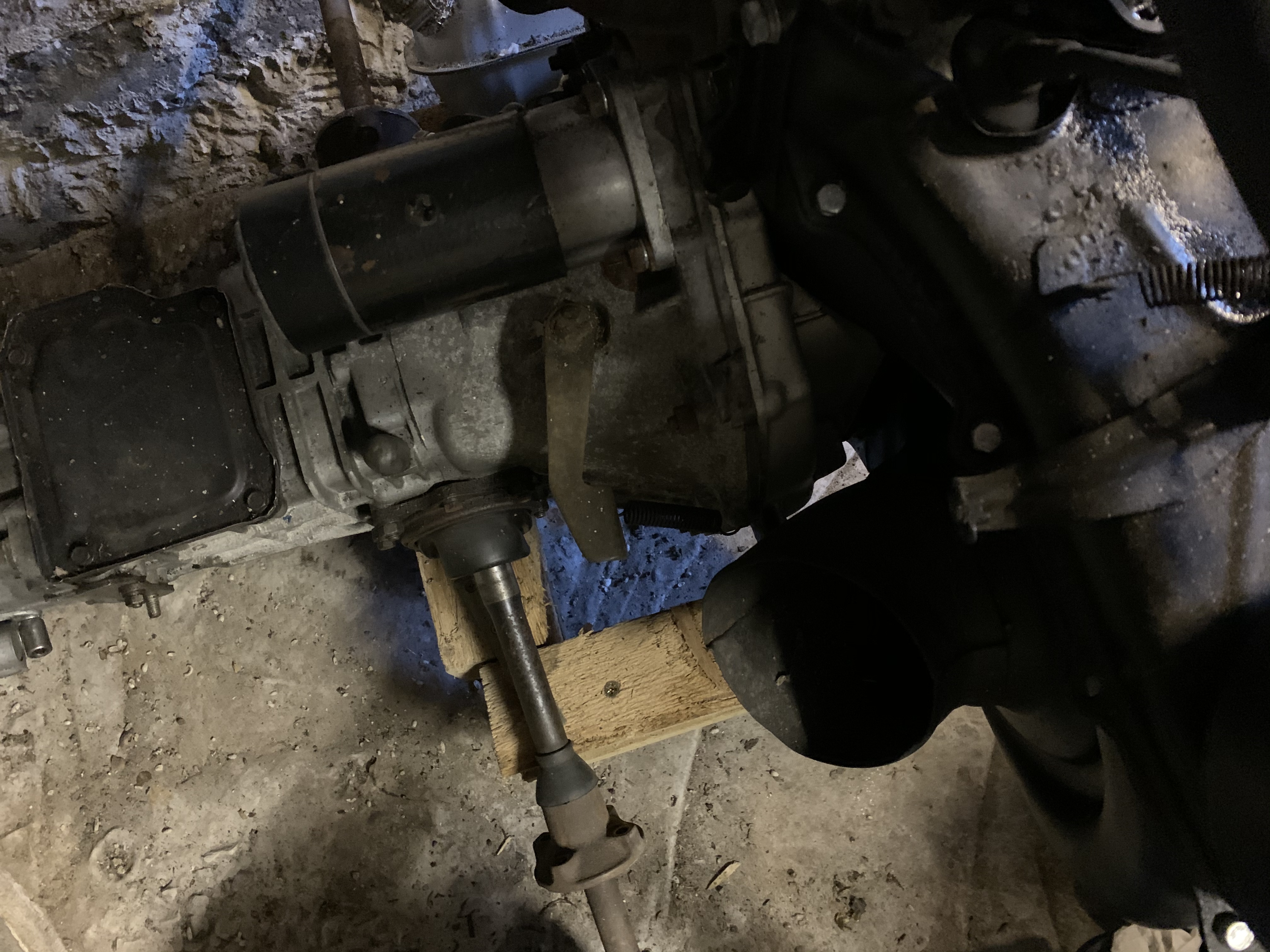

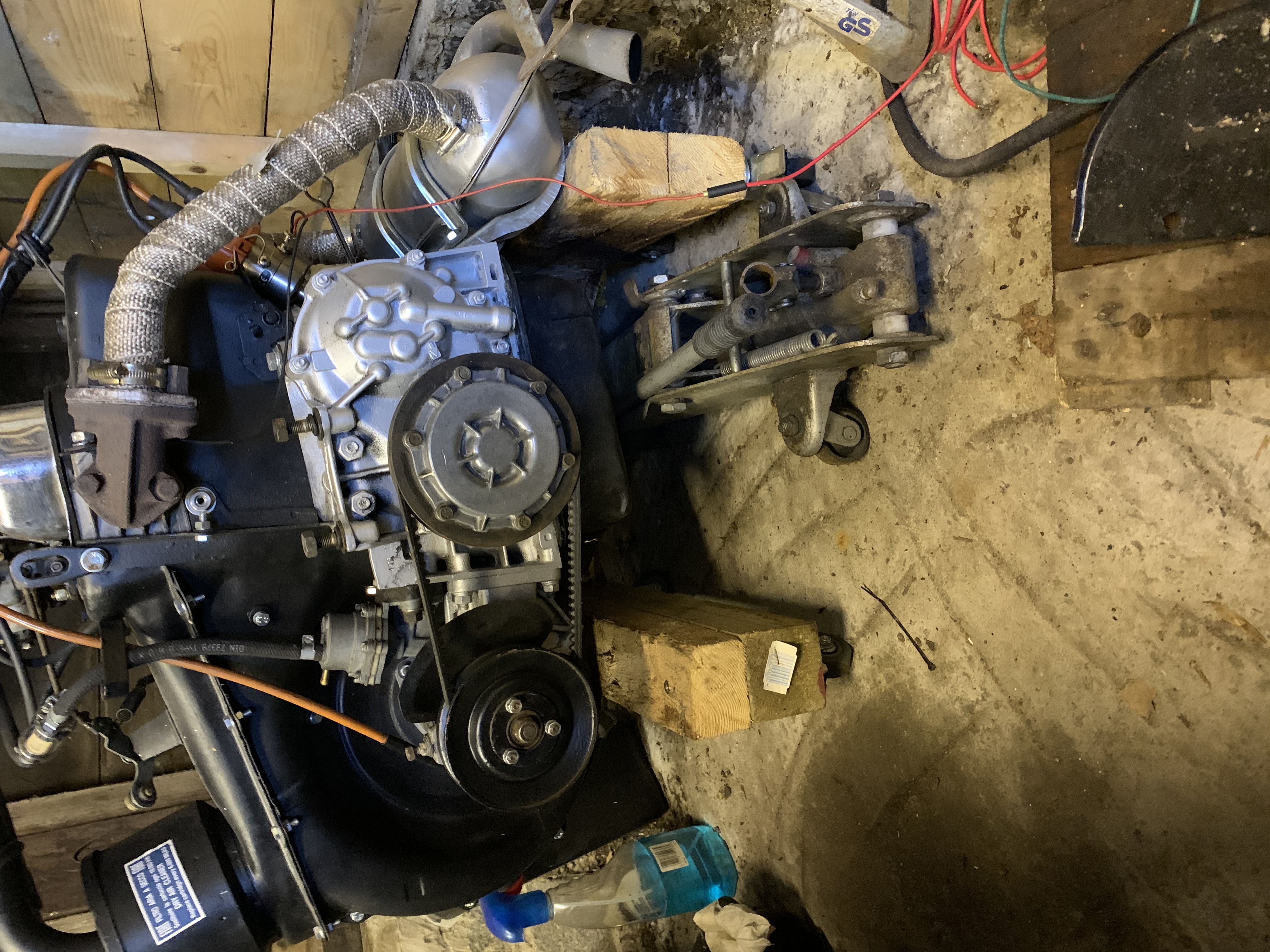

Mines not as sophisticated as Peter’s but it does have wheels!! It’s in a ‘U’ shape so you can slide the jack in and out and is long enough so that you can get the jack on the balance point, which is pretty much on the bell housing if I recall?
That looks remarkably like my in/out device---even to building up the sides with whatever was lying about!
