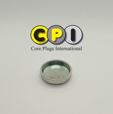

Plugs on block are:
7 off P/N:14329101 - 30mm diameter
1 off P/N:55184492 - 14mm diameter
These are commonly used on most Fiats, are available from Fiat at around £2 UK each
Thanks a lot for the information.
Could you please confirm me that which material is the best for block plugs ie. Stainless steel, Bronze or Zinc coated mild steel?
If you have any idea about a UK seller please send me details for making an online purchase.
Stay safe you all.
Have not purchased or replaced a core plug since the 1970s .... a long tome ago.
Standard steel are OK but you must have antifreeze with anti-corrosion properties. Our Strada is 34 years old with original Fiat steel core plugs and no problems. You can use stainless or brass if you want.
