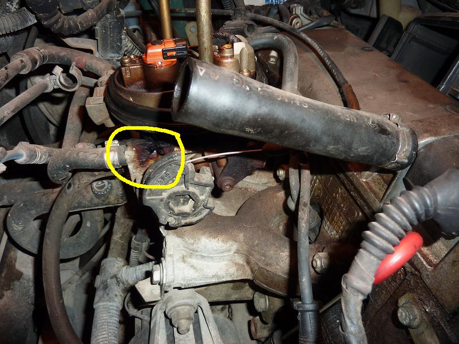

is it just me or it looks like its burned?
I think it is just oil that has leached back from a leak in the rocker box gasket and presumably has roasted over time just sitting there.

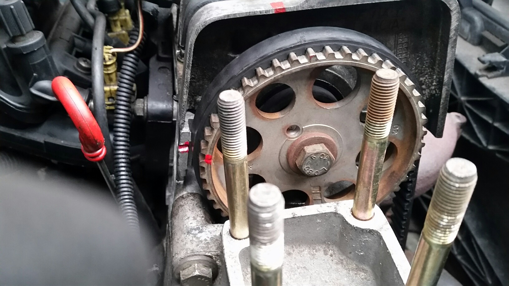

fastest way to check timing, align it with the big mark on right and then check if it aligns with the notch on timing belt side
attachment.php
attachment.php
well if you have fuel and spark then really for it not too actually run you must not have fuel and/or spark at the right time... so yeah, check the timing properly, wouldn't be the first time one of these had jumped a few teeth - one or two teeth and it will generally run but just not as well after that its too far out to run at all.
