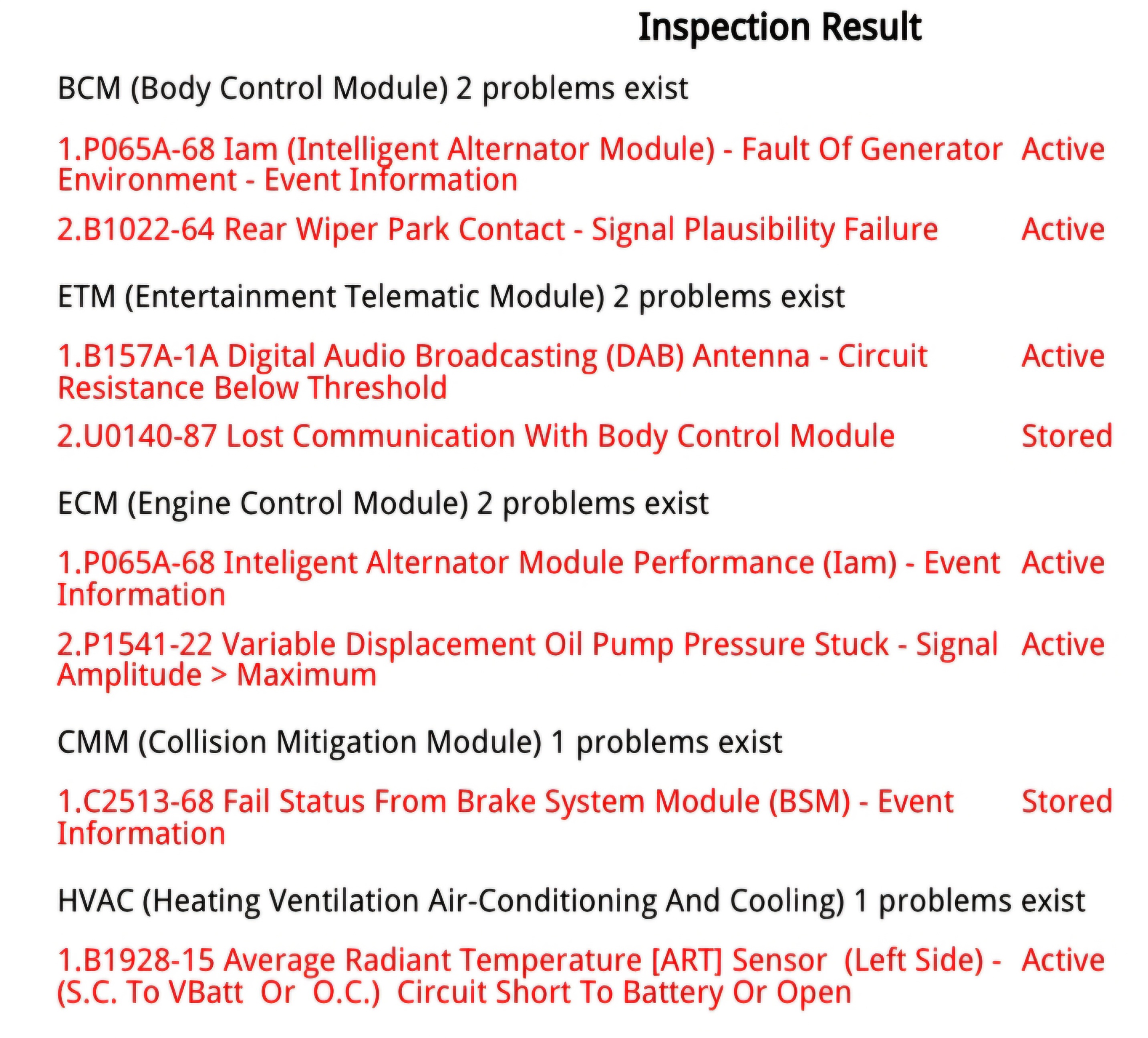

The codes im getting on a scanner are:
P0658-6A : intelligent alternator module performance.
P1541-22 : variable displacement oil pump pressure stuck - signal amplitude > maximum.
B1928-15 : average radiant temperature sensor (left side) short circuit to battery or open circuit.
B1022-64 : rear wiper park contact - signal plausibility failure.
