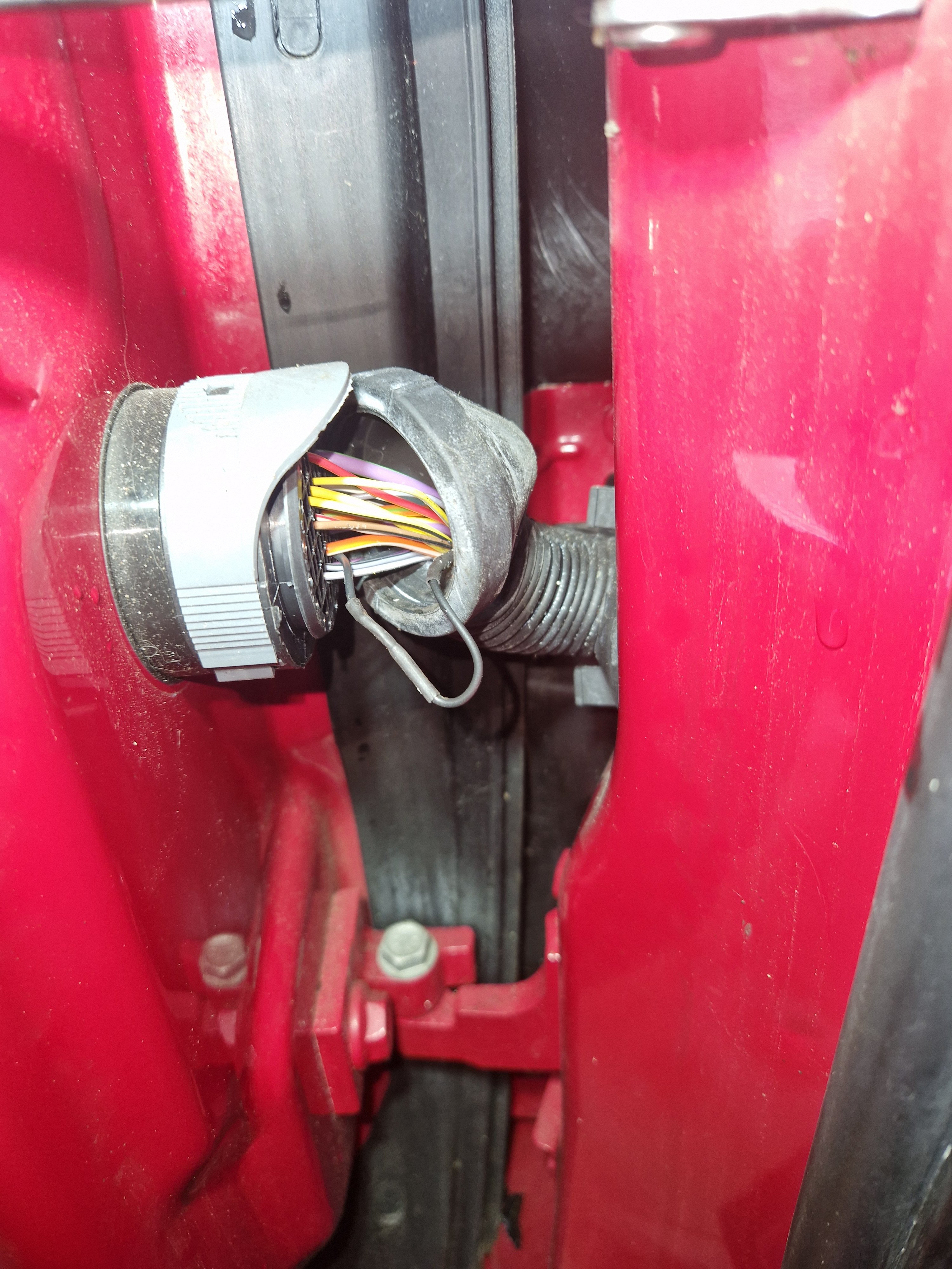

I've got the same problem on a 2014 500L
traced the problem to a broken black wire in the passanger door loom in the rubber boot that goes from the door to the a post
