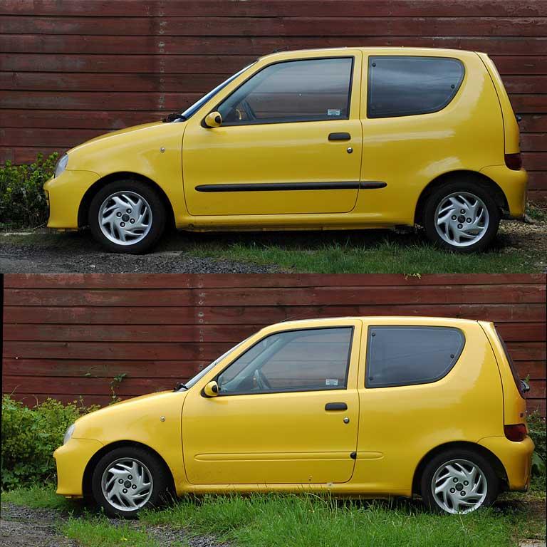

And here is a picture for people who want to now, the top with Eibach the bottom with Weitec (with about 1/3 a tank of fuel). Interesting that the front ride hight is simlar but there's a large difference at the rear of the car.
