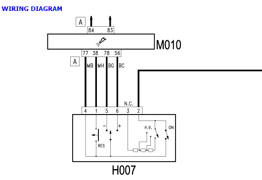

Depends on whether you have the 8 or 16 valve engine, they are ALL different.

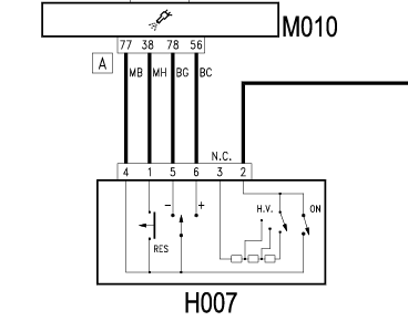

My eLearn shows they are the same for the 16v and the 8v:
here's the 8v: Bravo 1.9 jtd 8v.PNG
and here is the 16v:Bravo 1.9 jtd 16v.PNG

Are you sure you're putting 12v to the stalk on pin 2?
Are you getting 12v out of the stalk on pin 4 going to the ECU; all the way to the ECU pins???
horay finally sorted found the problem the pins I was using didn't connect so bare wires straight in bingo working :)
