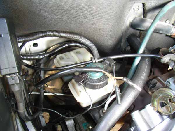

In the second photo there are two wires that go nowhere, see them on the brake reservoir. They were taped up. Where did they go originally.

My guess for the two disconnected wires - I think they should go to the fuel cutoff solenoid at the base of the carburettor. They would come from the control unit hanging off the right suspension strut mounting. No cut-off solenoid? Perhaps somebody has changed the carburettor for one off a 70S, as you suspected. Have you looked in Haynes... in various parts of the manual (Fuel System and Supplement) it lists various carburettor types for the various models. The type number (something like 30DMTE 12/150) is stamped into the carburettor base flange.
