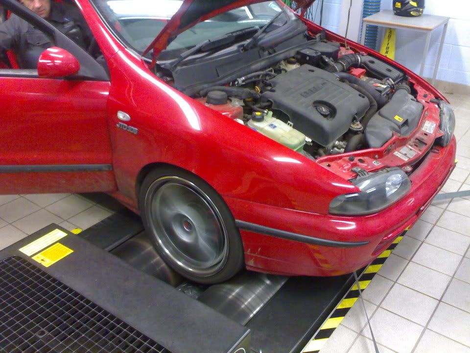

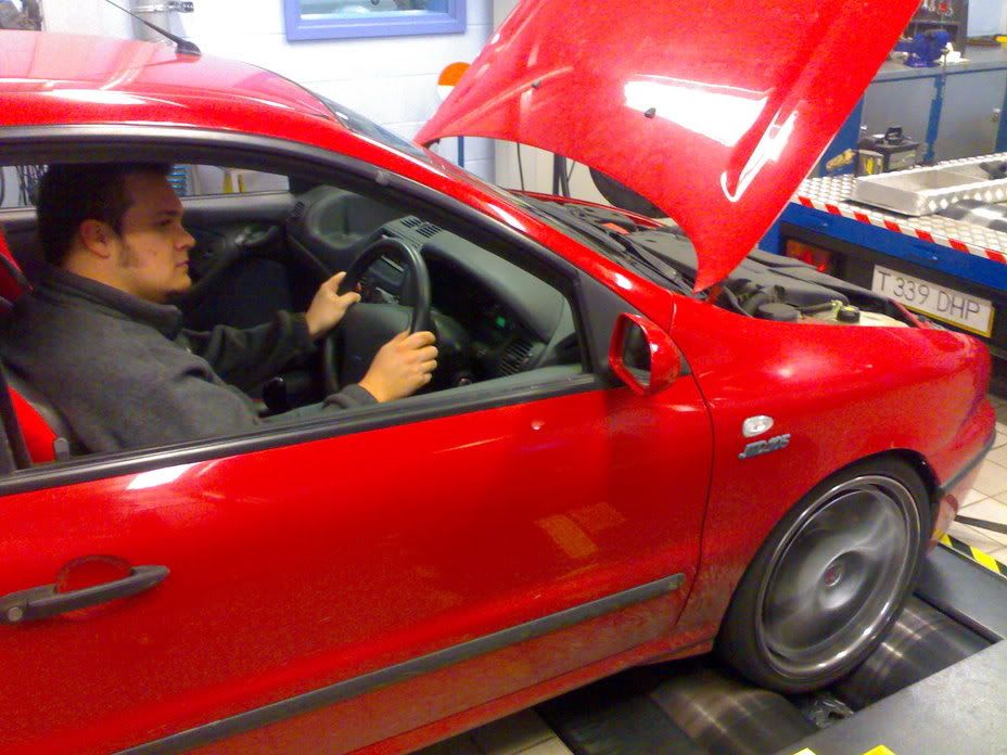

Had a little fun the other day :)
Put my car on the Dyno @ my friends Motorsport Collage.
Was great fun although a little worrying......
The bloke testing was very impressed with the car although the exhaust extractors couldn't remove the thick black smoke quick enough!!!
Ok Wimmy & Andy, I DO belive you now, it does smoke a bit :)
Anyways I was just wondering, if there a few people on here up4 a dyno test, maybe we could book summit as a club to attend a propper Dyno test place........
Just a thought..... anyways.. here's some pics :)

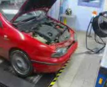

just one thing though, if its been done properly, where are the fans hiding? cant see any in the pics
good idea Tom, theres a place in Peterborough owned by harvey gibbs I think is his name, has a 1000hp 4wd rolling road (not that we'd need that much, and with groups thinking it works out at £20-£25 per person :)

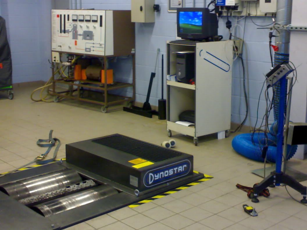

Well the output wasn't quite as much as i hoped BUT the Dyno is only used to demo how it's done for the students.... so it might not be quite accurate.
Saying that, it's having a know car put on it this week, and if it's out they will get it fully calerbrated and I can have another go :)

Dynos are usually very accurate at giving the wheel Torque/BHP figures, the inaccuracy comes in turning that into a flywheel figure. That not down to the dyno itself, thats down to the person running it.

Rolling roads are ****e, always have been, always will be. A calibrated dyno is a totally different matter... but I was very sceptical when Tommy rang me about it.
I am not saying that the RR was ****ed, but something wasnt right!
Well it couldn't make 220nM and 105BHP at the fly.
105 at the wheels isn't too bad but it still doesn't ring true with the 220nm.
Rolling roads are good if the operator knows what they are doing. Anything which takes a power reading after the gearbox is subject to losses.
The only true way is to measure at the flywheel itself, but its a bit costly ripping the engine out.
