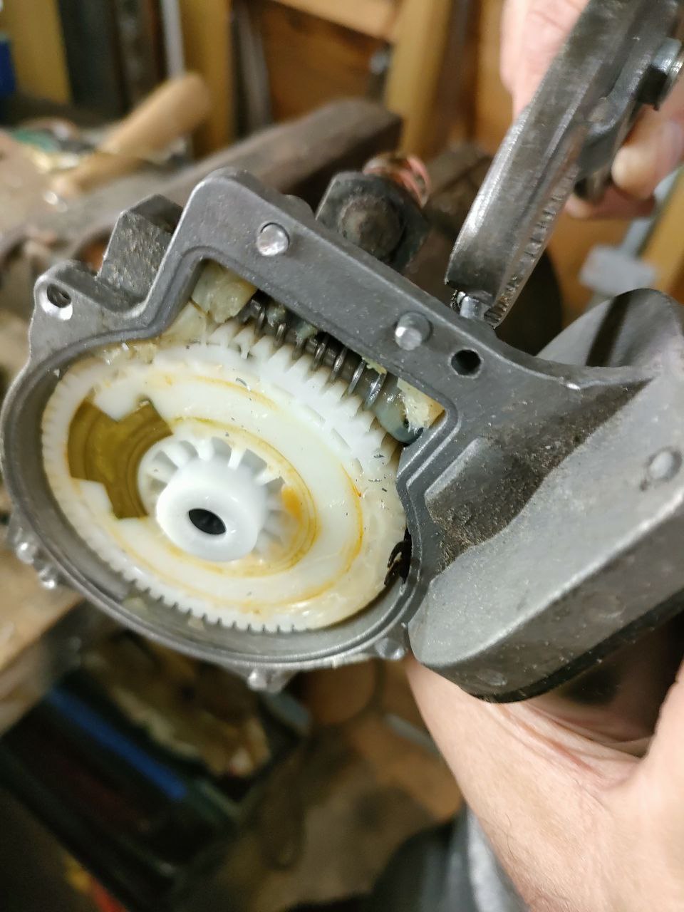

Yes! I got it apart and one side was really corroded. It's all greased up now and moving freely. As we have nothing to do while waiting for the new motor, we took apart the old one and the motor itself is still operational! So, there must be something wrong with the electronics which are impossible to access. The gears and power supply to the motor can be accessed by drilling away the rivets. The relay can still be heard when pushing the wiper arm at the wheel upwards.
On the picture you can see the worm wheel and the gears, with a conductive area telling the unit when the start position is reached (I think). Anyway even if it would work the part can't be trusted anymore so will wait from the part from Amazon which is made by Frankberg. Can't really be picky about the brand because we want to leave asap. There's also a Ridex part for about 25€.

I did a few tests with the old motor, with the motor disconnected I got 12V at the PCB contacts. I then soldered wires between PCB and motor so I could measure voltage, which was 0V with the motor connected, I tried the first experiment again and got 0V now again. So my conclusion is that the relay might have become erratic and the thermal overload is still intact. The motor itself is still turning.
Concerning the wiper assembly I had to hammer out the spindle on driver's side because the bushings (if that is the correct English word) were so corroded. After sanding and greasing the assembly has almost no resistance anymore.
So, did the overload protection fail me and instead the relay/internal circuit got too hot/burnt? Without load the motor draws 9A at 8-9V. My power supply maxes out at 10A so I couldn't test the motor at full power. The resistance of the rotor is 0.4-0.5 ohm, at 12V it would draw then about 24A, of course this would rise if there's a load on the motor such a the corroded wiper assembly. But this static testing doesn't say much because according to the power supply reading, the resistance is (9V/9A = 1 ohm) 1ohm.
The fuse is 30A and didn't blow? I had a case earlier where a high current just unsoldered wiring from a PCB, maybe this happened? Unfortunately I don't have any schematics on the motor itself so the quest stops here as the new motor has arrived.
