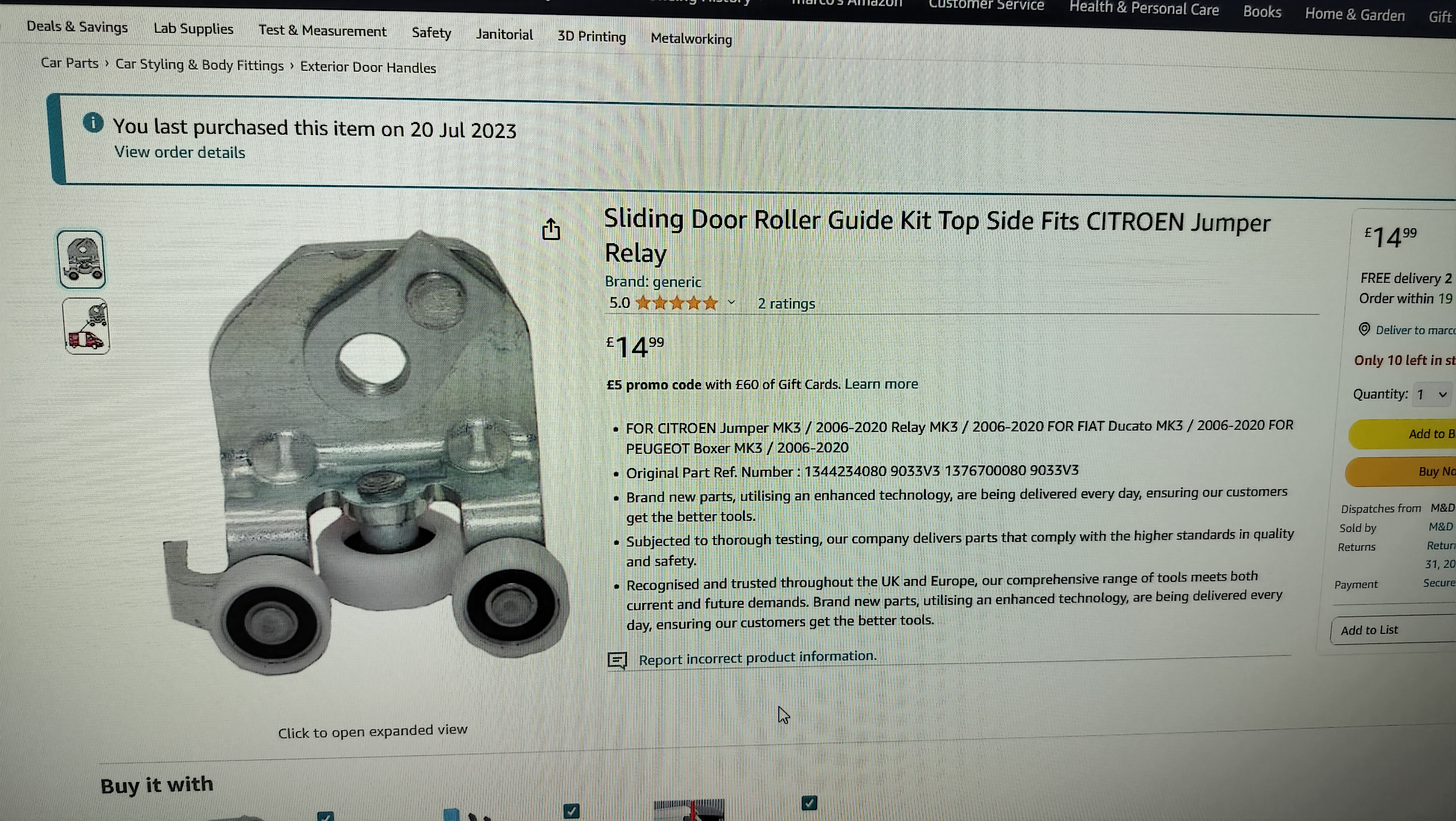

Hi, bought this roller assembly for the top of the sliding door only to find it needs rivetted to the door bracket.
The steel post at the top of the assembly (see photo) has to be formed into a flat rivet head - but I, and the seller, have no idea how!!
Anyone ever done this job? (without destroying the part!) - or have the workshop manual instructions?

Just done mine for about £16 but never had that flat bit on mine the top picture is same as i got delivered..took a few mins to swap over ...mine had a 17mm nyloc nut so just undid it i marked the bracket on door took it all off blocked up sliding door.cleaned all the runners smooth as silk now.
Oh. That's interesting! Perhaps I can just remove the new post part and attach the rollers to the old post using the nylon nut???

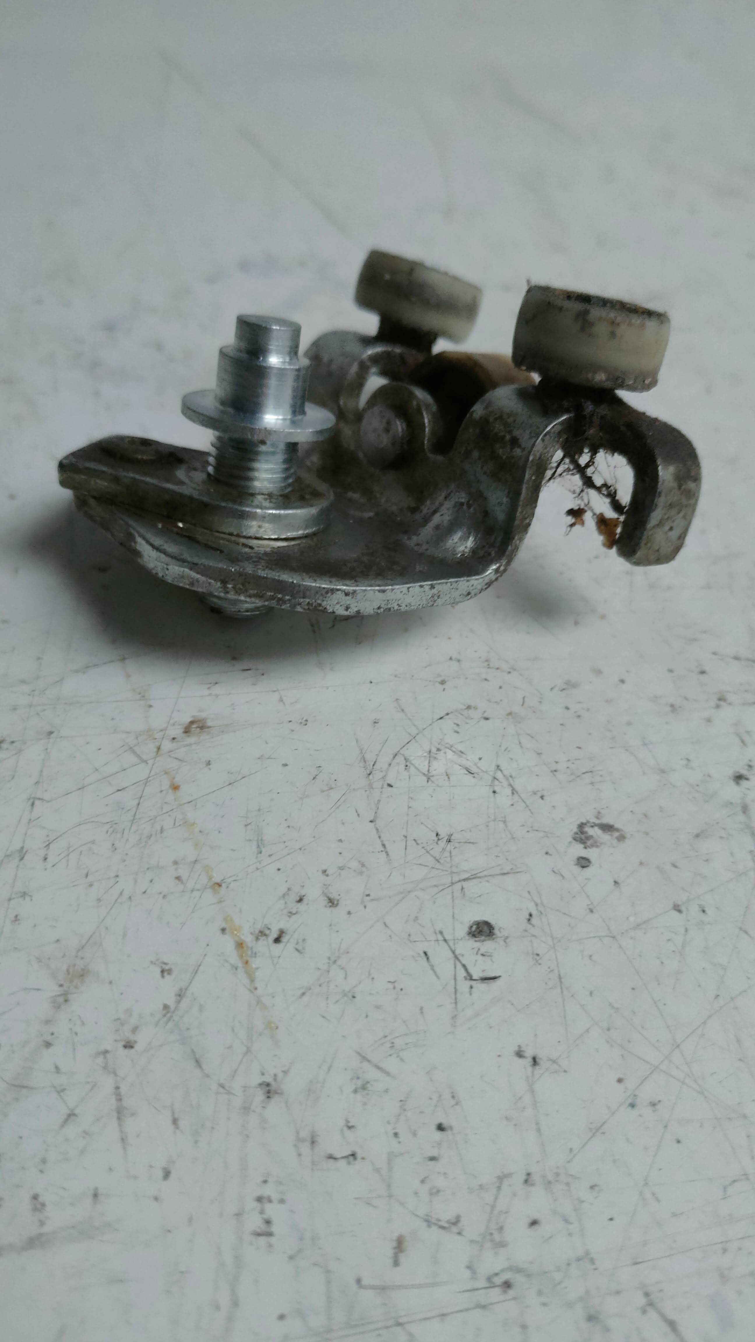

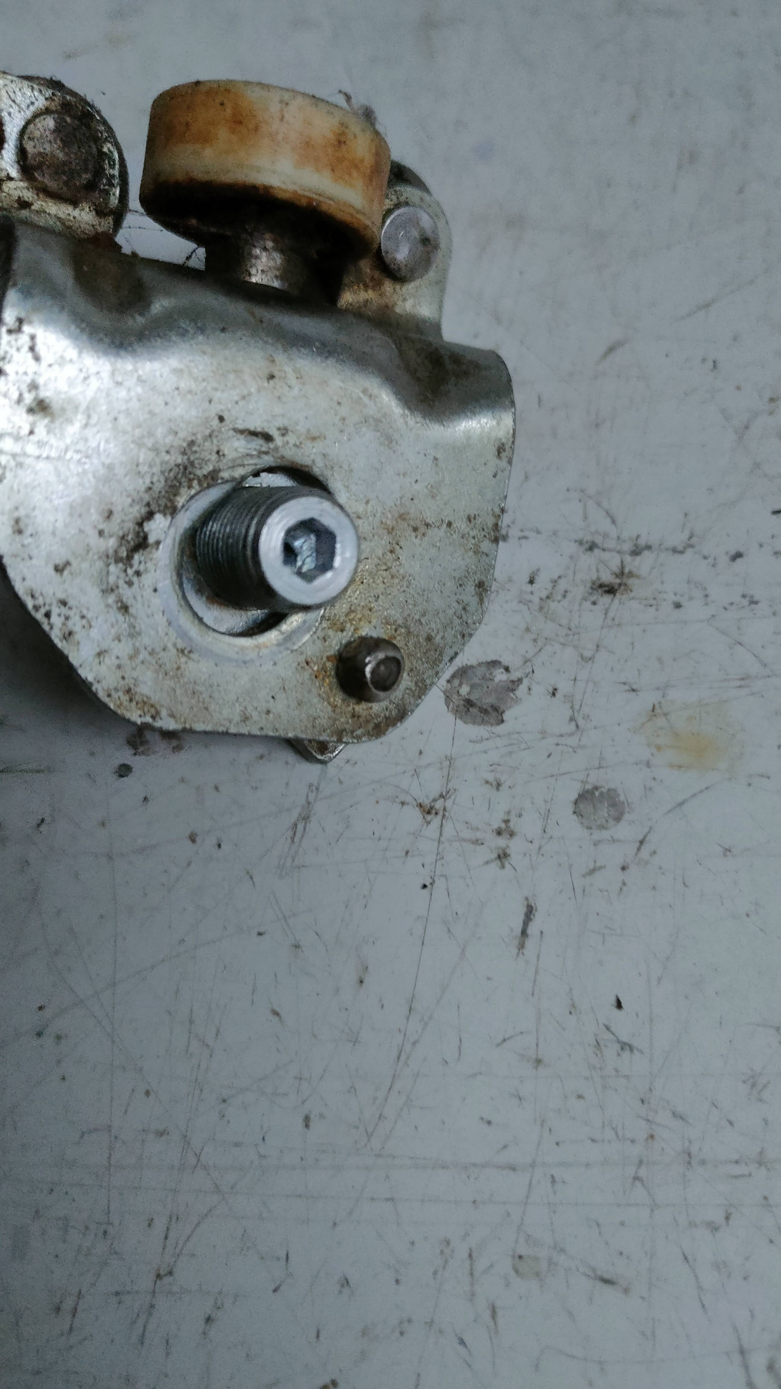

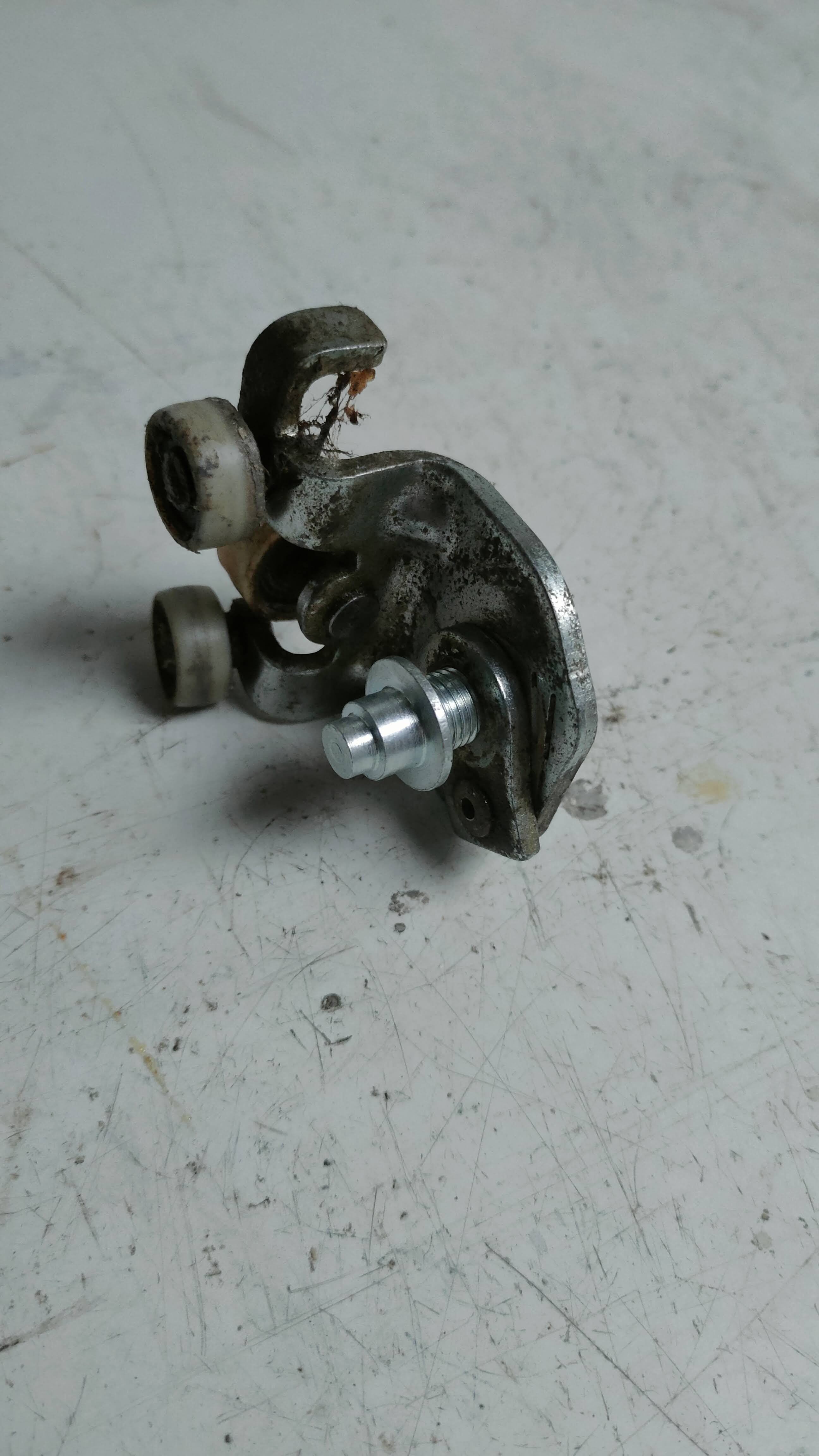

Hi does this help the threaded part helps adjust the height...
Thanks. Yep, that's exactly how mine looks.
But I'm confused again now
So what did you do with that upright post part? Did you you form it into a rivet head?
And why does it look new when the roller part looks old?
ohh i see what your saying i undid that new threaded bit and used the old arm part as you see in door pic i just kept old rollers and new threaded pin part ..not sure what else to say i done a few months ago now i got the one in your pic didnt come with arm part ..i got this one from amazon..hope this helps.
