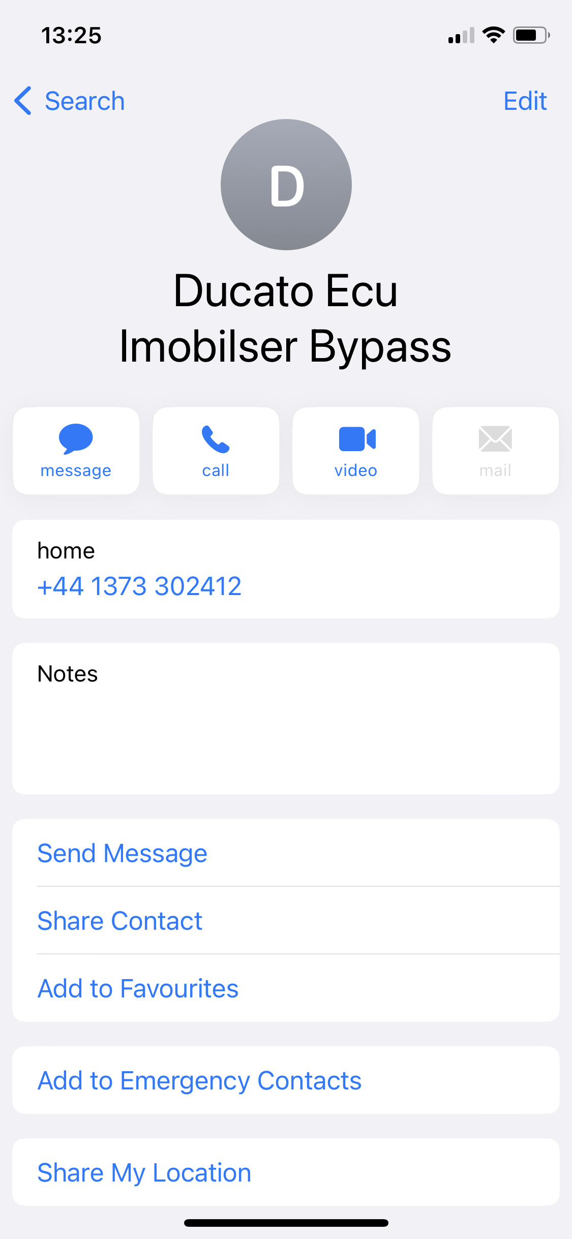

Where can I find the company that disabled the immobiliser at the ECU for £137

It was a diagnostic/tuning company in Bradford several years ago and when I tried to get them to do the same on another vehicle they said the guy who did it no longer works for them.
It was a Bosch MS 6.3 ECU I think and when I tried a local firm they said they couldn't do it, I suspect it is a skill many ecu tuner/writers can do if willing.
