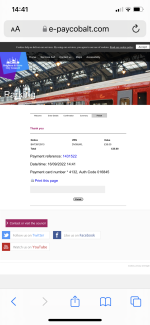

The engine looks to me to be running very rough, but also leaking oil, which also appears to be burning off the engine. Hard to tell to much from the short vid, and the other vid, and picture didn’t help at all, as I’m not sure they are associated with topic.
