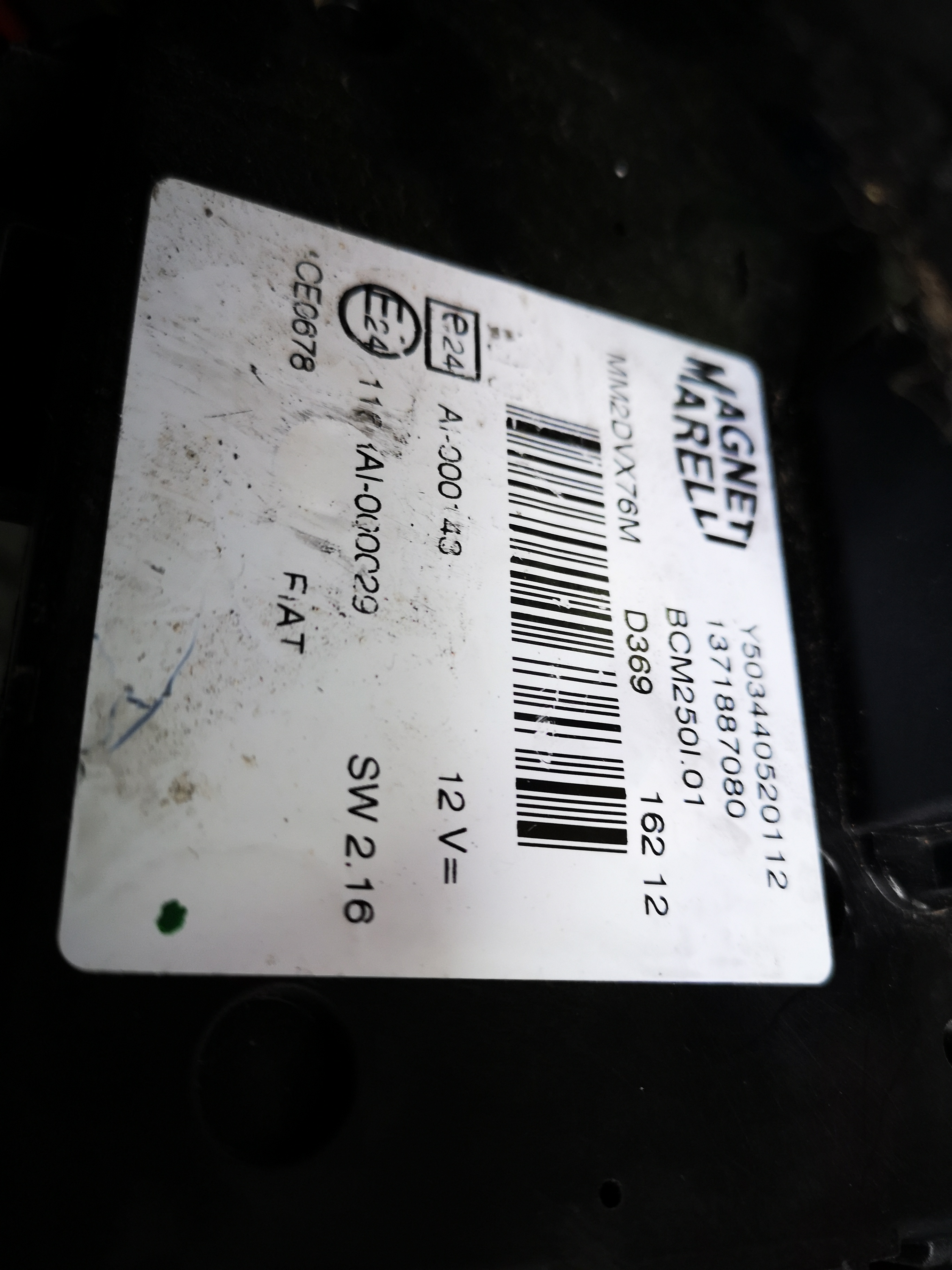

Have slightly different pinout on my bcm
Elearn state for an 52 pins on connector A while on this bcm connector a has 60 pins
Have traced 3 pins on bcm that are ok,1are missing
So please if someone has right pinout for this bcm:
