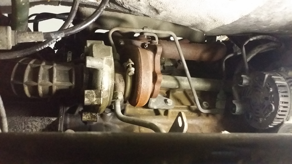

For those with interest of the aftermath...
As previous explained, i had a failure in the wastegate actuator link... Leading me to believe i had to remove the entire turbo from the car in order to fix it properly.
As adviced in an earlier reply, i took on the job expecting a very difficult job due to the turpo's placement behind the engine, and the fact that i was going to dismantle the turbo from the manifold with expected rusty and stuck nuts.
i removed the front exhaust pipe to make eaiser access to the turbo, and then removed the inlet tube and wastegate actuator from above through theengine compartment.
I then proceeded to remove the exhaust outlet bend to gain access to one more of the turbo-manifold-nuts.
This gave me as good access as could be exptected:
Due to the better access and visibility, i could confirm that the little bolt on the wastegate arm was in fact NOT welded on as earlier assumed, but riveted on.
This in turn made me realize that i might not have to remove the entire turbo...
With a dremel and a small grinding-ball i managed to grind of the remains of the little bolt, and then with a modified plier i managed to press out the remaininglower part of the bolt:
(The bolt at the left in the picture, i planned to use a small commercial ball-link to replace the link, but wasn't able to use it...)
With access to the arm and the old part removed, it looked like this:
Then i looked throughan old nuts'n-bolt-box i had plus purchased some 4mm hex bolts and some nuts and washers to replace the broken bolt.
Put together:
After remounting the wastegate actuator and checking the operation with a air-pump, it was just a matter of remounting the rest of the parts before testdriving.
The car now has a healthy 1,2 bar relative pressure (2,2 absolute) at peak,
And runs like never before!:D
Put together:
