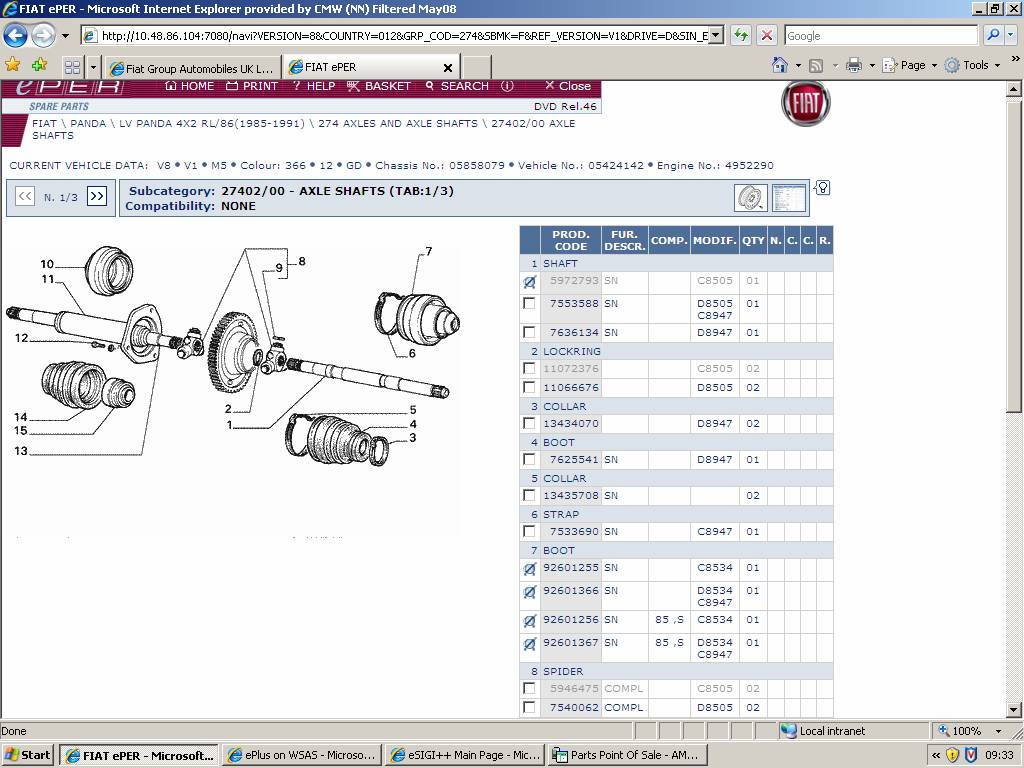

Fiat no longer stock the driveshaft boots?! As in the gaiters that stop oil coming out the gearbox??
If so this is a serious problem for Panda fans as those boots are a regular consumable item and I don't know of any alternatives... :(
This is the picture from Fiat Dealer that I was sent.
I will post a couple pics of my cv boots tonight. :)
