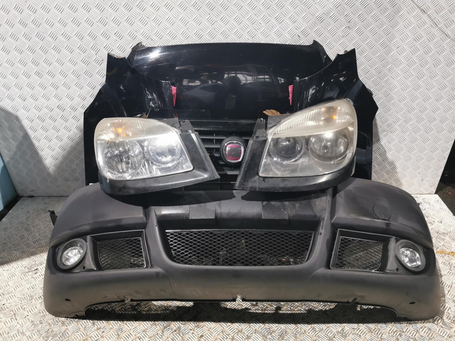

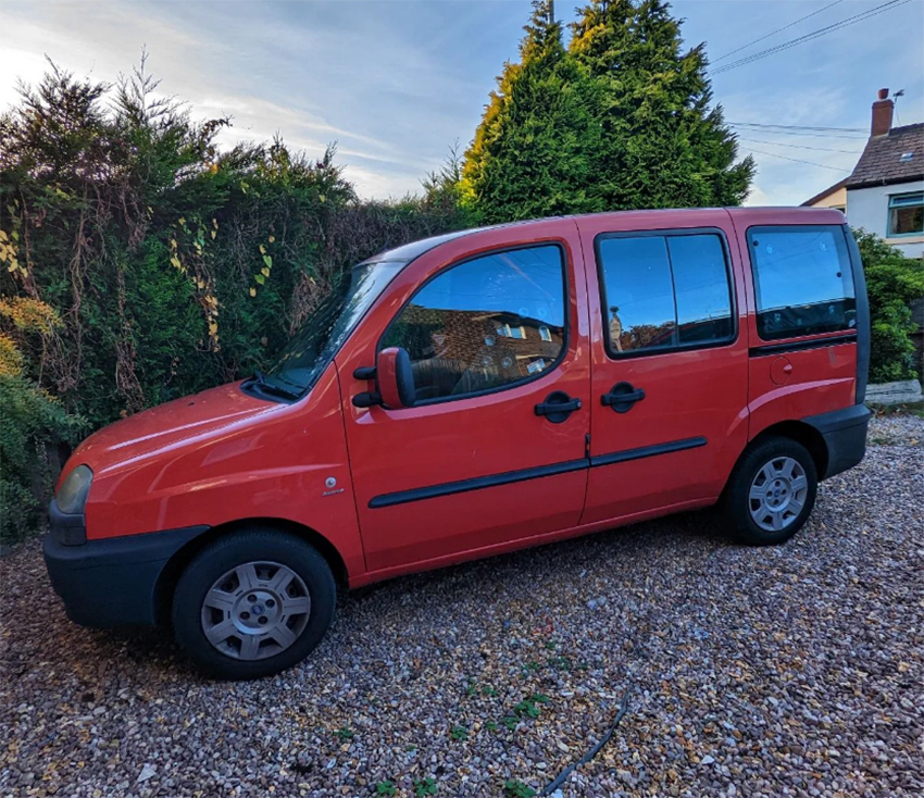

I need some help. I have a Doblo Mk1 with only 65k on the clock, I love it but I don't love the front end (she's a bit ugly). I have seen that someone on here has done MK2 front end swap so I bit the bullet and bought a complete front end.

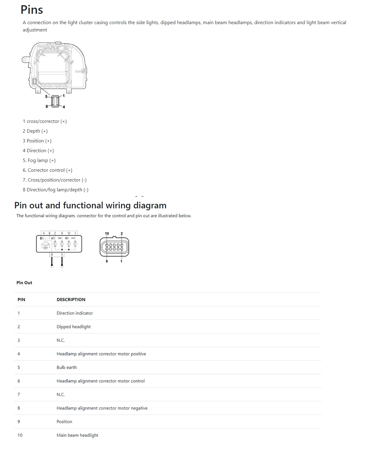

I came to test fit the headlights last night and found that the main headlight plugs are different. The MK1 has a 8 pin plug and the MK2 headlights have a 10 pin plug! How can i get them to work? I have found a pin out for the plugs but I don't really understand it.
If anyone can help with this?
