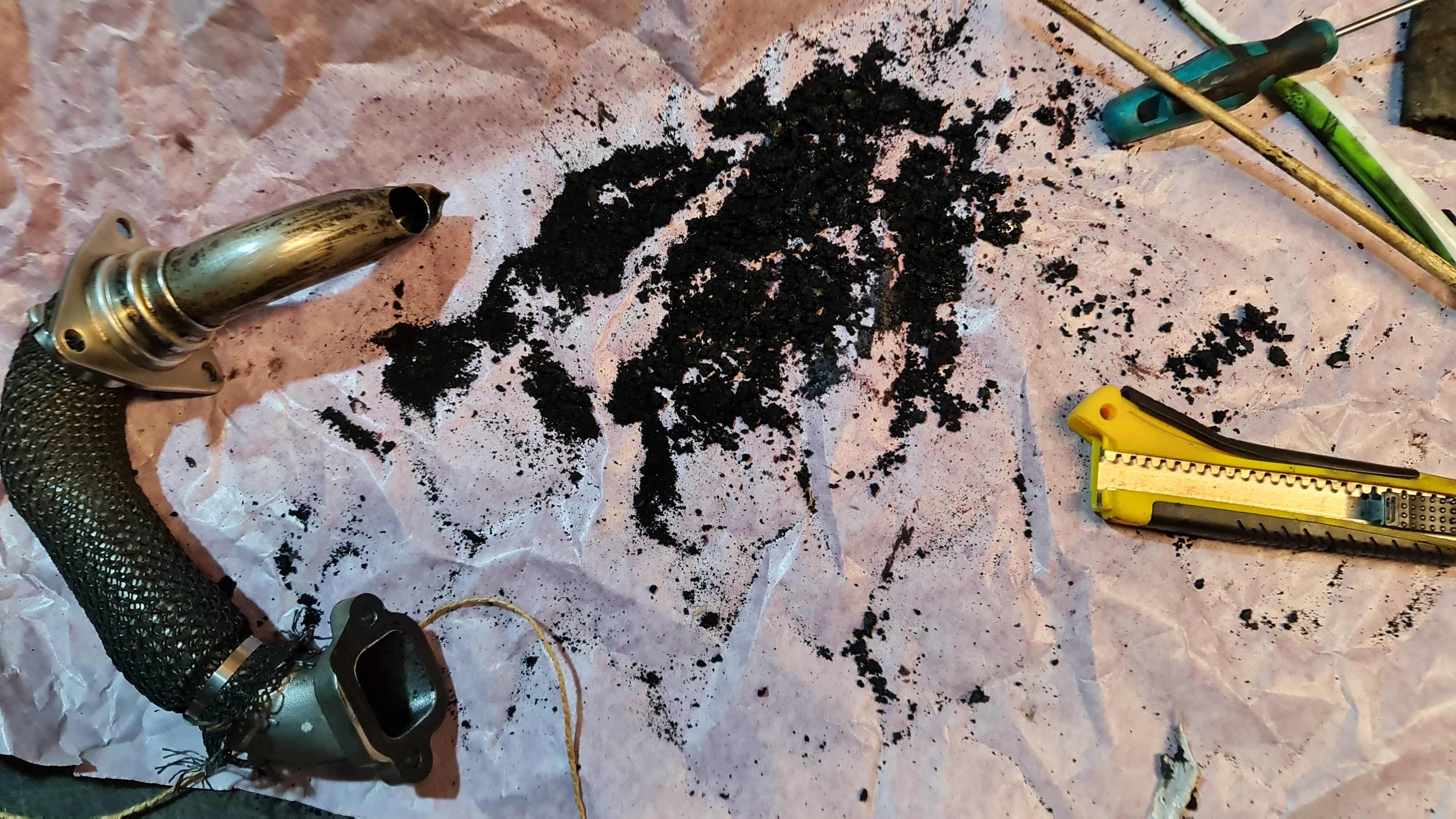

I umounted the tube and I cleaned, see attached picture with lot of dirty. I thought maybe that was the problem now, but not, the p0487 was still there
When checking the valve with alfaobd message I got is "blocked valve". I don't know if is blocked as open or as closed.
The engine is working well as usual, I can't see any difference.

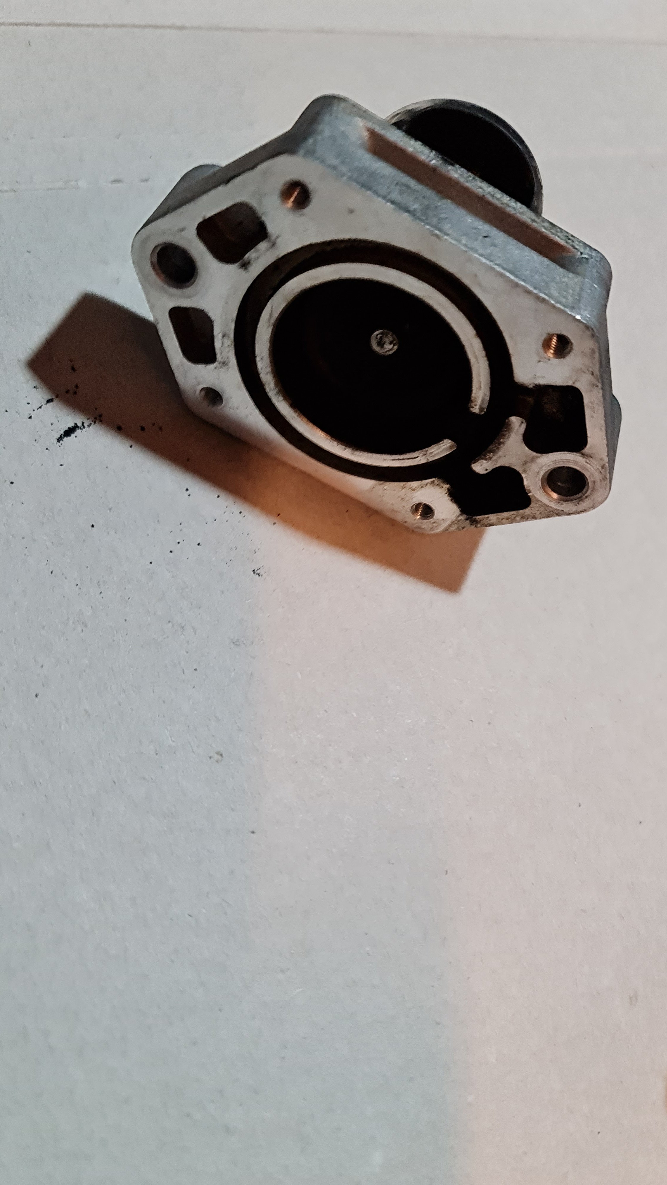

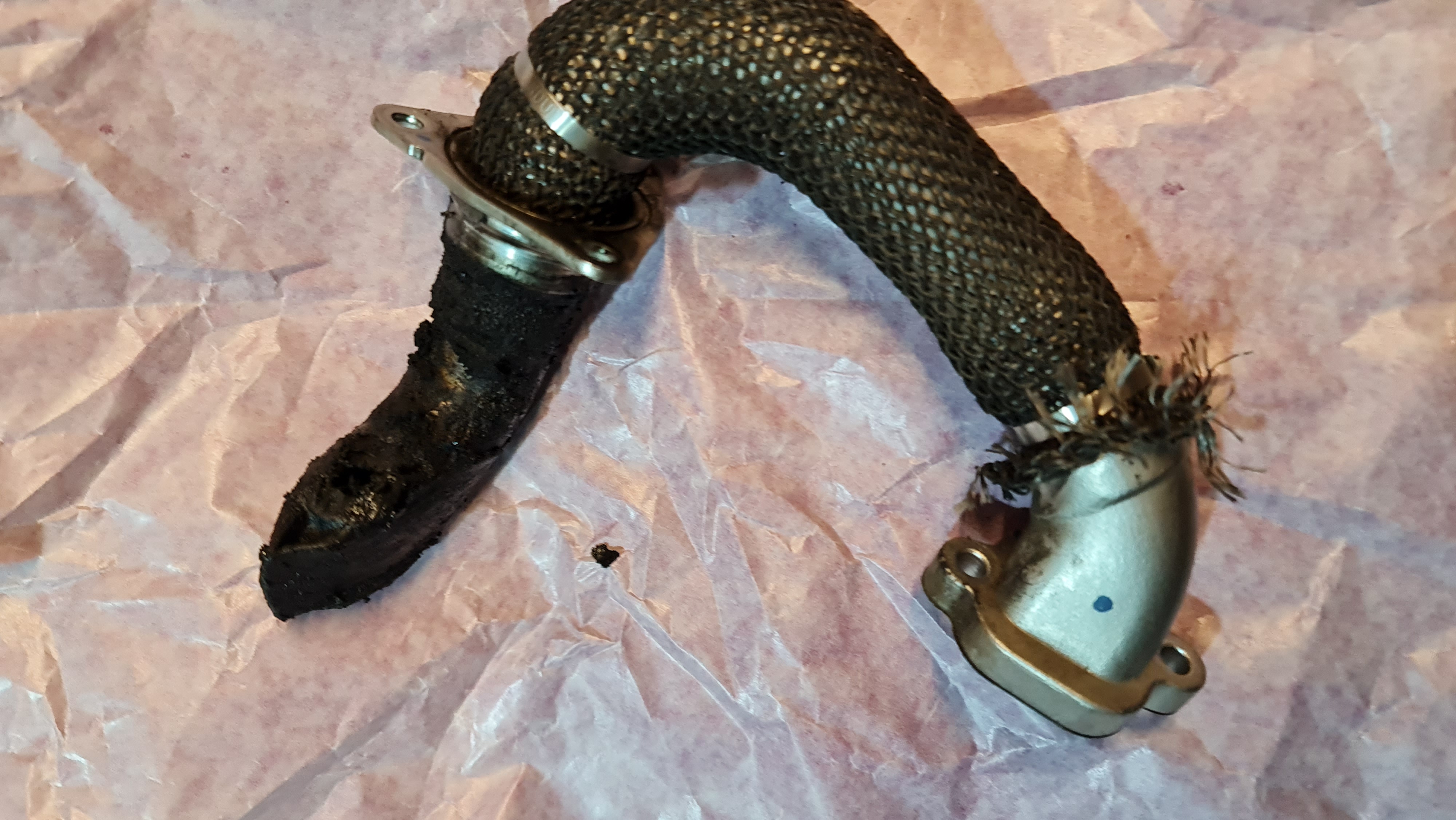

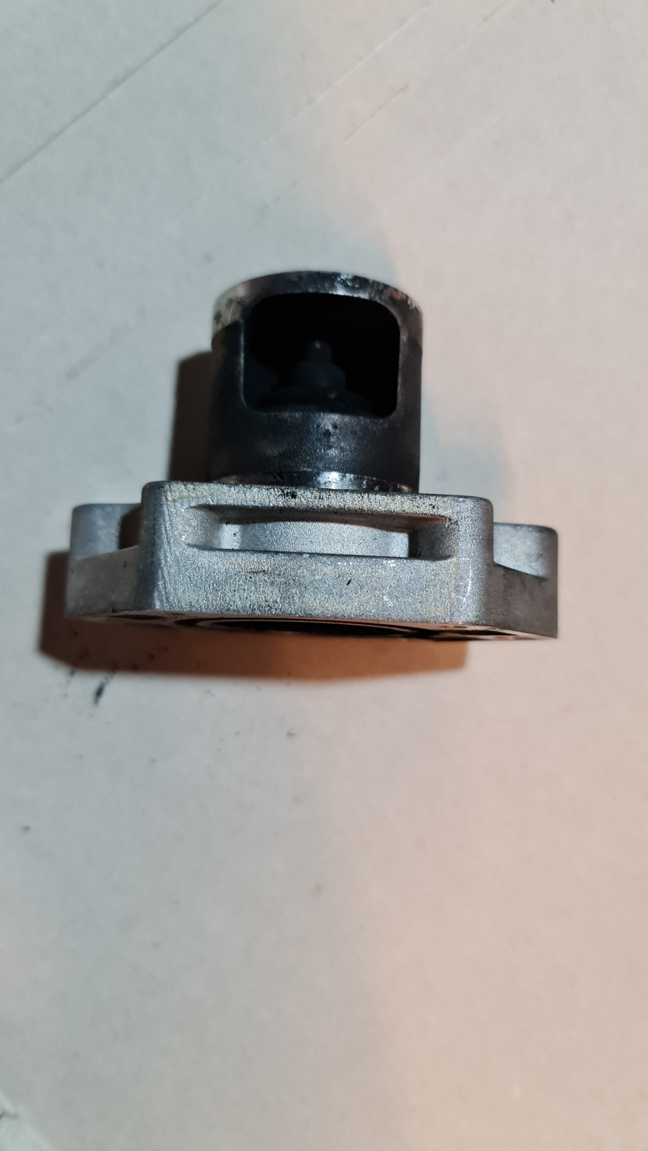

I took off the egr, see attached pictures, it looked blocked. So I mounted the original and old one, I cleaned it time ago.
Of course I disconected the battery before. I took alfaobd and clicked on "egr valve replacement".
I drove some meters and check engine light with P0488. I deleted p0488 and drove again and failsafe mode!!!
I turned off and turned on again and same problem p0488 and a new failsafe.
Turned off and click again on "egr valve replacement" on alfaobd. I drove for 6km on everything looks ok. Checked again alfaobd and not errors were detected.
