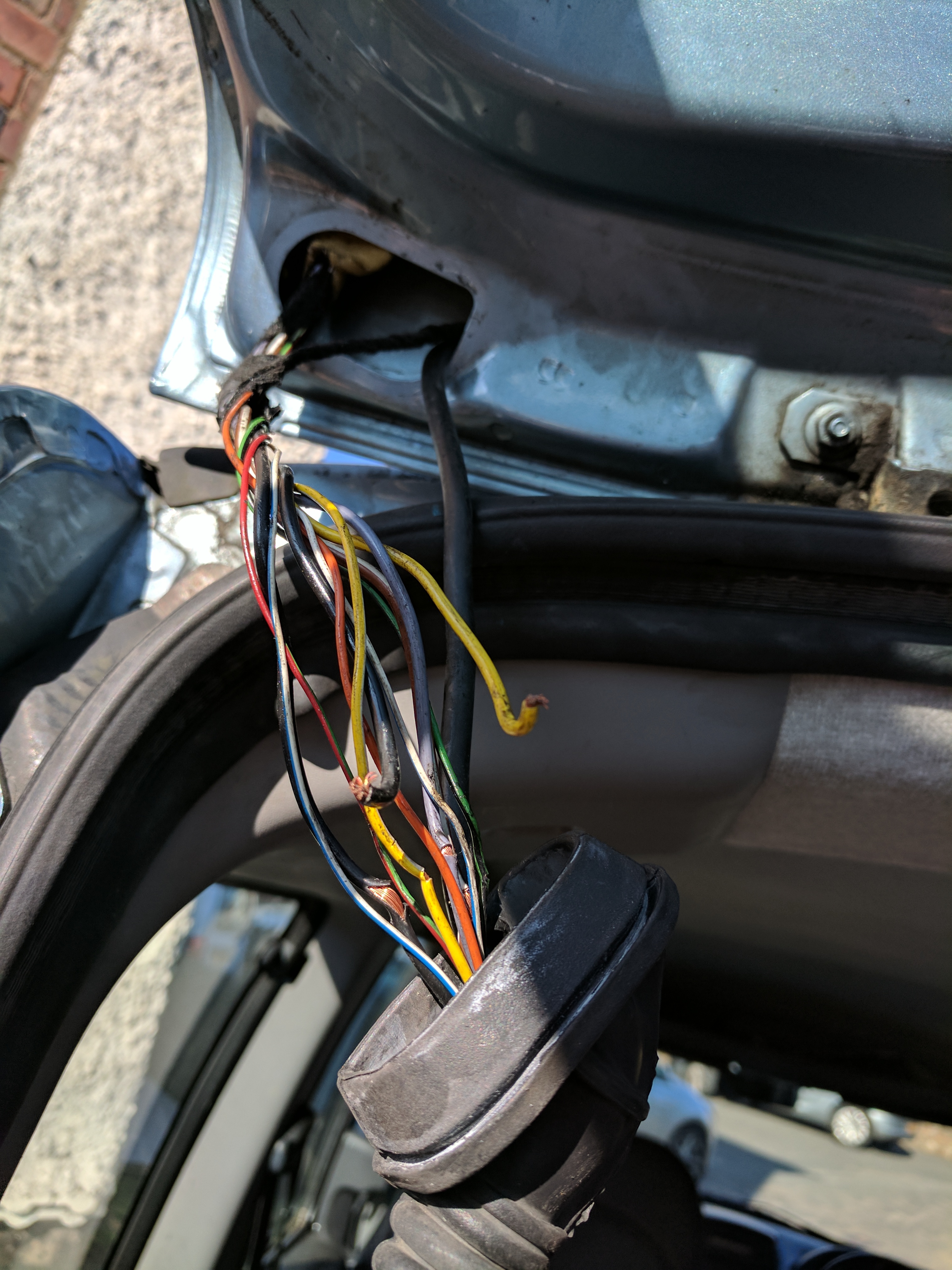

I had similar problems. On mine it was the cables between the tailgate and the body which are at the top lefthand corner of the tailgate. When I cut back the outer covering I found that some of the wires inside had broken and shorted against others. Caused by bending every time the tailgate is opened or closed. Hope this helps.
I owe you a beer.
I disconnected all the services in the boot and pulled out enough wiring to slide the boot above the area affected and soldered all the wires (added two layer of heat shrink for good measure). Everything works!
The condition of the wires was quite shocking, I've attached a picture.
Many many thanks!
