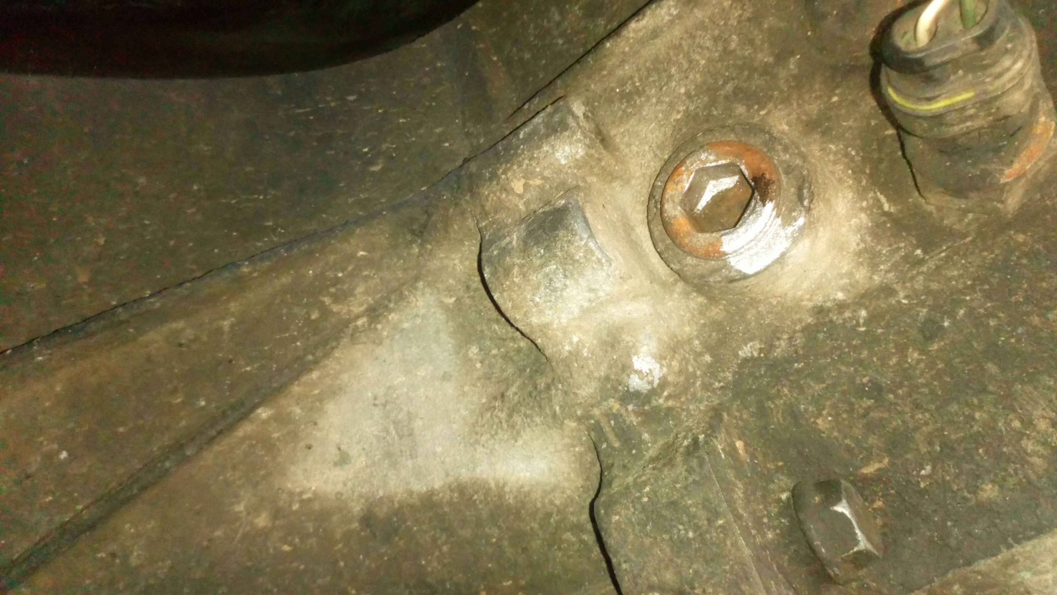

Does anyone know where the fill and drain plugs are on the manual gearbox as I supposedly had the gear oil replaced by a garage but see no signs of any oil dribbles or wet plugs etc. There are a few sunken hexagonal plugs on the box but all dry and rusted. I will try and post images - gear oil they used (if they did do it) was 75w/80 GL4 GL4+ and was charged for 2 litres
If anyone has pics of the plugs location that would be great.

My old 55plate 1.9 JTD one the allen key level plug could easily be reached by laying down n/s/f of car gearbox plug about halfway down casing.
Volume amount and spec. is correct according to my Autodata Manual
Garage pointed out the plugs and they have not been disturbed so no oil change. Had a warning message today about changing engine oil and flashing oil can symbol but that WAS done! - guess other garage failed to reset the counter - not sure if I can do it or not?
Images of the plugs marked by garage - do they look like the right ones and undisturbed?
