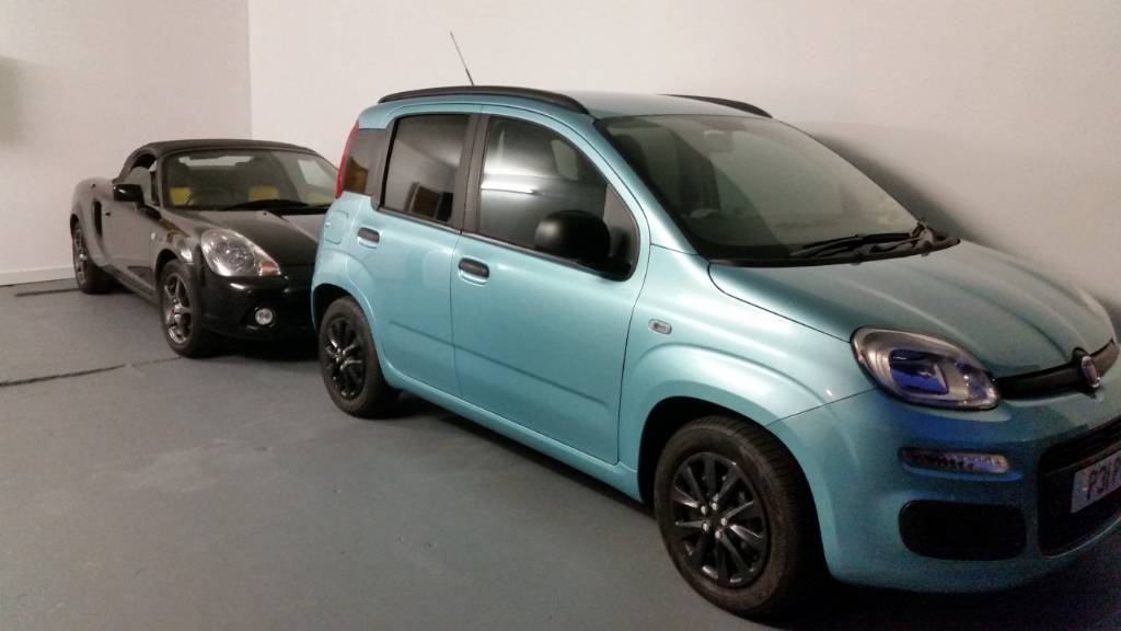

Hi I own a 2014 1.2, easy average in past 4 years 50mpg, had one engine light come on in last 27000 miles, new air filter cured it. Ok for motorways will go at 70 all day but not really what it's built for and wouldn't want to do on a regular basis. Look out for rusty sumps and get it painted also back axles are prone to rust later in life, I've done both mine to extend its life as I was intending on long term keeping it, but may be selling soon if I can find a nice 500 abarth or 1.2s as the Mrs wants one. Mines 2014 27000 miles nothing has broken and only once it didn't start and that was battery, but 4 months of 1 mile to and from work on a 4 year old battery killed it. Would I buy another, yes without hesitation. 20171002_190023.jpeg
