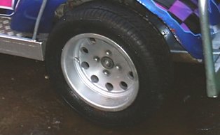

Who likes these for 13" deep dish!!
Pity, that they are 101.6mm [4"] for Mini fitment
They can be bought from, and are ok for a road car - www.rebelsracing.com , £95 each
