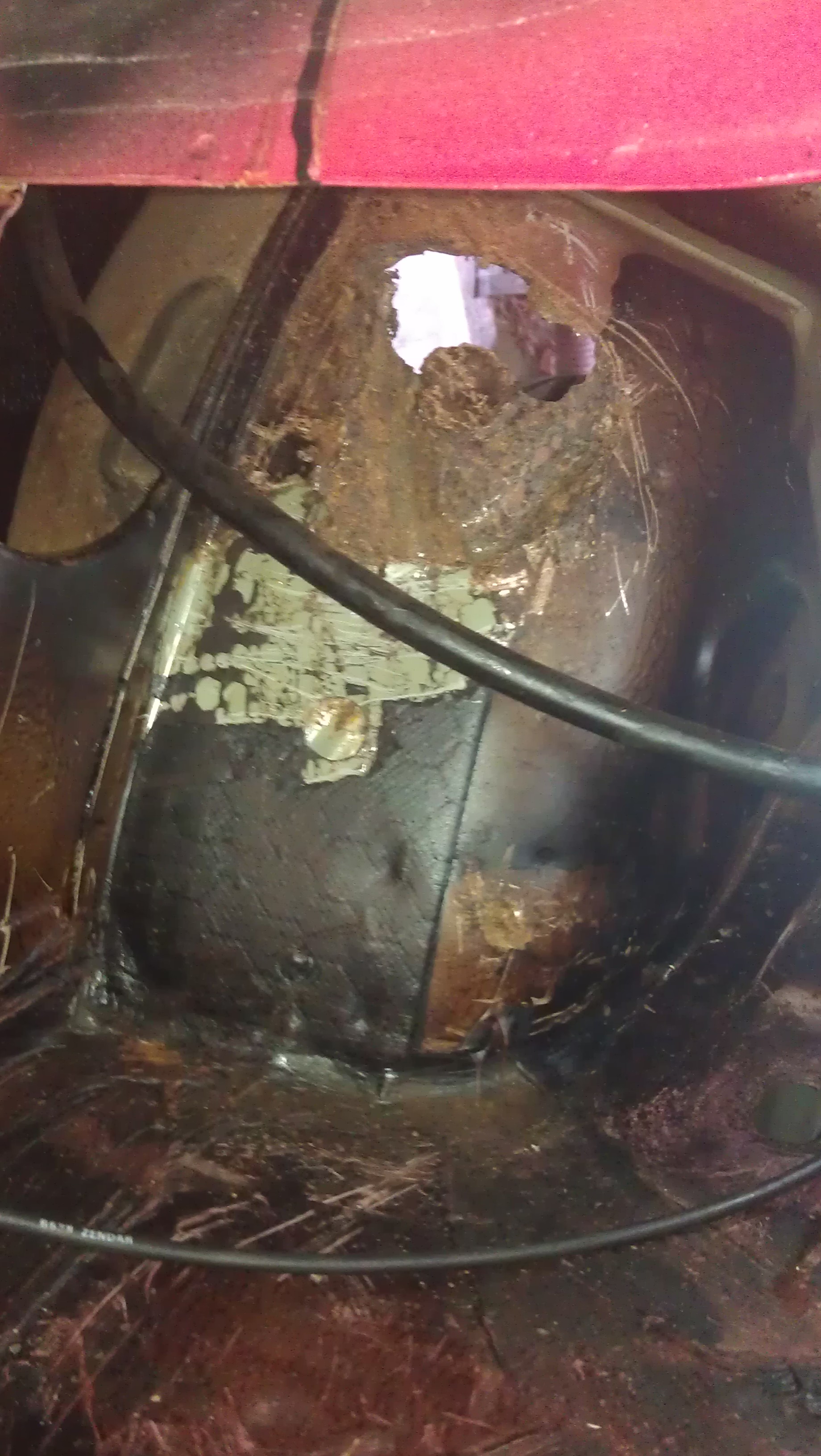

Removed the petrol tank, to find the leak but also to check the rear arches.
Bad news rust is very evident, thought it was a small amount but the screwdriver revealed more. Main reason for this I think is that the filler pipe has a foam sleave wrapped around it, this was quite damp, so somehow water was getting onto this foam.the foam sits on the inner arch.

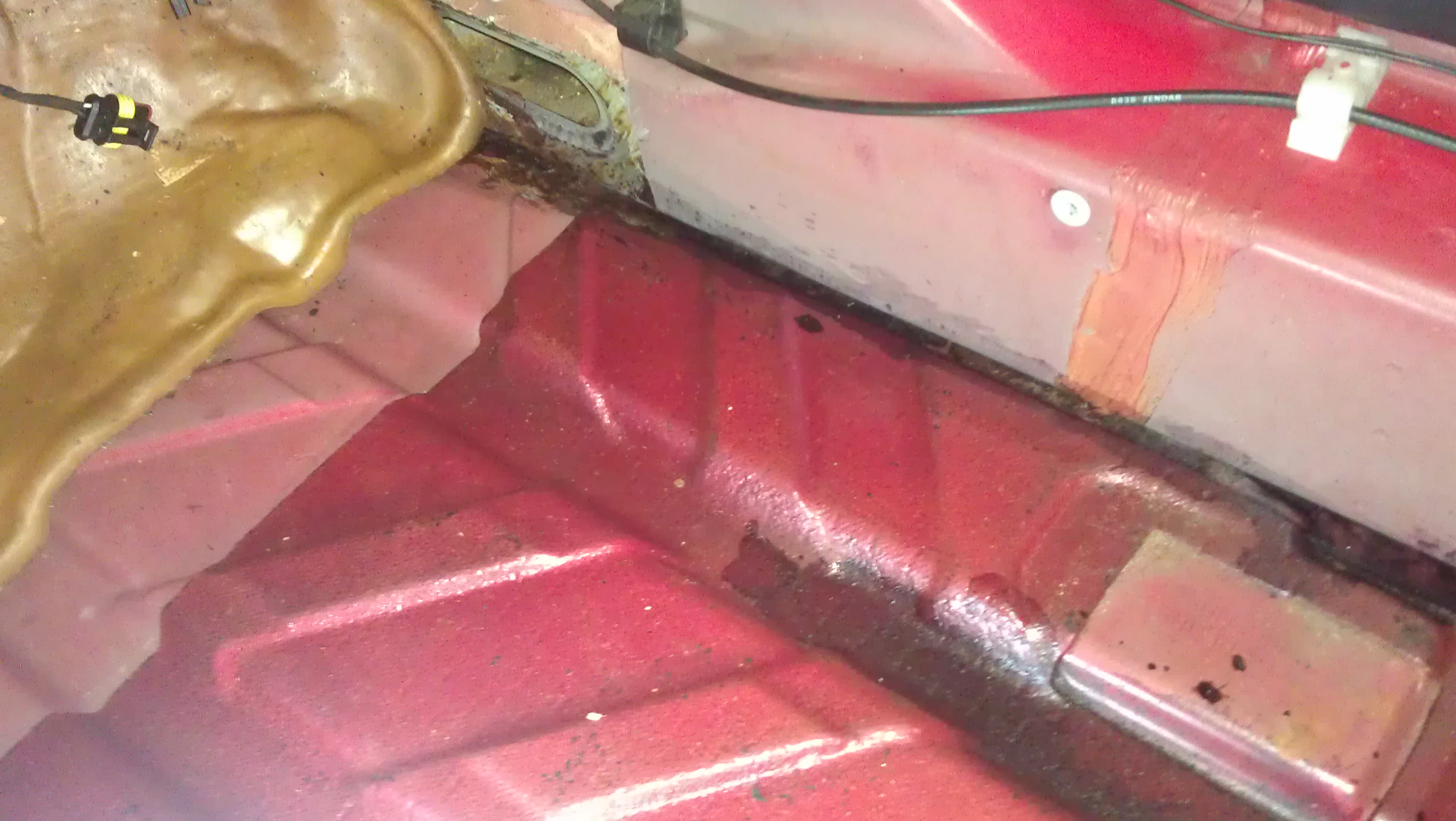

Is that daylight I can see? Ouch! Still, at least the floor pan looks OK.
I'm now frightened to investigate mine too closely...
Unfortunately yes it is daylight, a bit of a shock but I was looking for the rust bug, at least it is easy to get to in order to repair. Regarding the floor pan, I was dreading the removal of the matting but thankfully nothing too bad, just preventative work.
